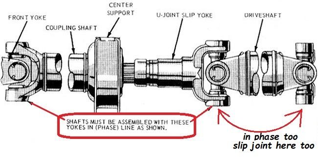

I've never replaced U-joint bolts that hold straps, they aren't to be but so tight, you don't want to egg the bearing cup. The ones that use a U-bolt, likewise do not get super tight, for same reason ... but those nuts are all steel lock type nuts so a person doesn't have to over tighten them to know they'll stay tight ... those I have replaced if no longer gripping the threads. Phasing means each pair of U-joints sit back to back like in the pic below. It shows a slip joint at the carrier or center support, but my '77 has the slip joint in the rear drive shaft between those yokes ... not at the center support.
U-joints between two shafts do mean each one turns 1 full revolution every time the other one does, but the drive side may turn steady speed, but the driven side speeds up and slows down twice each revolution .. phasing cancels out the oscillations if the angles are the same. The steeper the angle, the greater the oscillation is.
