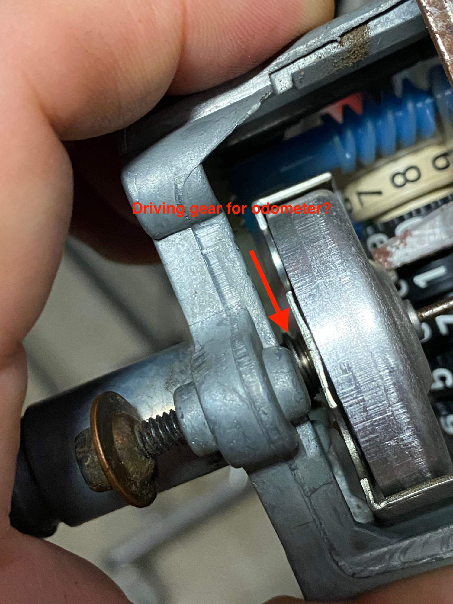

Some of you may have seen my previous post about my speedo being toast. While I am awaiting a replacement, I took the original out to try and figure out what preparation I should do with the replacement before slapping it in; I really do not want to go through it even again after it goes in, hah!

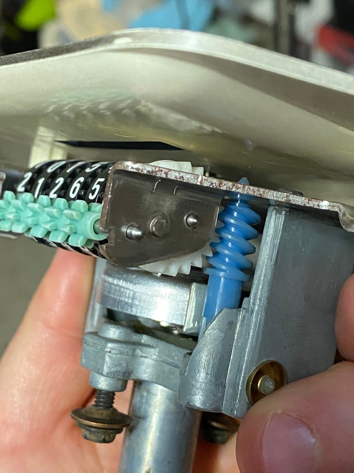

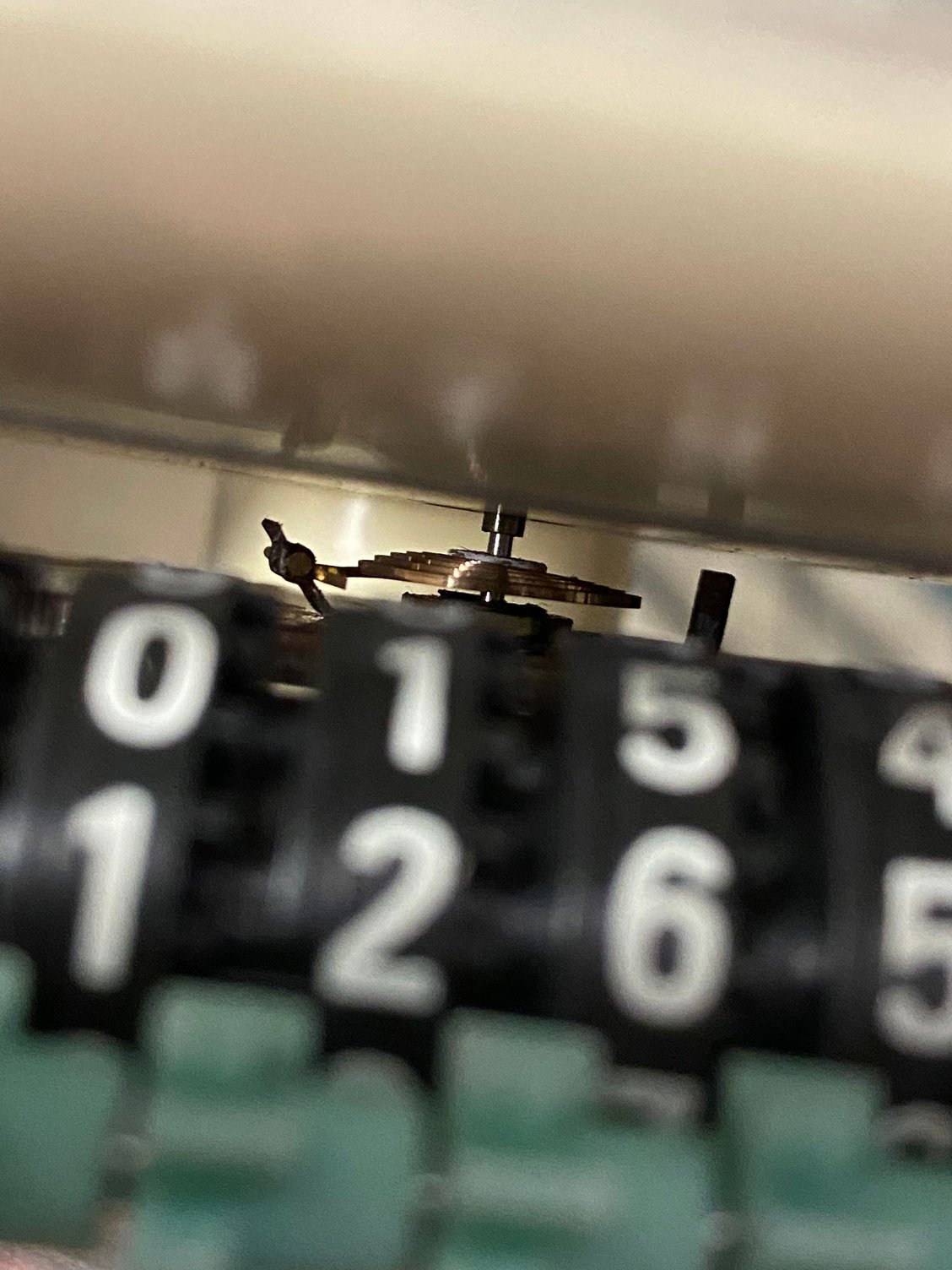

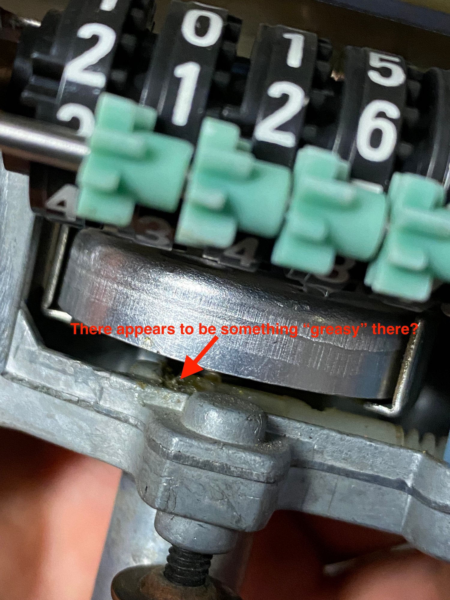

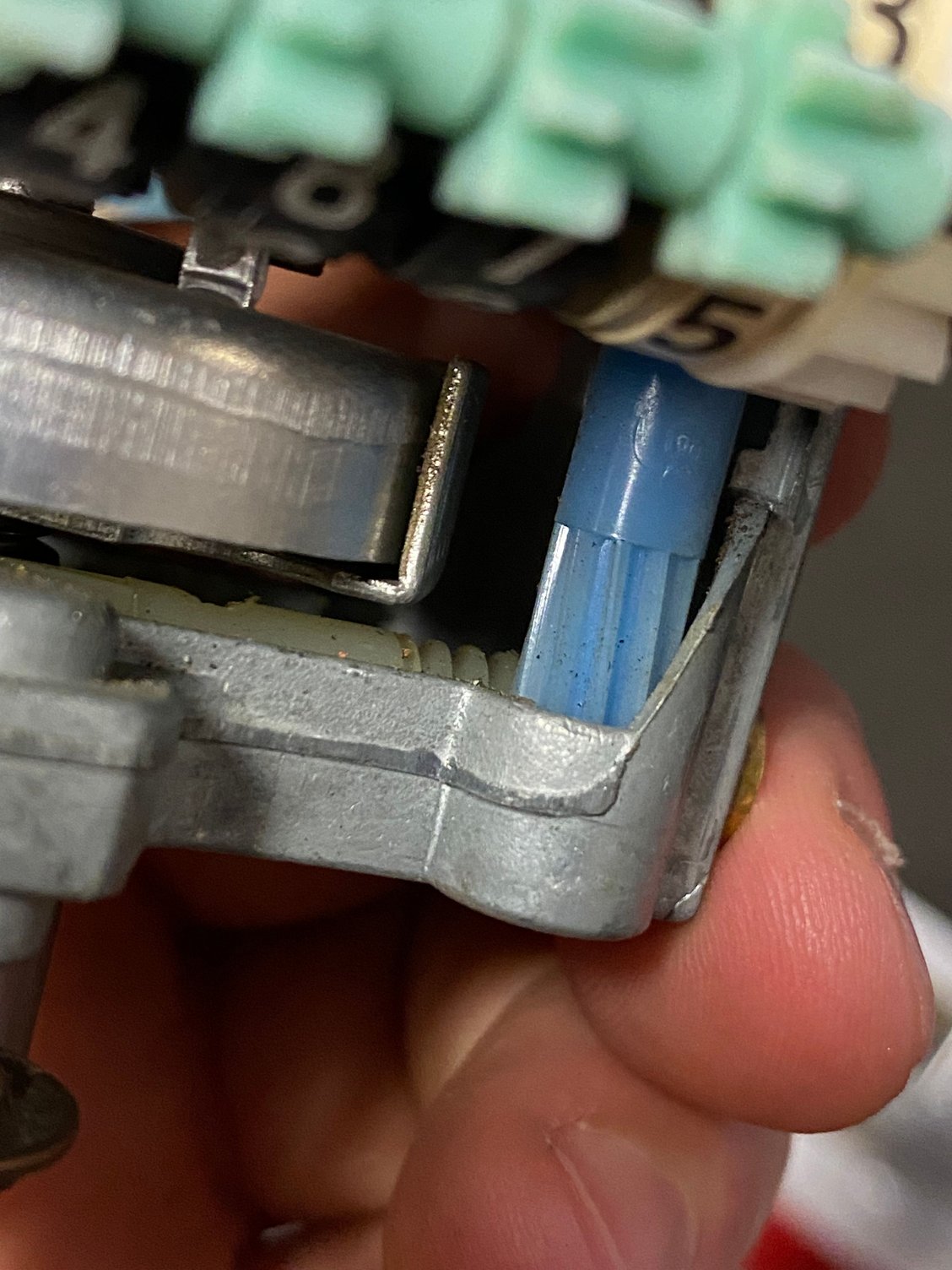

From the looks of it, there's not much to lube... the speedo cable spins a center mass (I guess that's the magnet) that then moves the needle to the proper position. I can't really see any visible bearing or gears so I assume it's just a direct connection type of a thing. The odometer has a few plastic gears and I can only see one spot with what could potentially be grease/lube? In any case - please see pix. I guess the three questions I have are:
* What lubricant to use? Lithium grease? Or maybe gun slider grease?
* Should I put anything into the cable socket on the speedo?
* Anything to lube for odometer gearing or the speedo needle?
