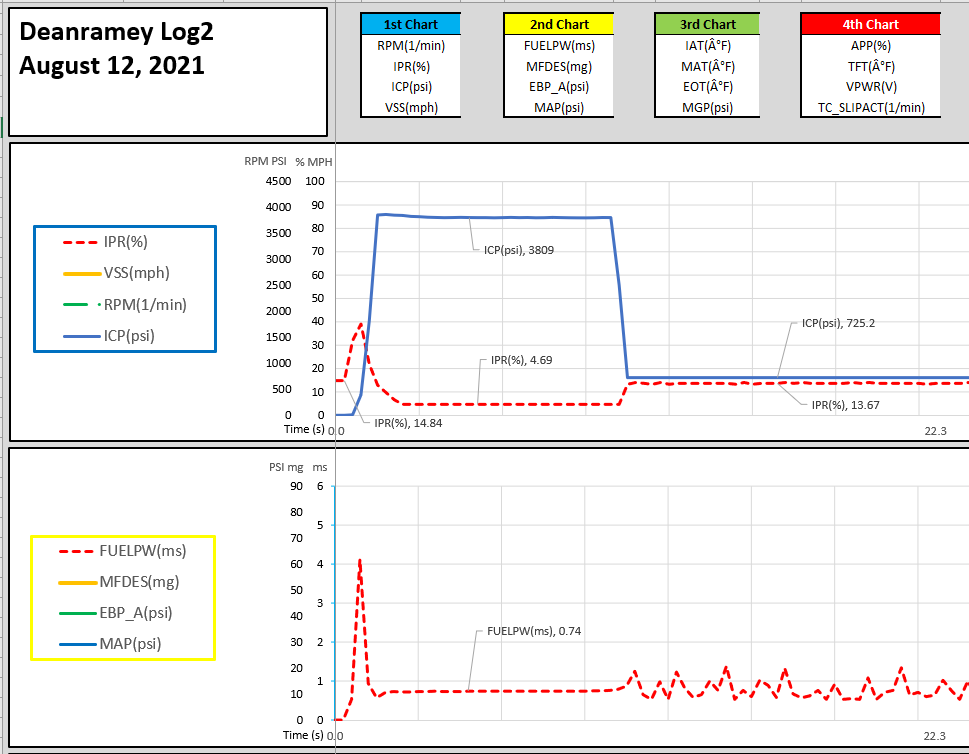

well I got a bluetooth ELM adapter and checked out FSL. As it turns out, PERDELS are not available for me on FSL either. I have attached a couple log graphs that I hope someone can look at and be able to tell me what the heck is going on and what my next approach should be. Like I said in the beginning, I'm at my wits end.

Very curious. Your ICP starts normal at 0psi, IPR% at 14.84, then after startup, ICP rockets to over 3800psi. PCM kicks out P1282 excessive ICP, and commands IPR% low at 4.69, and FUEWPW 0.75ms. Not sure what is normal PW for 238/100s at idle though. Certainly the ICP is not right.
About 10 seconds after start, ICP defaults to 725psi which says the PCM is ignoring the ICP sensor.
Was the engine idling for this log?
Can you unplug the ICP sensor and take another idle log for 30 seconds, to compare with these? Let's see how it runs with the ICP ignored by the PCM the whole time.

Hi Jeff and thanks for taking a look at this. Yes I will definitely take another 30 second scan this evening. Yes the truck was at idlefor this scan. I may have even started the truck while the scan was running which I think would explain the 0 ICP at the start of the scan. As for what is normal for 238/100 injectors, the scans I posted were only on the PCM. The Hydra was disconnected. Should I connect the hydra for the next scan?

After taking a log with the ICP disconnected, agree it might be good to get logs with the Hydra connected, both with and without the ICP sensor plugged in.
Can you add all of the PIDs listed in the chart above for the next logs? That additional data could be helpful.
