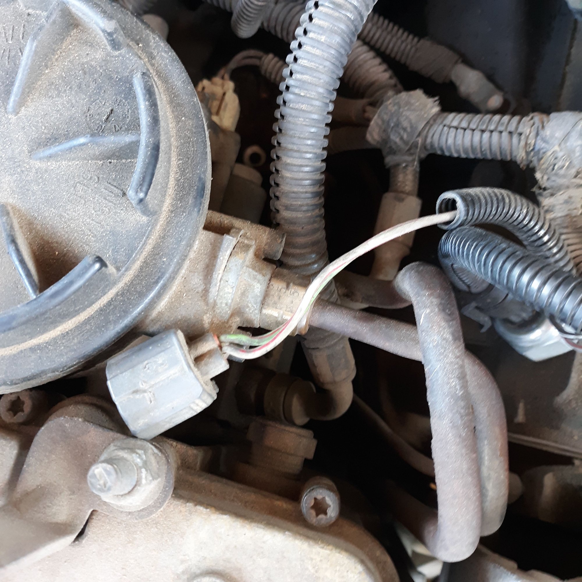

After researching the EOT sensor location, I went to check the connection and wires. This is what I found:
If I'm in the right location (rear of HPOP) then the sensor has broken off, and the PO must have removed it. No wonder I have a code! Looks like a trip to the parts store is in order. Anything special to know about replacing it?

That's a nice, easy fix. I'd like to hear how differently it runs afterwards.
