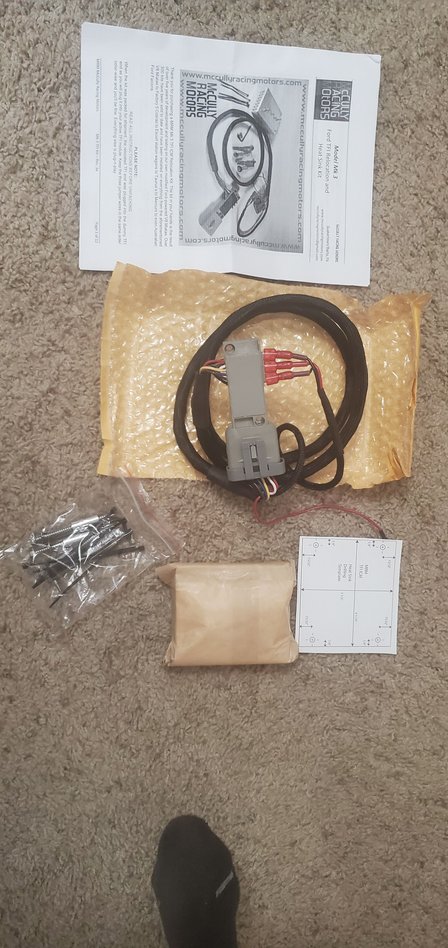

Thanks a lot for this link. I plan on buying the MK2. how is it holding up on your truck?

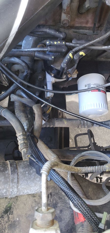

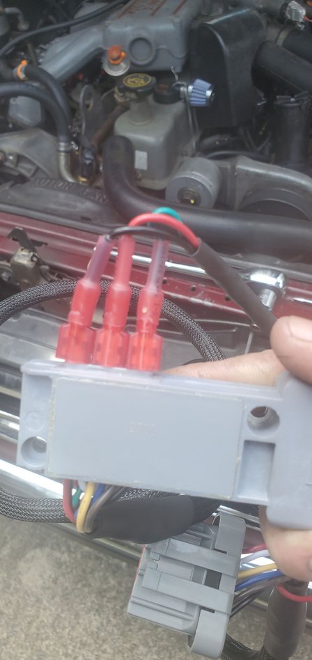

kit installed
