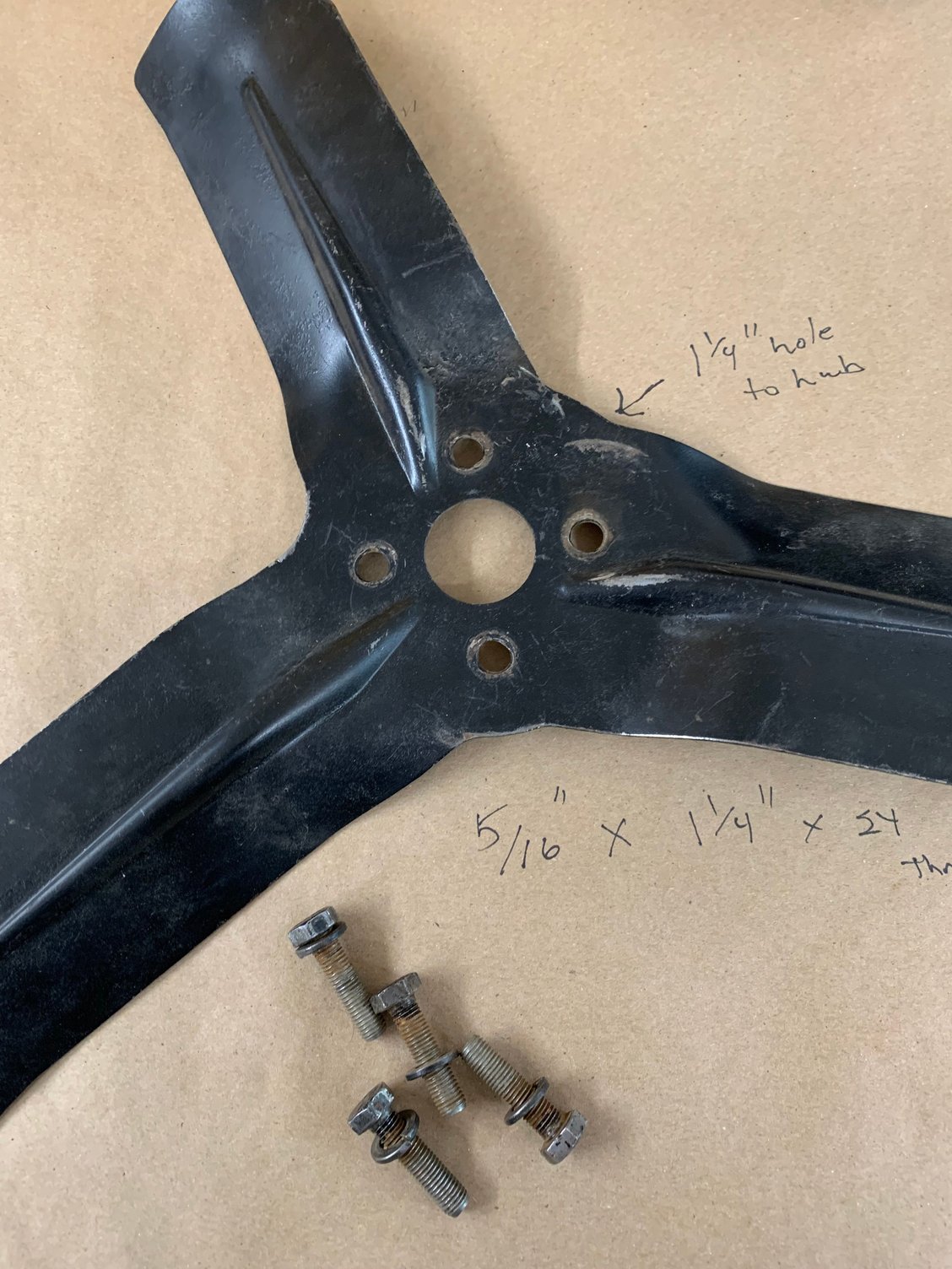

Old Aug 8, 2021 | 07:32 PM
blsd49's Avatar
blsd49
Joined: Jun 2005
Posts: 561
Likes: 67
From: Sandpoint, in north Idaho
More to the story
So I thought I would swap out the fan if for no reason other than to be more time correct.
As you can see from the pictures there’s way more to it than just swapping out the fan.! Guess I’m going to put the three blade back on!
Old Aug 8, 2021 | 07:52 PM
56panelford's Avatar
56panelford
Posts: 283,251
Likes: 8,159
From: northwestern Ontario
Looks like a different pulley is needed for it

Old Aug 8, 2021 | 08:49 PM
blsd49's Avatar
blsd49
Joined: Jun 2005
Posts: 561
Likes: 67
I think the problem is that the four bolts that hold on the fan hub assembly have different threads. That would make the job quite a lot bigger. Since this is the way it’s been, with a three blade fan, since I found a truck in 1976 I guess I’ll just leave it that way.
