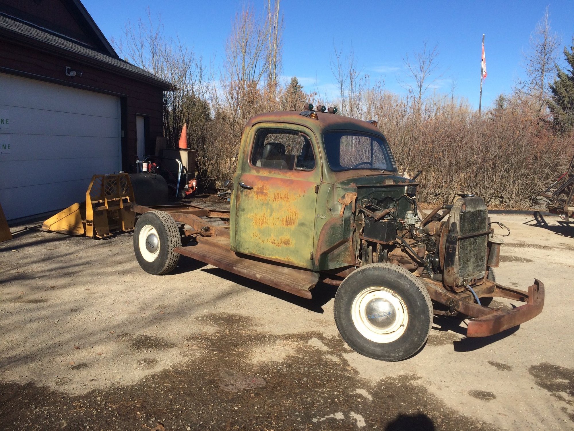

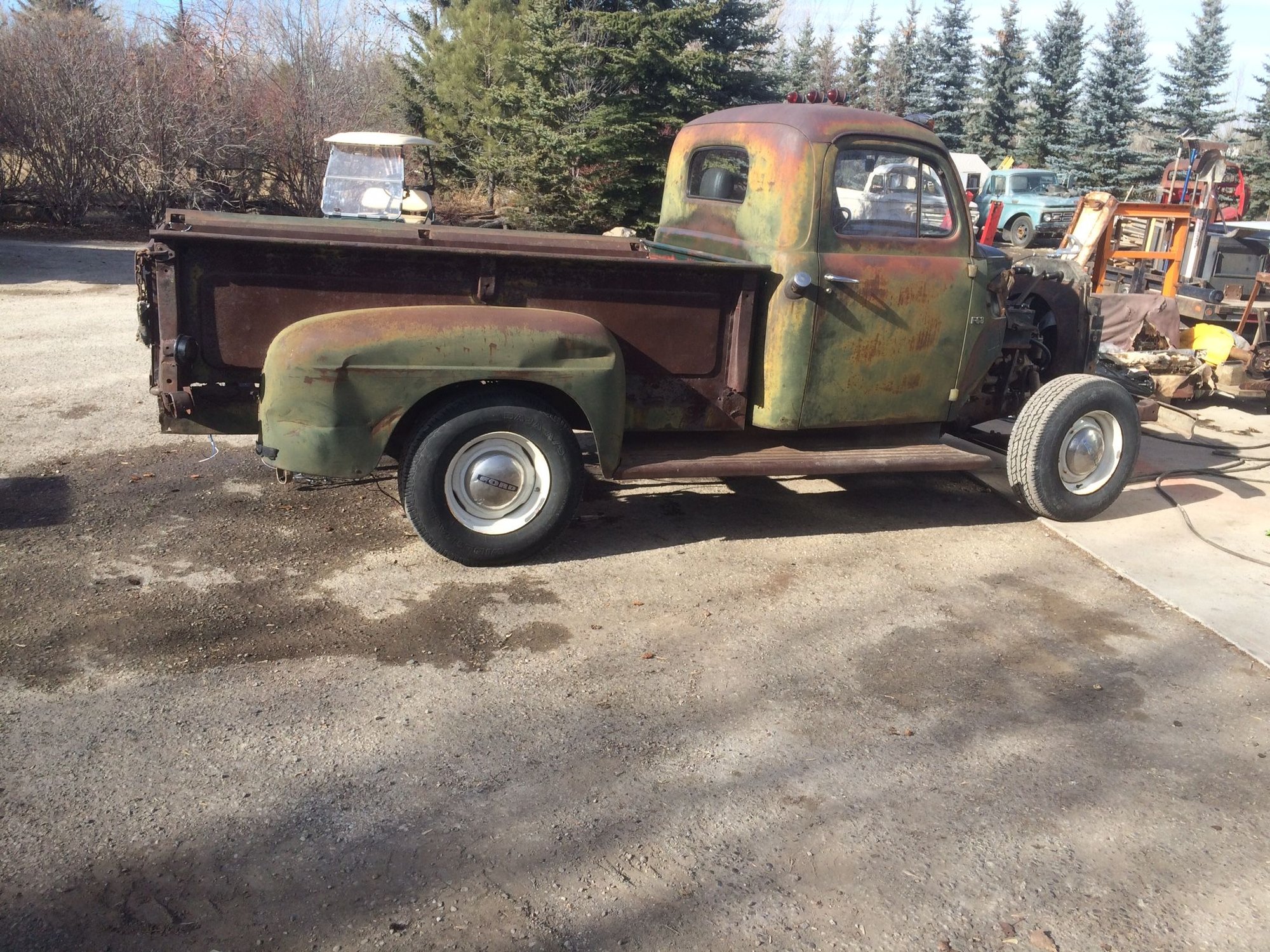

I have a 1949 F68 (F2) that I am having speedo issues. I have a 8 cylinder flathead engine and I put a heavy duty three speed tranny from a 1952 truck. The rear end is out of a 72 F250 with 3.54 gearing. The problem is the speedo cable whines and the needle jumps all over the place. The original tranny was a 4 speed crash box. What would be causing this? Is the gear in the tranny that runs the speedo cable different between the two transmissions? I assumed the gear in the transmission would be matched to the transmission and should not affect the speedo cable or gauge. Any help would be appreciated. I know everyone likes pictures ,so here you go. , Doug.
