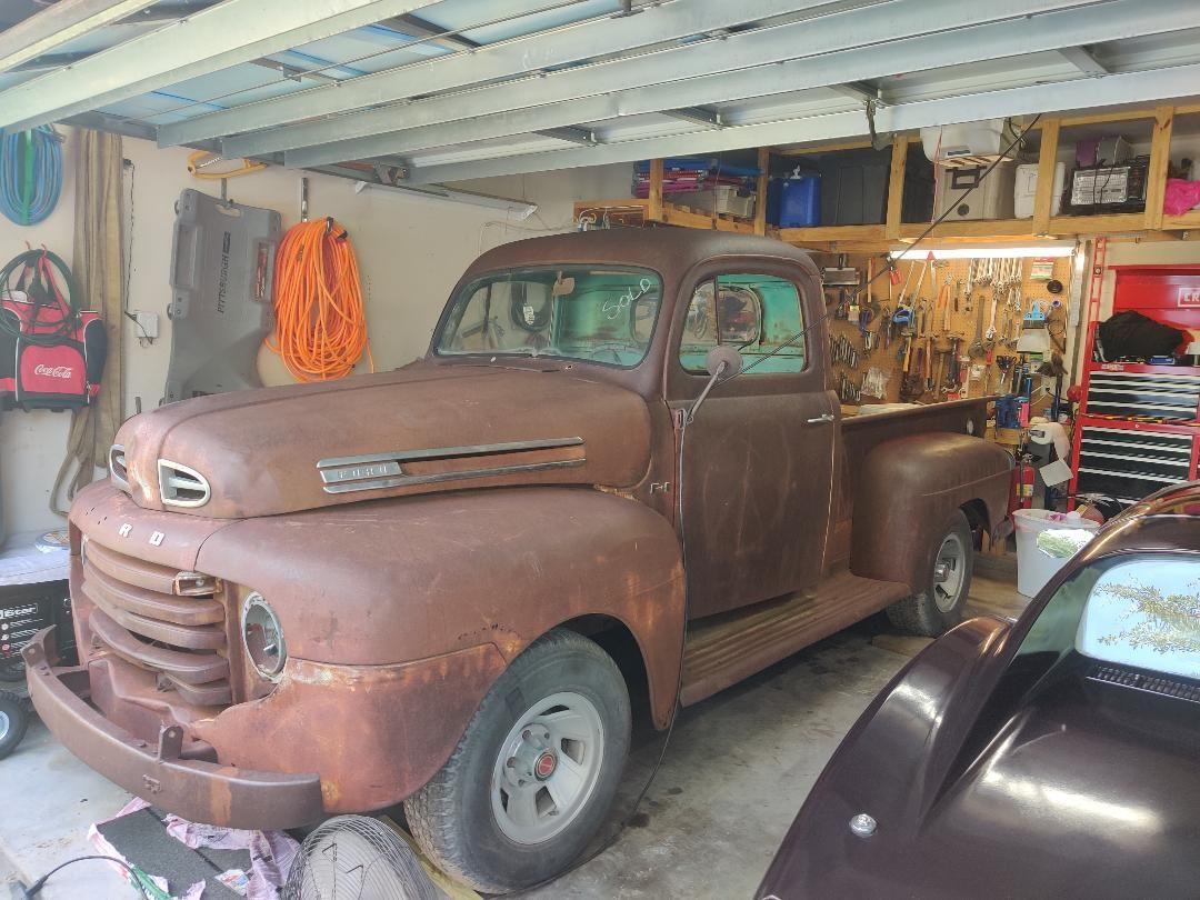

Some of you may have seen this truck when it was advertised for sale. I bought it just 20 miles from my house in SE Tx. It had no engine or transmission. I've been cleaning it up and removing everything on the firewall inside and out. The cab is very solid including the floor. The bed is solid too and has a sheet steel floor installed over the wooden bed. I have one small rust through spot on one running board. All the fenders have some rust through in the lower regions. There is almost no paint left, but, it was white. There are small areas of white paint on all the body parts under around and behind things. I believe all parts re original to this truck. The bed has smooth sides. This is another indicator that it is a 1950. Here are some photos. The cowl stamping is very hard to see.
I'm collecting needed parts and planning my work. The plan is to install a 1973 351C 4 barrel engine, AOD, 9" axle, Mustang II front suspension / power rack, tilt columb, new tubular engine and trans crossmembers, firewall mounted brake assy, A/C, and whatever else I come up with. I appreciate any and all help / suggestions. I will accept constructive criticism as well. This is my first F1 and I'm trying to learn everything I can about it.

You're going to make a lot of guys on this forum jealous with a project truck like that. You'll hear from them shortly.
I have one about like that - a 50 F4 that came from Wyoming. Sure is nice to start with a good foundation!

That is a beautiful truck. I like your build plan. It will be a fun truck to drive. However, you won't need the tubular engine mount. After the MII is installed you'll need to build custom motor mounts to place the engine where and how it fits best. The suspension crossmember and the aftermarket tube mount units will want to occupy the same space, and there's only room for one. Everything else definitely sounds doable.
