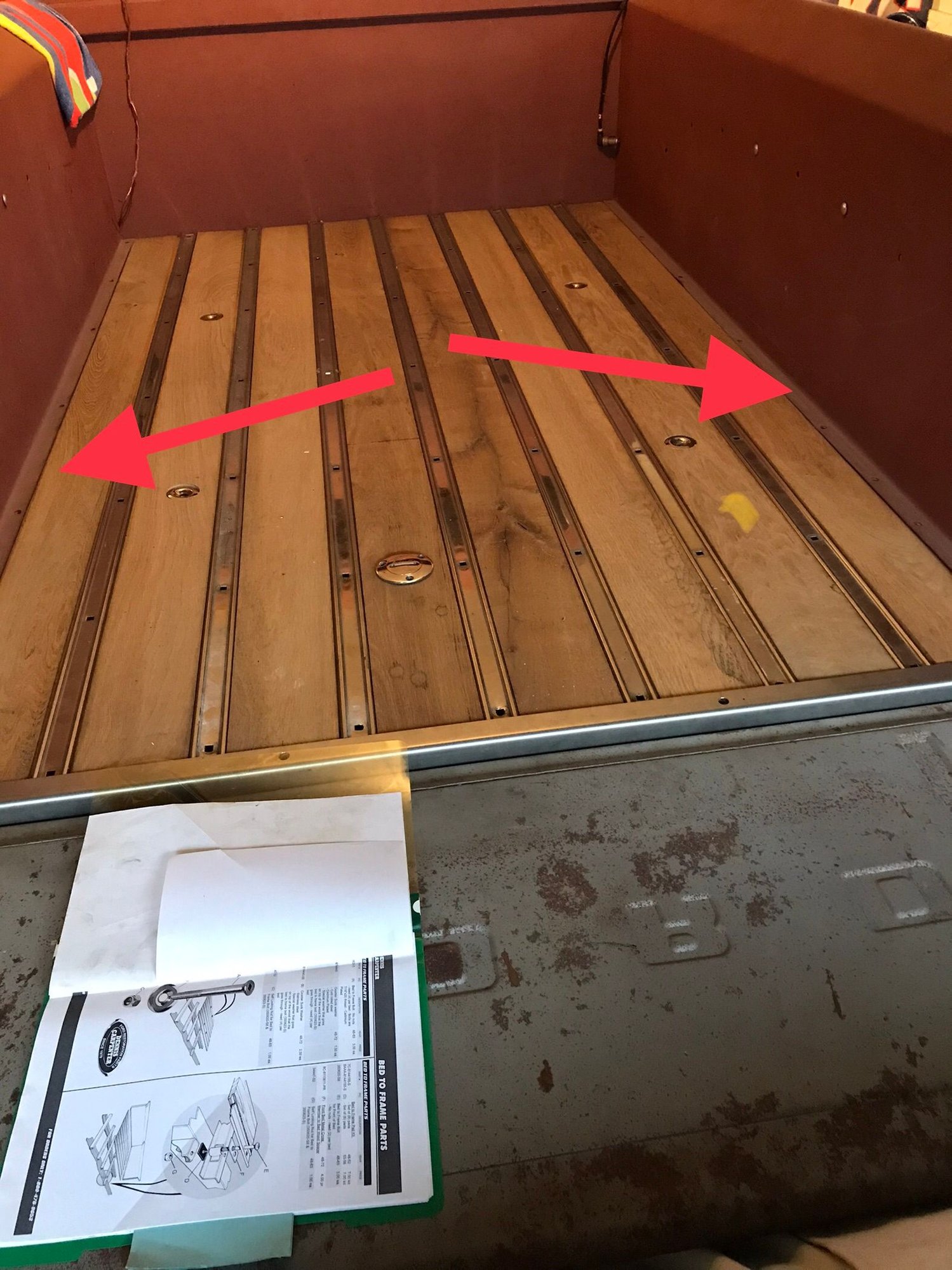

Made my own bed wood.
Today I made my own bed wood. Thanks Google I found all data (measure).
But I haven‘t found on this questions answers.

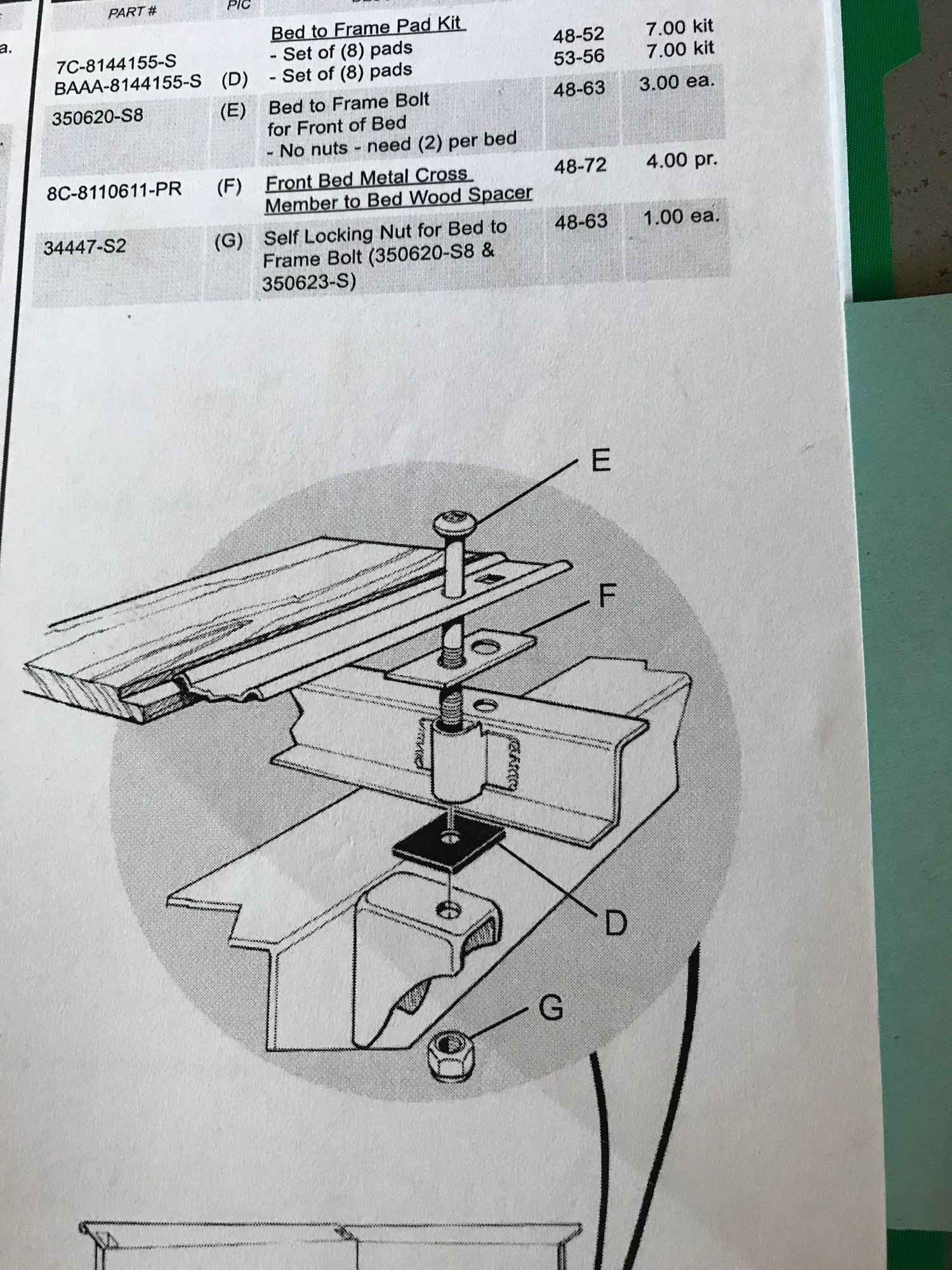

Was anti rattle between board and bed?
Ford truck 1956 bed wood.

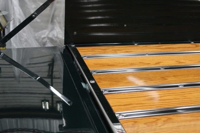

The end strip goes under?
Ford 1956 truck bed. End stip.
Was this the correct way to fasten the front bed?
Ford truck 1956 frond bed bolt.

When I did mine there was a gasket between the bed side and wood..I put the back angle strip under on mine..
