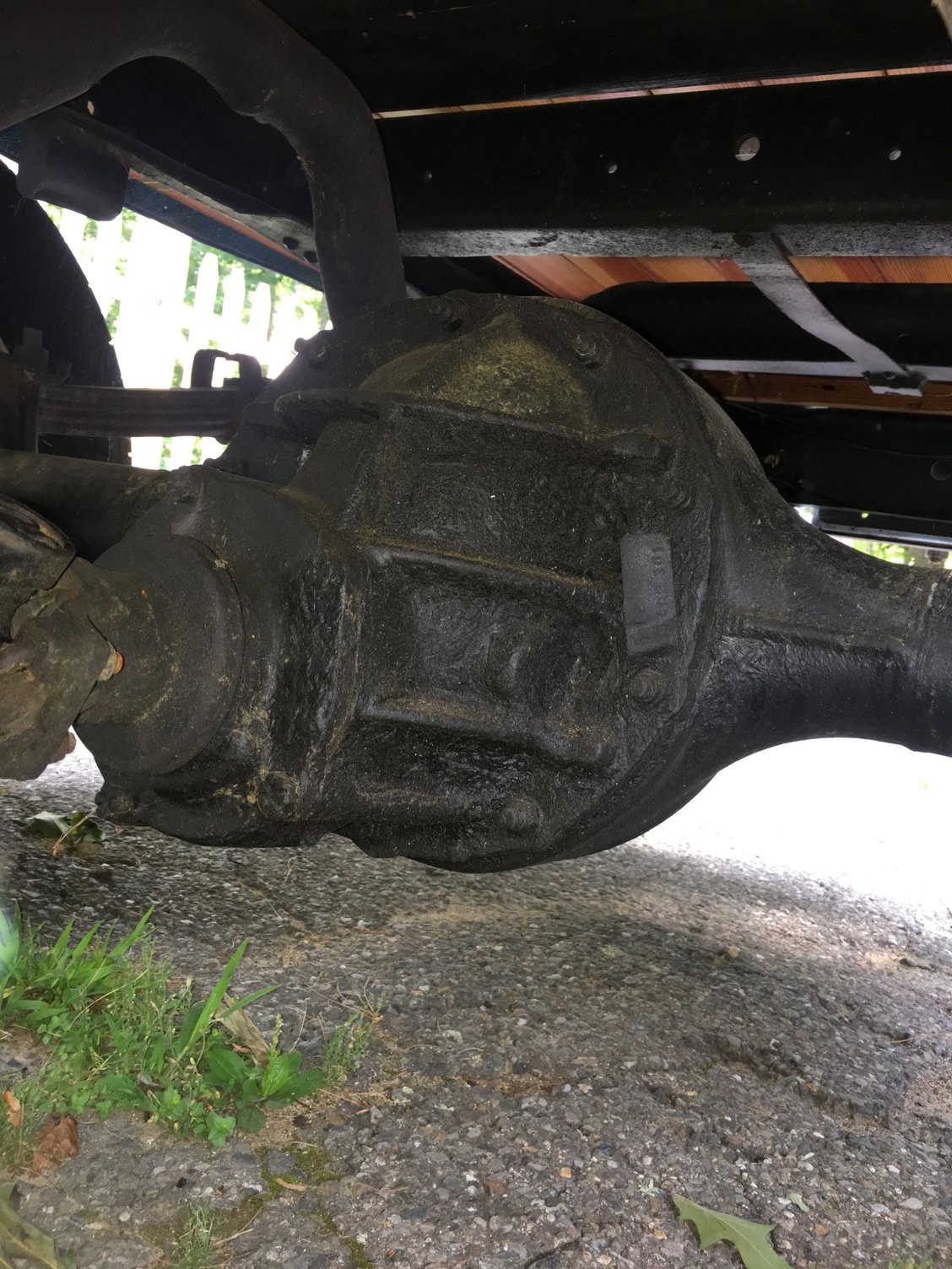

What year is this 9", I can take more pics if needed. I need to order a couple drum brake parts and they need a year make model at Oreilly. From a little research the 389 means 3.89 ratio

"4AB" is the date code. 4 is the year, A is the month and B is the week. So your rear was built the second week of January, either 1964 or 1974. Ford changed the style of tag in very late 1973, this is the earlier style so I would suspect 1963.

this link may help:
Ford Rear Axle Assembly Identification - Page 01 - FORDification.com
Ford 9”, 3.89 gear ratio, 63-71 Ford truck but still need decode for the date code on your tag 4AB and plant code 301.
Also assumed you are missing the “W” on the first code “BG”. Meaning I think it was “WBG-F2” originally.
I could be very wrong though. I’m sure someone with more expertise will chime in for more clarity.
Good luck in your search.
Edit:
using info from Mike for 4AB decode and year range from my info above, looks like week 2 of January in ‘64

Well no fill plug in the carrier it's in the housing. I would say that is a 1963 unit.
