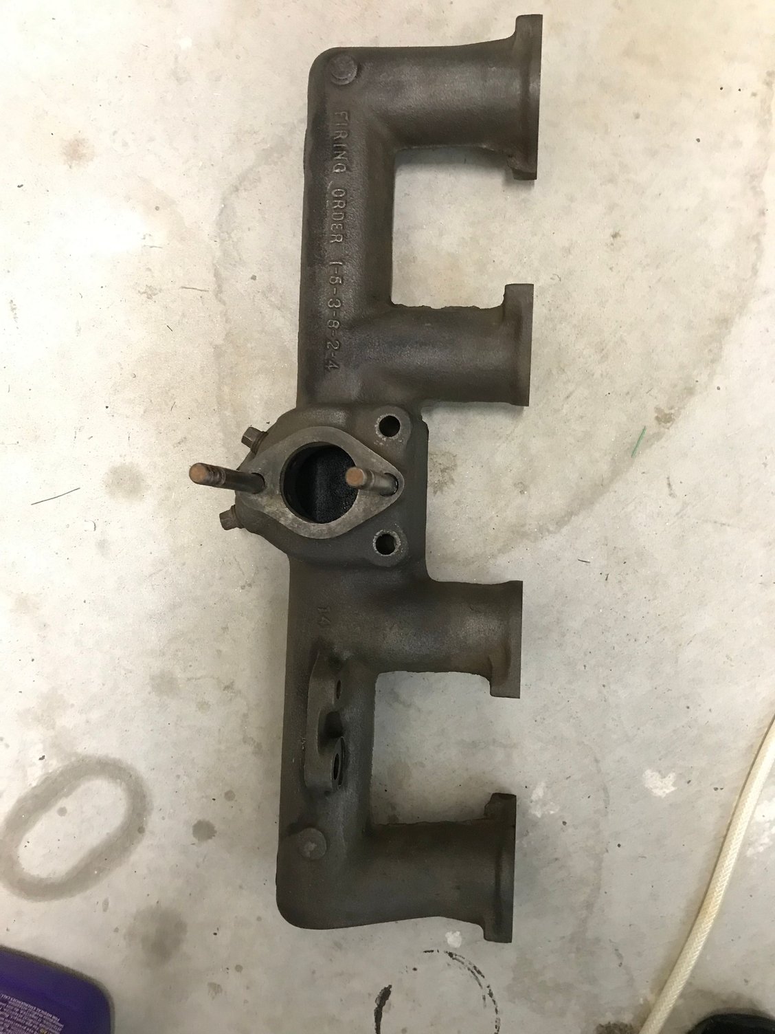

Here is my intake manifold after 24hrs. Had to clean the rebar twice and replenish the washing soda. Required some scrubbing and cleaning with a scouring pad and wire brush. This came out really nice. Has some flash rust but right before paint I will clean that off with some CLR and a scrub pad.
