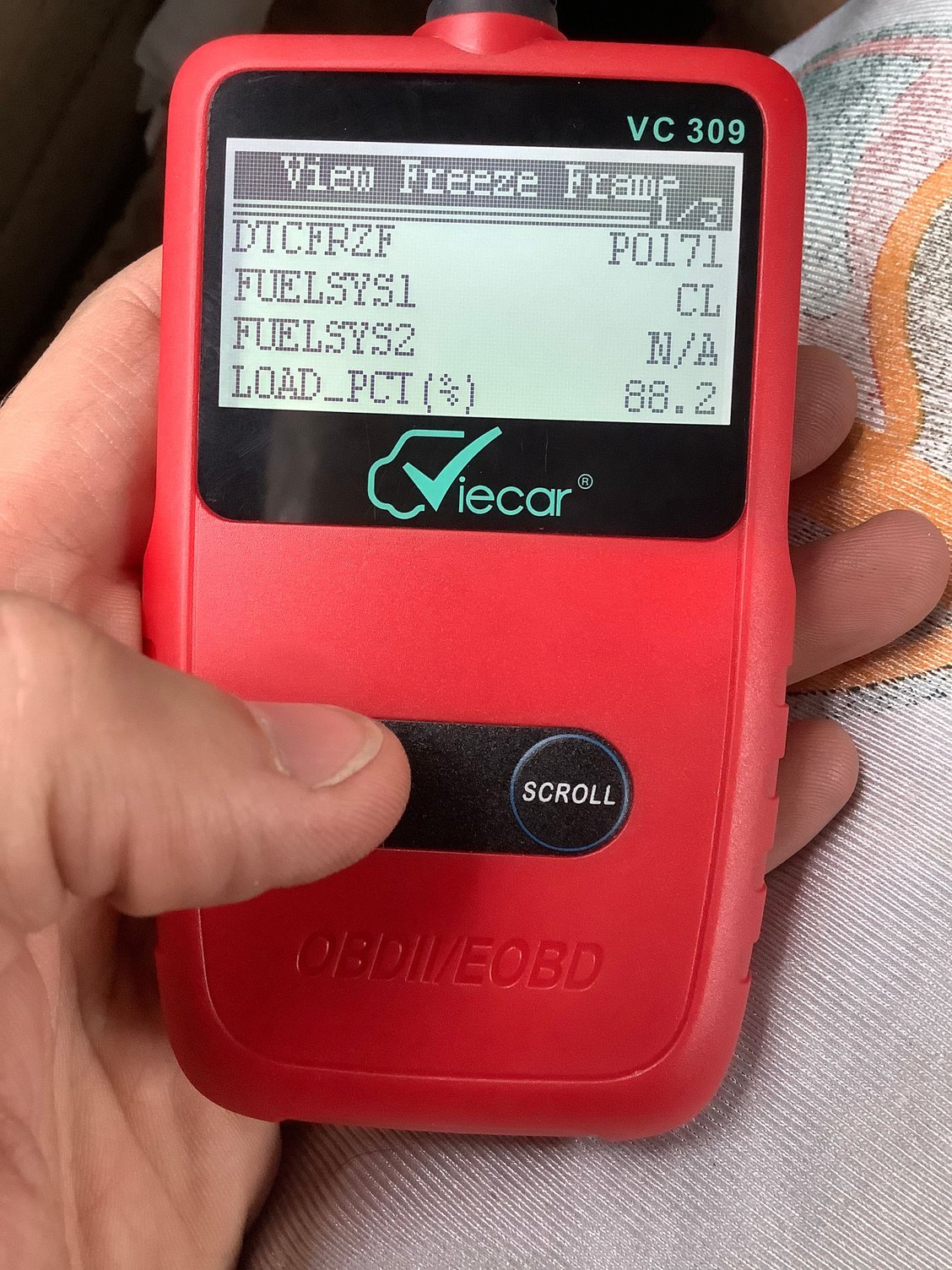

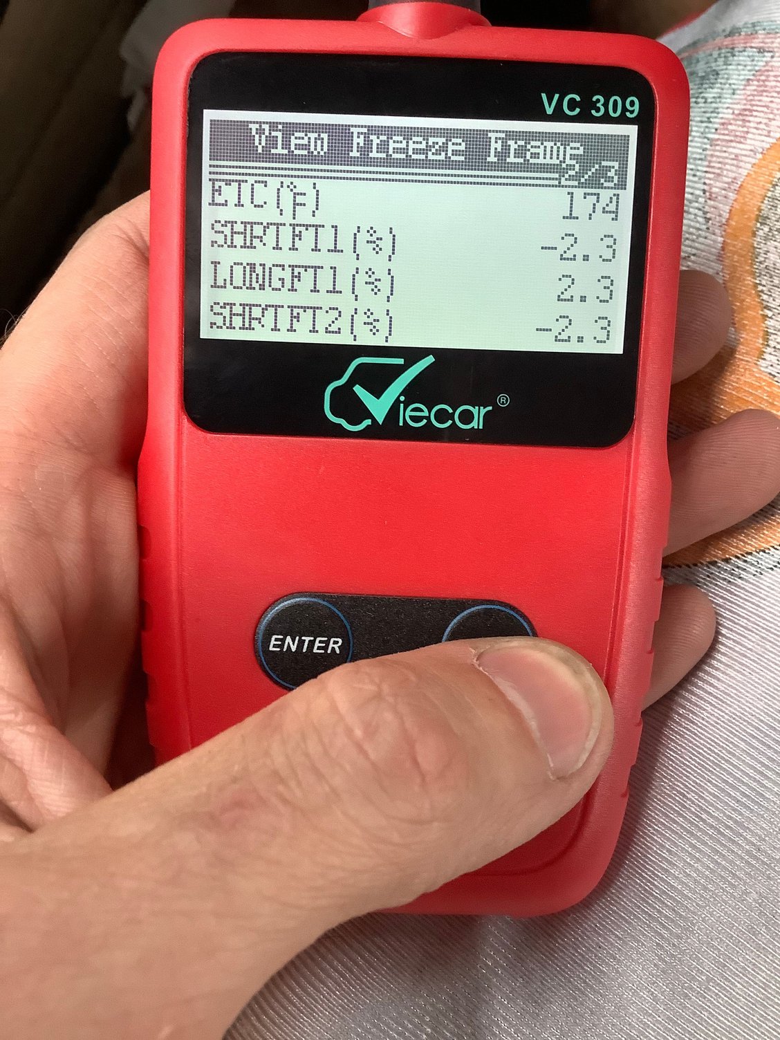

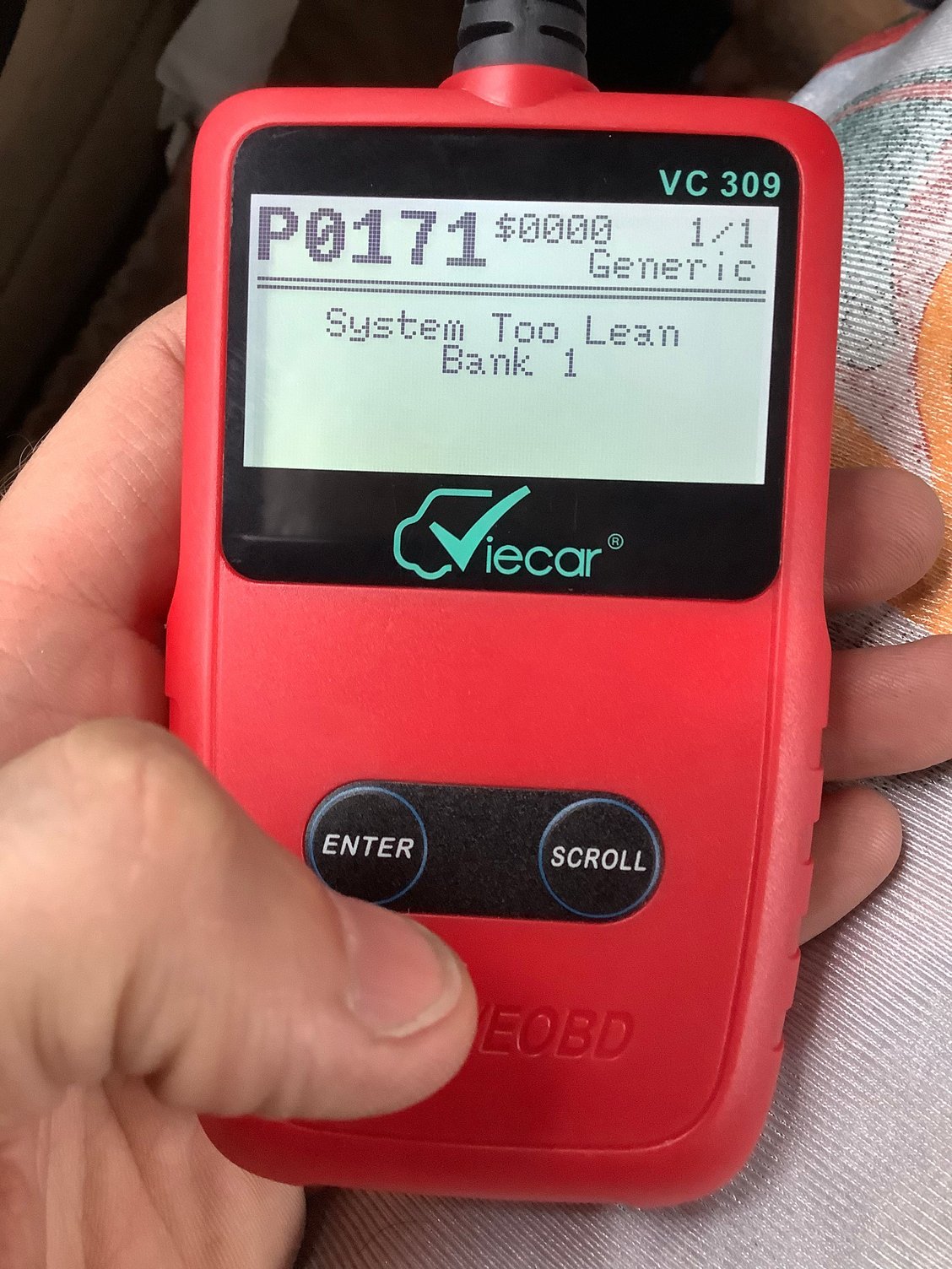

Looking for a little help here. I had the CEL light come on a couple weeks back and had to drive my van (‘01 E250 5.4) about an hour before I could check it out. Found the PCV valve had come out and I had 0171 and 0174 codes and really rich fuel trims…makes sense. Got the PCV back into the valve cover and applied a fix so that it wouldn’t pop out again (basically extending the elbow so it wouldn’t put upward pressure on the PCV…hose from the pcv to the back of the intake is new). Thought I had smooth sailing ahead, but I’ve been getting a p0171 code but not the p0174 code. The code is getting thrown right when I start up after a few drive cycles since reset. The LTFT have been either negative or really close to zero. Rpm have been low on the freeze frame, but the engine load has been high, but I have not been stomping on the gas. I have sprayed carb cleaner and inspected for vacuum leaks. The two upstream O2 sensors were replaced before the last time I had a code. I cleaned the MAF sensor well with crc cleaner and the fuel pump was replaced last summer with a heigh quality one, which was probably only 3000 miles ago. Any ideas from the knowledgeable folks here?
This is the freeze frame data from today.

That confuses me. What I’ve read, is that fuel trims more than +/-20% off from baseline are a case for concern. -2% would be considered really good. Of course you can’t believe everything on the internet.
I should add that it’s been running greatb before I get the code and after.
Does anyone know how engine load is calculated for these engines? Both times now, the freeze frame data have shown a load close to 90%. Seems odd at 600 rpm and 0 mph. I wonder if it is a momentary bad signal from the MAF or TPS. Maybe one of these sensors is on its way to failure?

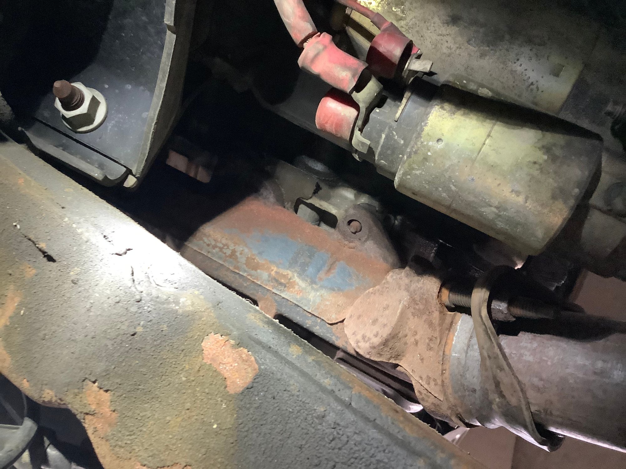

Think this would cause my problem? That’s the stud broken off of the number 4 cylinder exhaust manifold. I don’t see a lot of soot around there, so maybe it’s not a really bad leak yet.
BTW, I went and rented a fuel pressure gauge. ~33 psi at idle and when I rev it up, the pressure jumps a bit then settles back to 33 psi. I didn’t drive it.
Nope, the manifold stud is a red herring. It can cause a noisy exhaust leak that would fail a state inspection in a number of state, but it can’t cause a lean code because it has no bearing on the inputs the PCM uses to determine fuel trims. It would take a huge exhaust leak that would deafen your neighbors to cause a lean code on its own.

Doesn’t the lack of rich fuel trim seem strange for a supposedly lean running engine? I would expect for the ECM to start dumping more fuel to try to compensate for a lean condition. 89% load in park seems nearly impossible (codes seem to be triggered after startup when parked for a few minutes in hot weather…and all we’ve had is hot weather).
