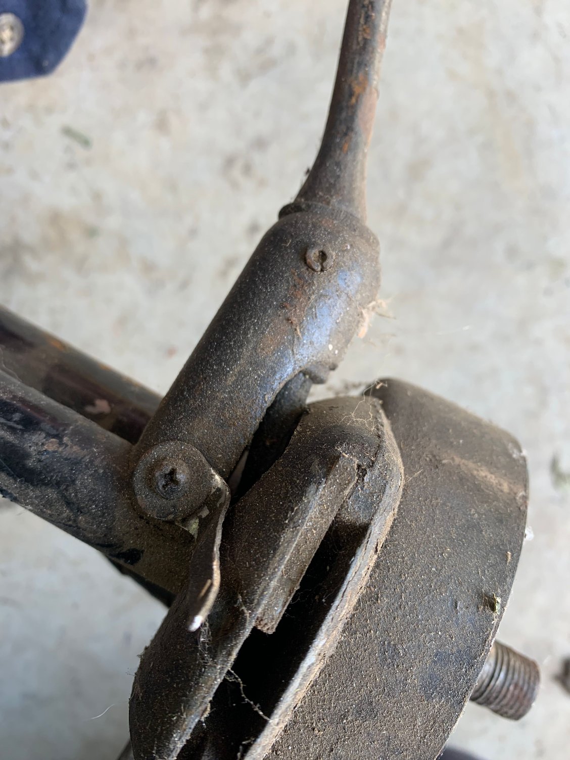

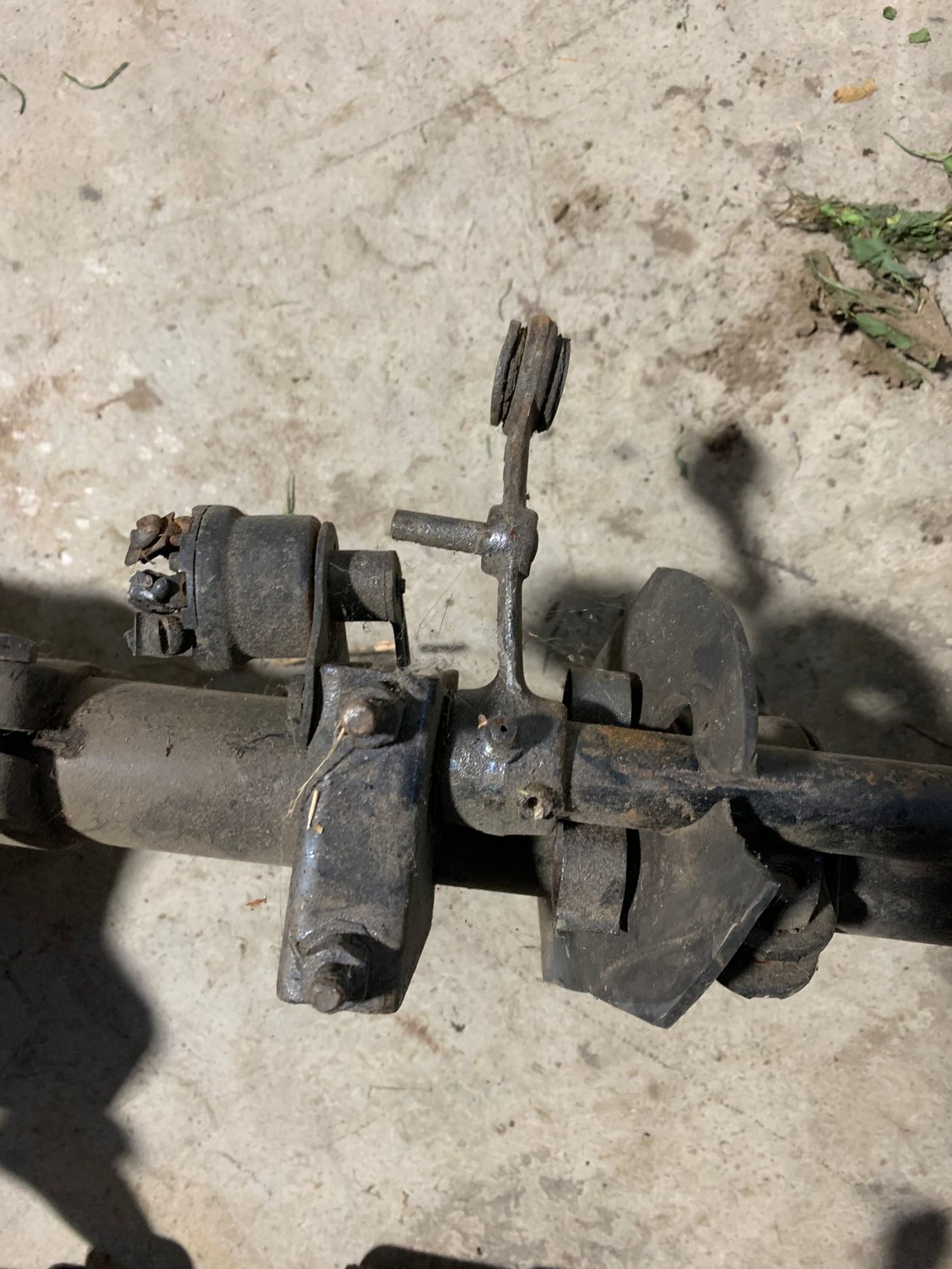

Old Aug 3, 2021 | 12:35 PM
ALBUQ F-1's Avatar
ALBUQ F-1
Joined: Jul 2004
Posts: 27,294
Likes: 1,055
From: NM

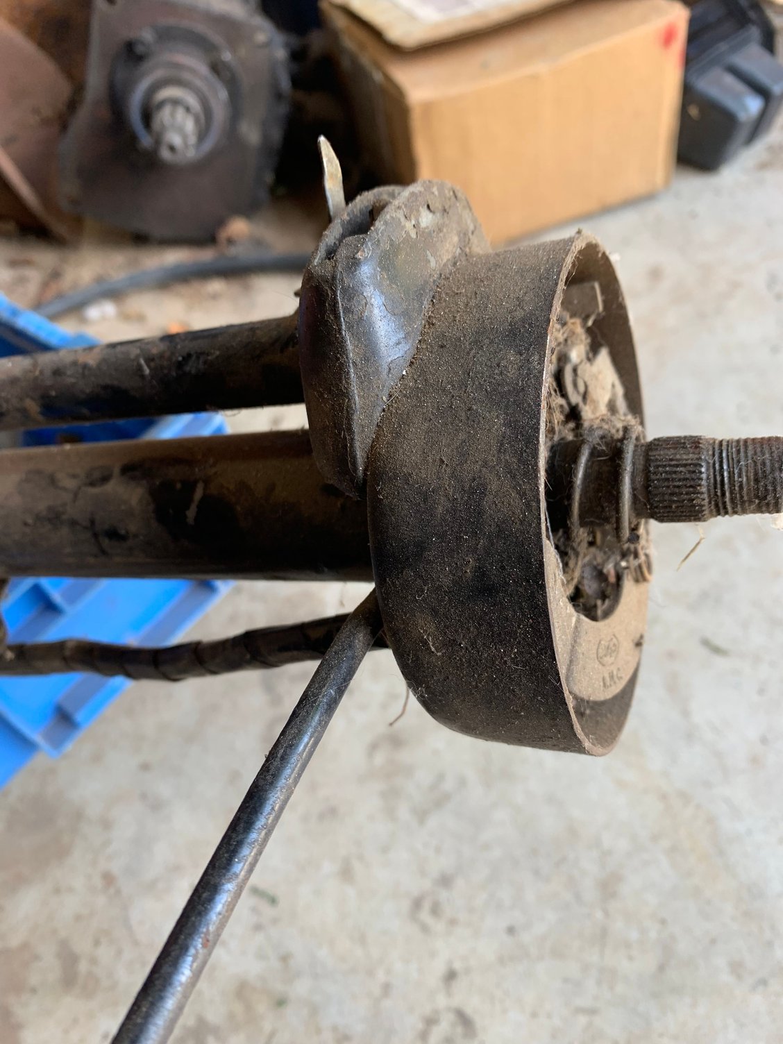

It appears someone has drilled out the lever retaining pin hole and put a bolt in it? There's usually a spring loaded pin there.

Your column appears to be a 3 speed manual shift not an automatic

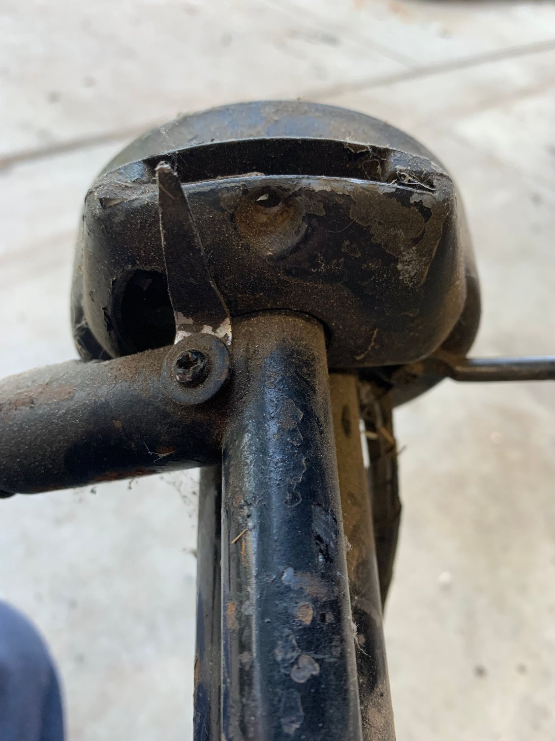

Old Aug 3, 2021 | 02:22 PM
1954F100ranger's Avatar
1954F100ranger
Joined: Apr 2021
Posts: 215
Likes: 29
From: Hazel Green, Alabama

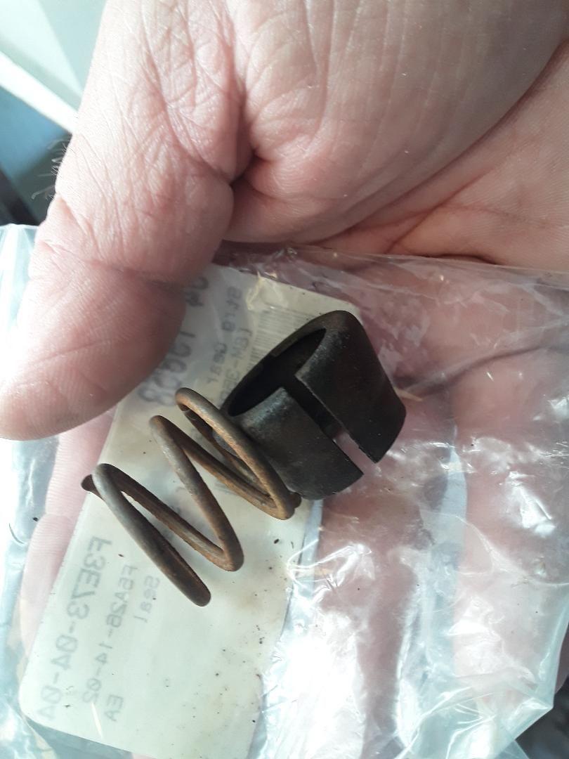

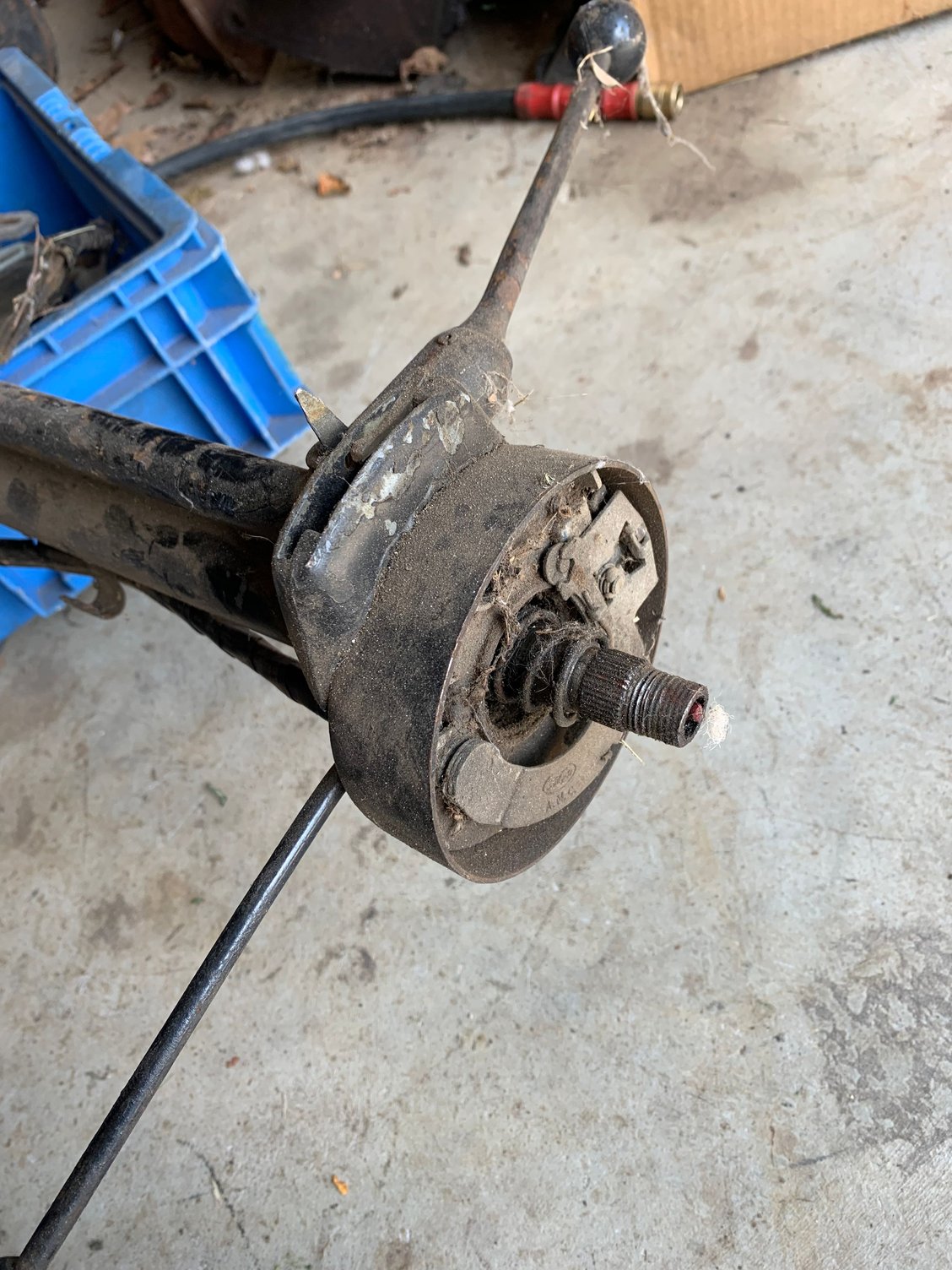

It better be an automatic one, that's what I bought. Here is a picture of the bottom end of it. It only has a single shift lever.
And I thought that manual shift has a tapered handle and not a ball end.
Could the indicator parts been previously removed?
Spring is missing. These were the only two parts in the little ziplock. The pieces to go under steering wheel.
In picture below does this look like the correct spring?

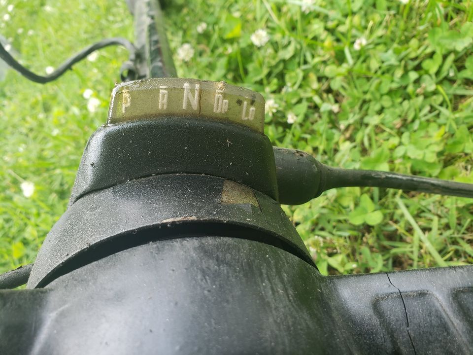

Here is a pic of a '56 one that looks like yours
In the picture below is that the spring and pins that I need?
Old Aug 3, 2021 | 03:56 PM
ALBUQ F-1's Avatar
ALBUQ F-1
Joined: Jul 2004
Posts: 27,294
Likes: 1,055
From: NM
If the hole was drilled out for a bolt, I really doubt the spring and pins will still fit, they'd almost surely be a smaller diameter.

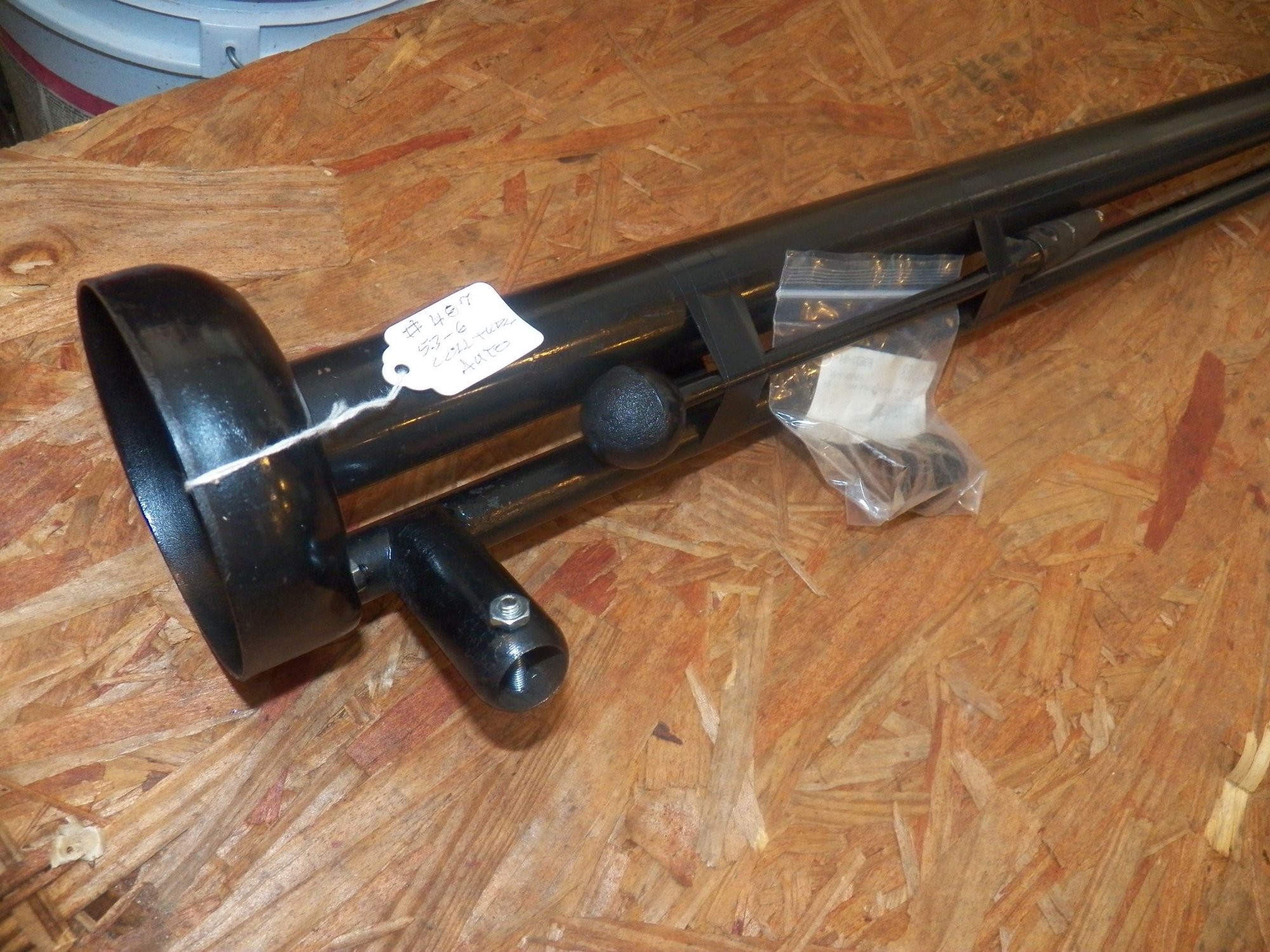

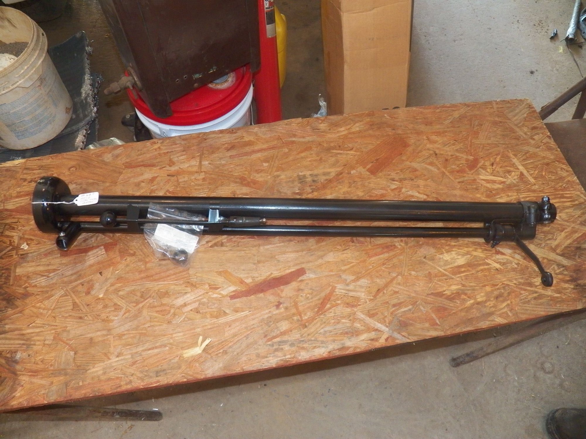

Old Aug 3, 2021 | 06:19 PM
bigwin56f100's Avatar
bigwin56f100
Joined: Jul 2003
Posts: 9,366
Likes: 1,725
From: AKRON ohio
53-55 style
Bottom column is 56

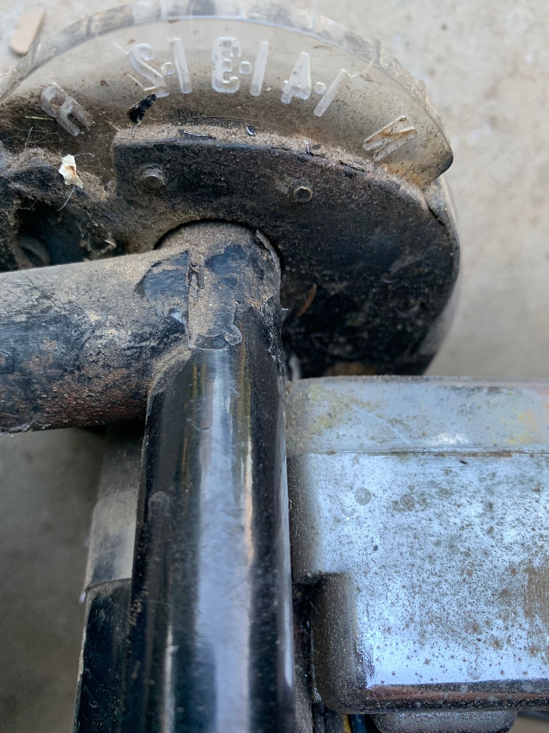

also note:
this is for 56 and newer as the 53-55 use one screw not 2
56 style
53-55 style with only one mounting hole for indicator
