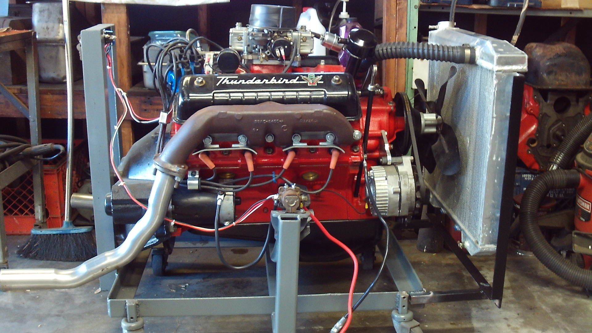

nice engine! what did that go in?
Old Oct 15, 2021 | 01:41 PM
  #42
hiball3985's Avatar
hiball3985
Joined: Mar 2005
Posts: 3,771
Likes: 80
From: tujunga, calif
Thats two different engines and I accidentally posted a wrong picture The complete one on the cart was an engine I built for my 57 Ranchero. It only has about 2-3000 miles on it. So then I decided to rebuild the original engine. and install it. Then I got bored during the shut down last year so I put the first engine on a cart I built from scrap to keep it running rather then just storing it on the floor.
