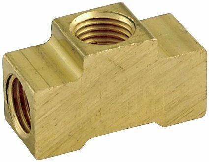

I think I'll go the easy route and buy a brake line T
Quitter.....lol

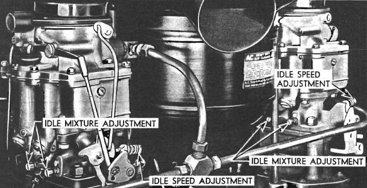

Here's what looks like a either a factory or shop manual drawing, looks like flared fittings.

Well, here's my set up so far. I went with 3/8" because I couldn't find 5/16" flare fitting any where. I found 5/16" brake line everywhere but no flare fittings.
