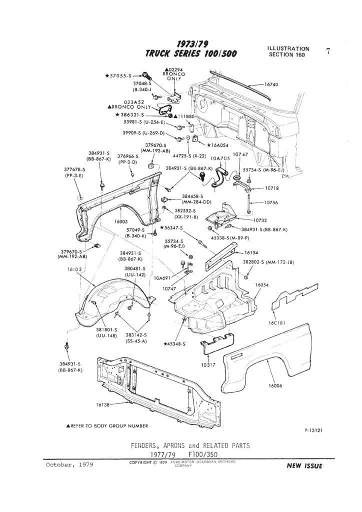

Here are the parts #s from the 73-79 F100-F500 master parts catalog. If there was a difference it would show up in the parts #s. Welcome to FTE

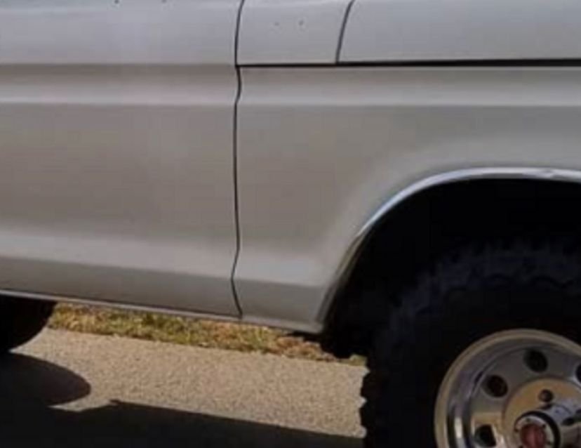

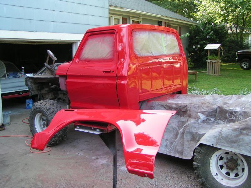

Using some pictures from online, this would be the difference between the two. The bottom lip behind the wheel

Good description 73FordFe !! I knew exactly what you were talking about as I have one also stored upstairs in my barn ! It was an AFTERMARKET fender purchased years ago along with others. I think I have a total of 9 new or good usable fenders. I was VERY surprised to see this 1 fender WITHOUT that horizontal body line.

Thanks for posting the pictures. I was looking for some also. I'm sure I've seen another thread about it, probably, here, but I can't find it by searching. I thought that's what the OP was talking about from the description.

Thanks for the replies. So you are saying the one like on the red truck I posted is aftermarket?

[QUOTE=73FordFE;19990254]Thanks for the replies. So you are saying the one like on the red truck I posted is aftermarket?[/QUOTE
Could be aftermarket, could have just had body work done and someone thought it looked better smooth.
