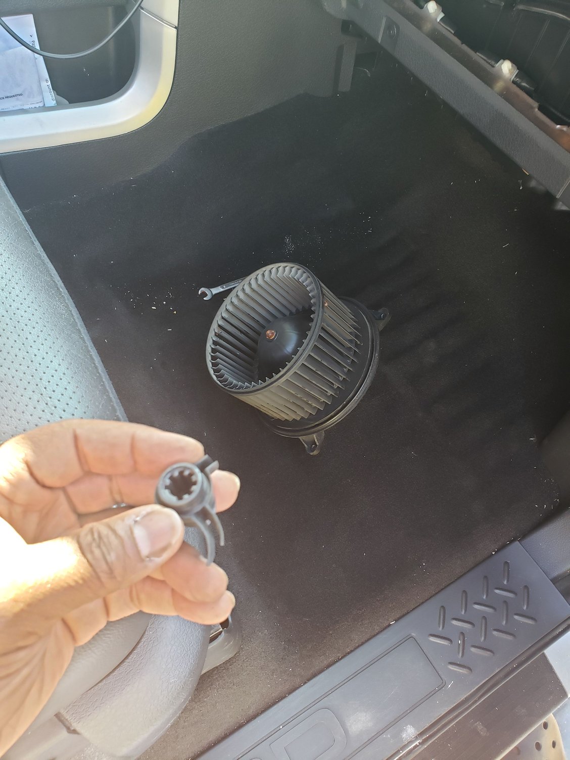

Blend Door Flap
My Blend door flap failed and I'm trying to find a replacement but I'm not getting anywhere. From the pic below, in my hand is what I found in my blower and now all I get is outside air inside the cabin so that leads me to believe the blend door flap failed. Can anyone help?

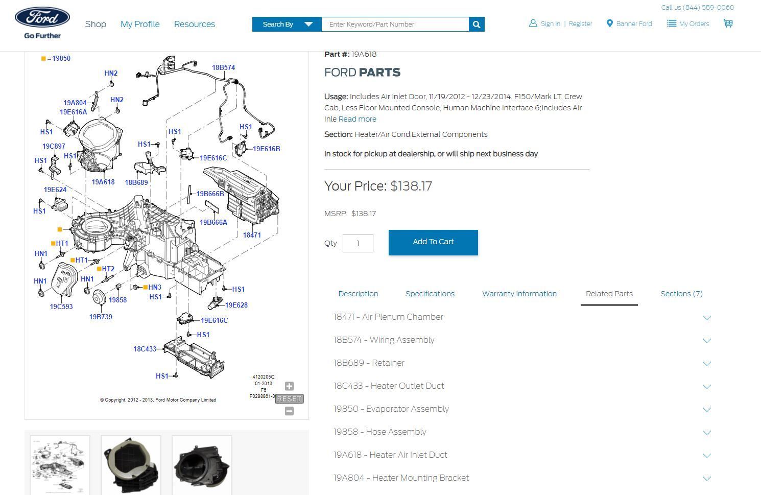

Fresh air intake door, you'll have to remove the dash in order to change that plenum section, can't just buy the door. Some people have used screws to jamb that door up into the closed position so that it stays closed and recirculates cabin air all the time.
If you wish to change that plenum, here's a part breakdown of it. Part #19A618

Thank you for the clarification and the tip. I think I will use a screw to jam it shut. Thanks again!

Would you know how to get to the air intake door to jam it shut?

I did that on a 2002 Explorer... You could lay on passenger floor and look up at the firewall and see the duct... I had to remove the glove box to pin the door closed.. not saying its the same, but general area...

Might be able to go thru the blower fan hole inside the plenum. I've never done it, just reporting what another user did to his truck.
