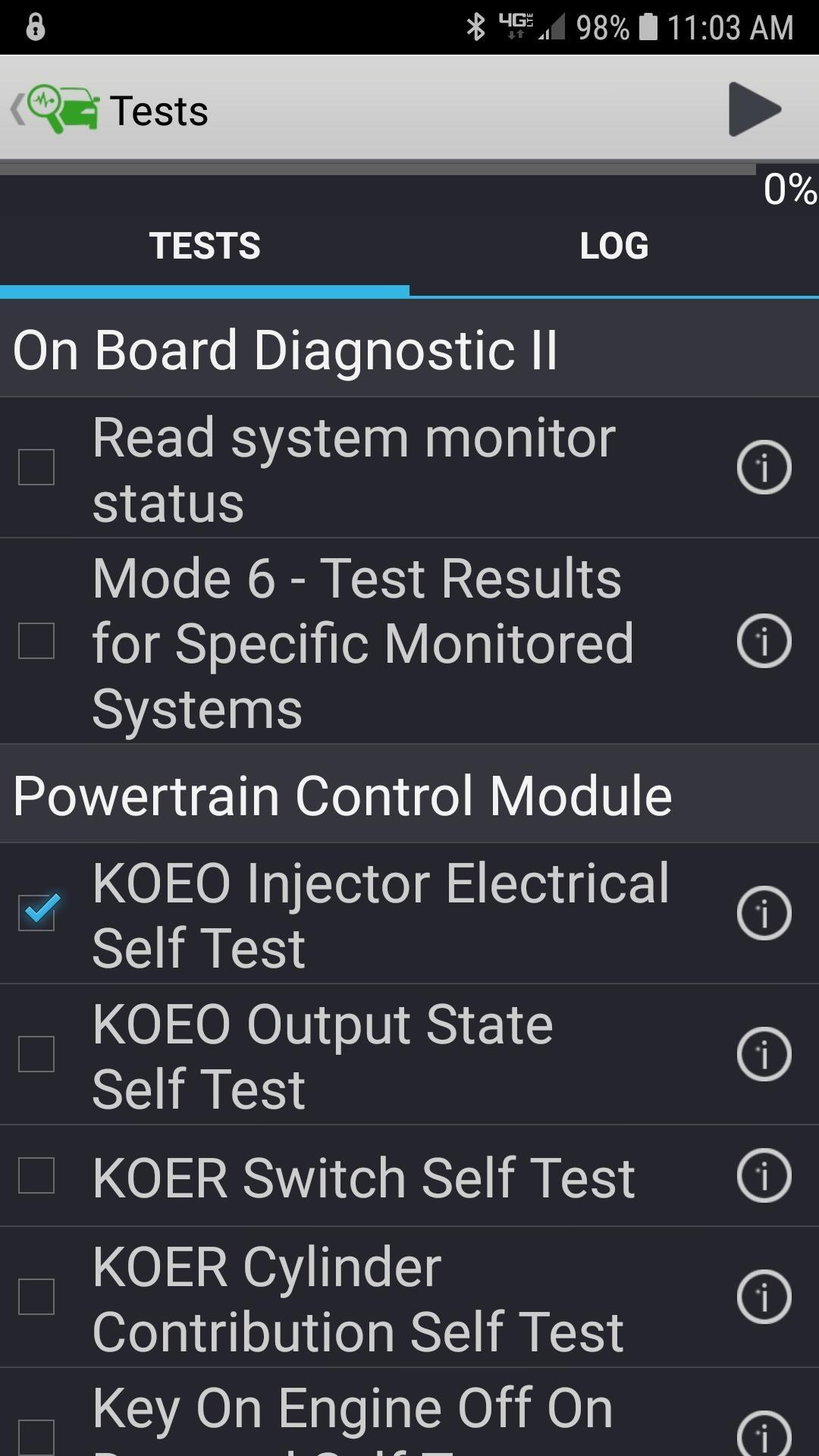

Nice work looking at the live PIDs - I'd suggest using FORScan to read codes, view PIDs and see if Torque missed any. It will also run the "buzz" test (KOEO Injector Electrical Self Test in FORScan) and tell you what specific codes are behind that P1316 code.

I ran Forscan and got some interesting results with the Injector Electrical self test.
Code: P0261 - Cylinder #1 Injector Circuit Low
Module: Powertrain Control Module
Diagnostic Trouble Code details
This DTC may be caused by :
Short to Ground
Possible causes are:
Harness wiring
Fuel Injector
DIDM
Inspect connectors for signs of damage, water ingress, corrosion, etc.
Code: P1298 - Injector Driver Module Failure
Internal DIDM failure
DIDM
Follow the routines in the service manual to resolve the DTC listed.
Code: P1291 - Injector High Side Short To Ground Or Power - Bank 1
Short circuit
Harness wiring
Fuel Injector
DIDM

Ok, that helps. Issues with the passenger side bank - bank #1. Time to do some wire harness testing.

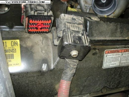

With the IDM disconnected, you can check for a short to ground on cylinder #1 low side, and bank #1 high side (fuel injector feed). See the attached troubleshooting diagram and pictures:
I would not worry about P1298 just yet. That might clear when the wiring issue is resolved.

@Walleye Hunter is on to it, I bet. Check your 42 pin connector harness where it passes over the driver's side valve cover. It can rub through and short a wire or two intermittently, causing the stumble/stall and SES/WIF/WTS lights. There is your short to ground on those 2 wires.

Yep, I had that harness short there before on the valve cover years ago, but it wasn't that severe. I taped it up real good and haven't had any trouble since. But I will untape and make sure it hasn't deteriorated further.
