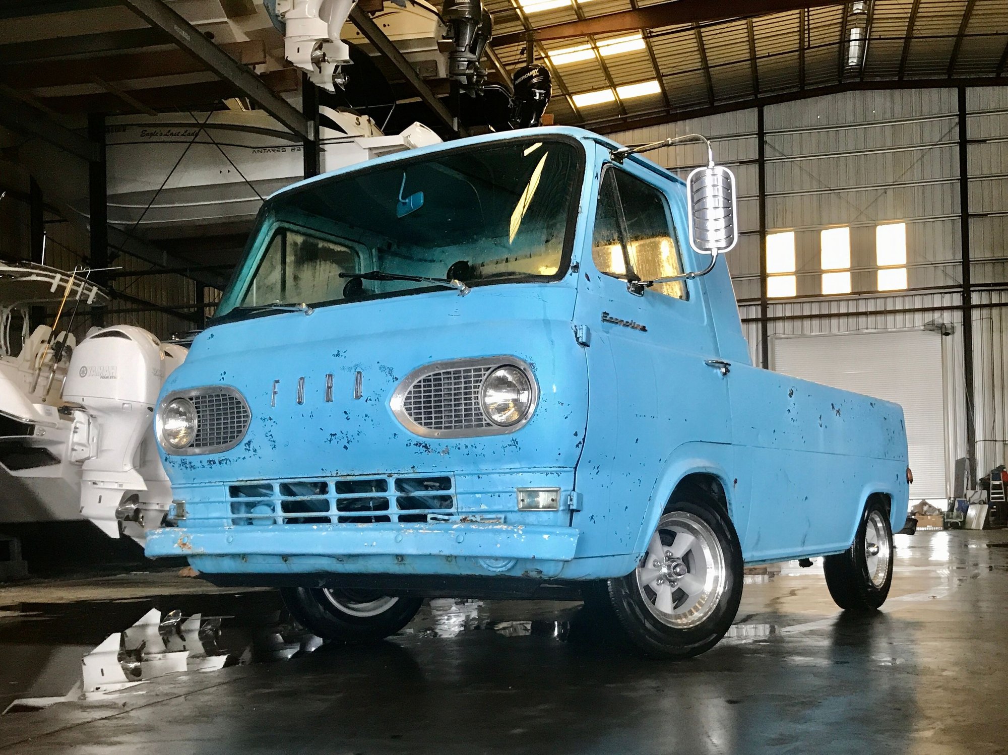

Thanks to all the members I have learned from over the past few months, since inheriting my 1961 Econoline Pickup. My father pulled it out of a junk yard in 2012, got it running, and kept it running (barely). He was no longer able to work on cars like he did when I was a kid, so most of the work went to the family mechanic. We used to joke that it lived at Scott’s Auto, and visited us from time to time.
Im going to try to continue to post photos and info as I improve and restore, to pay back for the help I’ve gotten, and pay forward for the next guy who goes looking for info to save an Epup.

Thanks to you both. She’s rusty, but a ton of fun.
I’ve gotten the exterior rust stopped with one of the rust converters. Oxy-gone I think. I’m not going to restore it cosmetically. Just preserve it. There’s a ton of bondo on the passenger side, and the tailgate is, well, bad.
I’ve got all the window fuzzies and rubber trim on order and am going to shoot it with satin clear, and install the new window stuff when it all comes in.
I understand there are springs in the wing windows to hold them open. Does anyone know where they go and how to install them?
