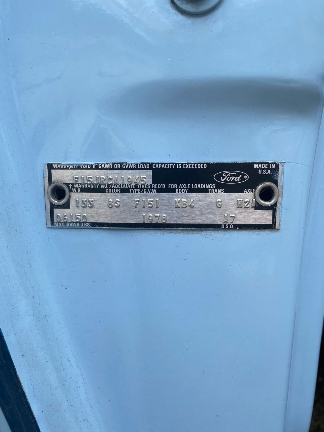

Anyone know how to ID a trailer Special?
Does the VIN tell anything?
F15JRCA1945

This is all the Vin is going to give us.

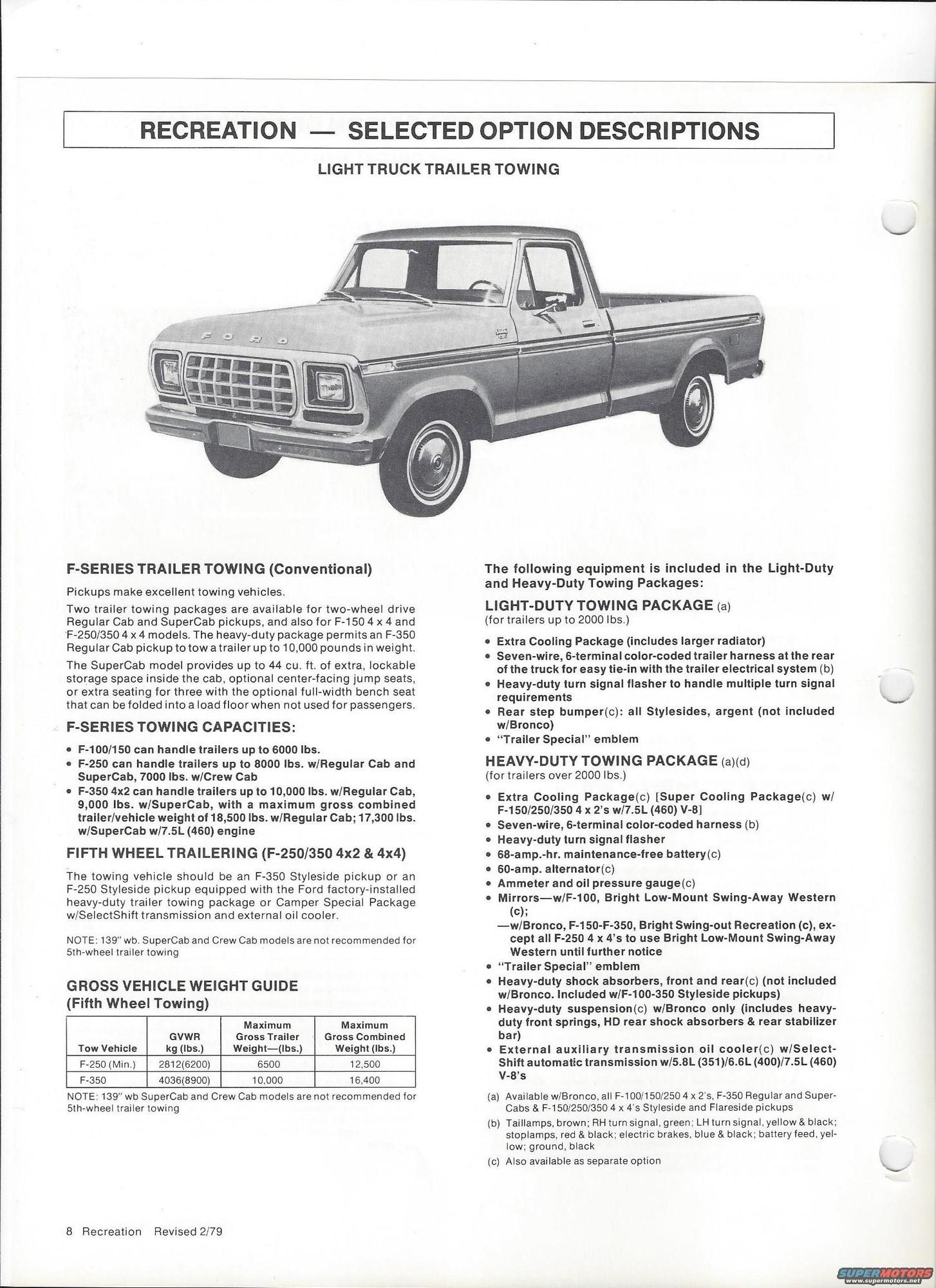

Old Jul 20, 2021 | 10:12 PM
Vinford's Avatar
Vinford
Joined: Aug 2004
Posts: 3,455
Likes: 8
From: Williams Lake B.C.
Old Jul 21, 2021 | 08:23 AM

6150 GVWR is that heavy?

Nope, My 79 Trailer Special says 7900 GVWR

Your truck is a F150 and IIRC Ford didn't produce any trailer special's for the 100/150...only F250/350

There were Trailer Special F150's.

Does your truck have eight lug nuts per wheel or five?

I can confirm that Ford also made a F100 Trailer Special and will happily accept bets saying otherwise
