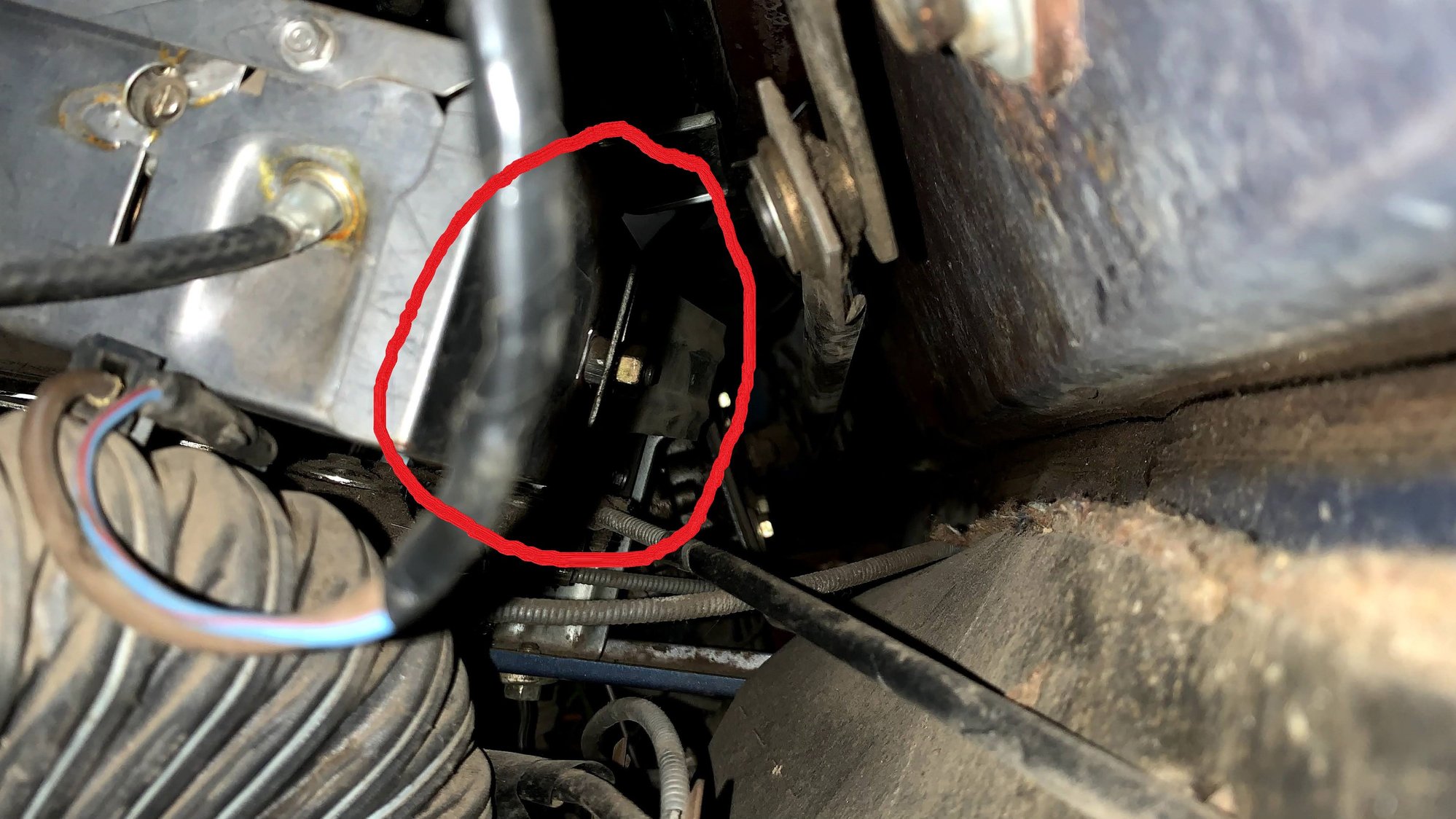

Circled the nut holding in the radio from the back side. Picture was taken through the glove box access.
Radio bolt
Radio bolt
vv OKay thanks
