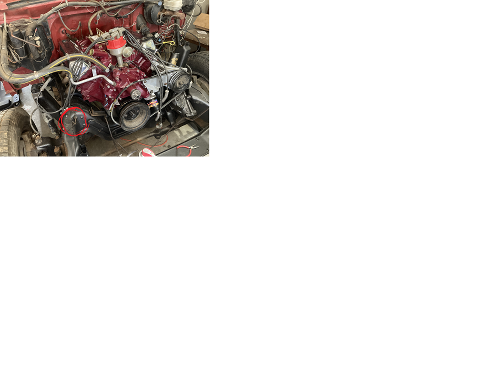

I cant for the life of me figure out what this line goes to, Fuel return?
The Red circle

Fuel vapor pipe. Part of the evaporative emissions system.
Yep. On my 460 a hard line in that area is for the charcoal canister bottom. It turns into rubber and it looks like yours is fit for the rubber also.
Yep. Vapor return to the fuel tank(s).

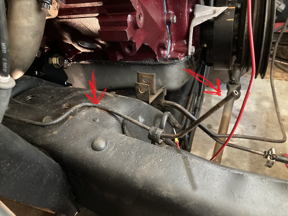

Can I block this?

I would leave it to vent to atmo or hook back to stock if emissions are a concern. Unsure how plugging it would make the fuel tanks pressurized or not.

so you think i can just leave it as is? Thanks!

Originally Posted by vaellene
Can I block this?
No. There is no reason not to reconnect the charcoal canister.
I needs to be hooked up the way it was. Leaving it open will allow fuel vapors to vent into the engine compartment so the truck will smell like gas.

Why would you want to bypass or cap it in the first place? It literally has zero effect on engine performance. Capping it will cause pressure buildup in the tanks, that is going to make it difficult to fill. Leaving it venting to atmosphere is just lazy, potentially environmentally irresponsible, and will make the engine bay smell like fuel constantly.

I was told by a friend to just cap it. This engine has no EGR so Im assuming this is some how connected to that?

Vented gas cap?
It has nothing to do with the EGR.

Containing fuel vapors so they don’t vent into the atmosphere has absolutely nothing to do with recirculating exhaust gas back into the combustion chamber to reduce emissions.
