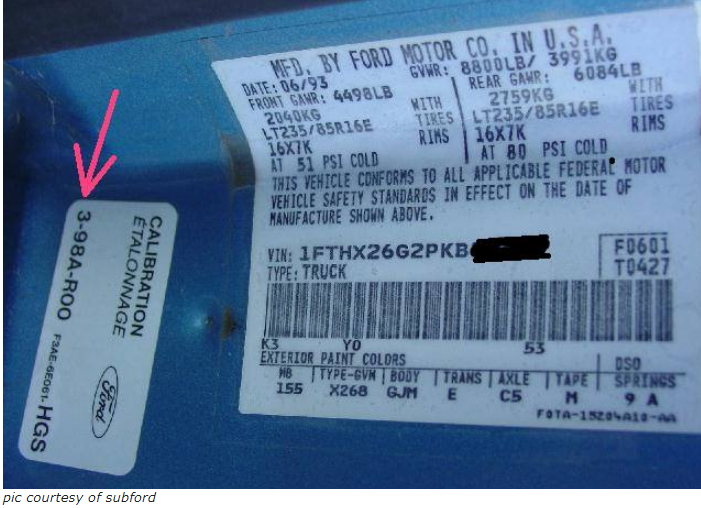

Well at least, you have an idea, this could help fix more issues, your driver door b-pillar, has calibration code, and that tells what PCM you need, and it is an exact fit, post your calibration code and our Guru's can assure you get correct PCM, and if you tried to go by the code on PCM, your not assured that is an original, one in truck, it is an assumption, I would at least check harness wires for shorts, just to make sure the new PCM doesn't get fried.

You need a 1994 or later PCM that will also run an E4OD and is OBD-I. 1994 and later trucks the computer (PCM) also controls the ignition dwell. 1993 and earlier trucks the Ignition Control Module (ICM) controls that function without computer interaction.

I called Autozone and gave them the middle number on the left on the computer's label. He said he could get me one within 3 days and I'll have to tell him my mileage (I hooked the computer back up temporarily to take a picture of my odometer) and vin number then I can get it when it's in. He said $220 with a 50 dollar core charge. I did try to find somewhere local that sells capacitors but I had no luck. I was going to attempt to fix it. I mean is it even worth fixing? Two are broken and the one closest to the computers case wall is the worst and left a burn mark on the cover. That same one burned through to the other side a little bit. I don't have a picture of that but if you guys want to see the other side then I'll gladly show you.
A friend of mine sent me this link:
https://www.solopcms.com/1994-ford-f...ngine-computer
That same friend said I will need to use the code on the right of the PCM: TAG0

Sorry to see your PCM is most likely toast. I was sincerely hoping that was not as bad as it appears. If you gave the Autozone counter jockey only the 12A650 engineering number you will most likely get the wrong computer. That base number is common to thousands of PCM versions. They need F4TF-ZA to cross reference. Perhaps with the VIN they may be able to source the correct version. Do not hold your breath. Hold on to your core for as long as you can.
