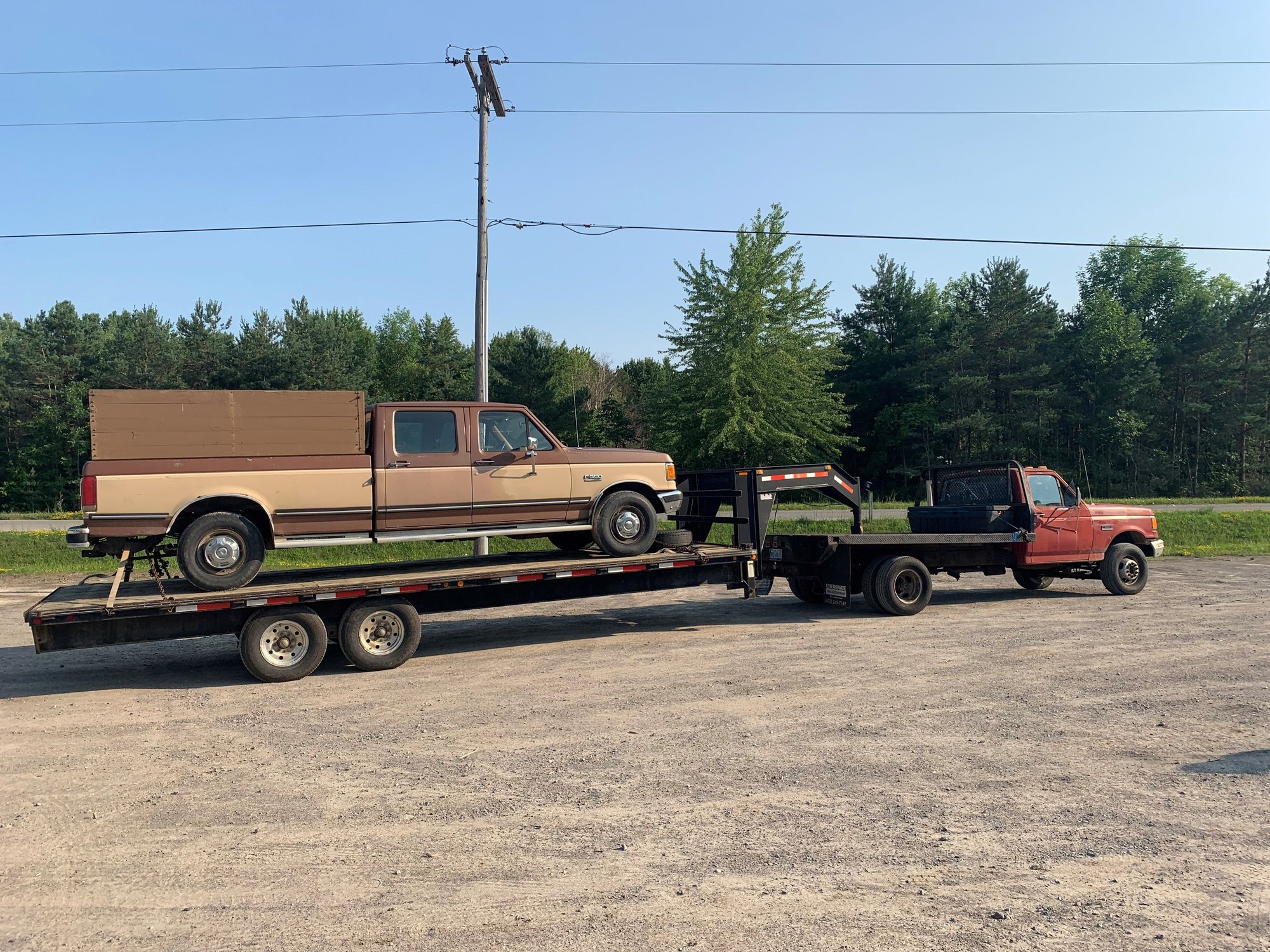

Finally had a chance to retrieve the 1989 F350 5.8 with the blown head gasket. Did pick up something a little newer (1991 F Super Duty 7.3) to use until I decide what to do with the F350. Then, the Super Duty cracked an injector line on the way. Limped it home; now I have two projects. It was a beautiful day for a drive in north central Michigan.
Want to get the F350 back on the road, but the gas mileage is horrible (5.8 - C6 automatic - 4:10 rear axle). Would like to set it up for light duty work (mostly light hauling, occasional short pulls of a tri-axle 16' flatbed with 3-6,000 pounds of tractors on it). In addition to the current components, I have access to a 4.9 six, ZF5 transmission, and a full floating 3.55 limited slip rear axle. Don't know yet if the ZF5 is a close or wide ratio, but I'm hoping it's the wide. I'm leaning toward the 4.9, ZF5, and 4:10; does anyone have any suggestions?
This picture looks like it came straight out of the 80's or 90's.
