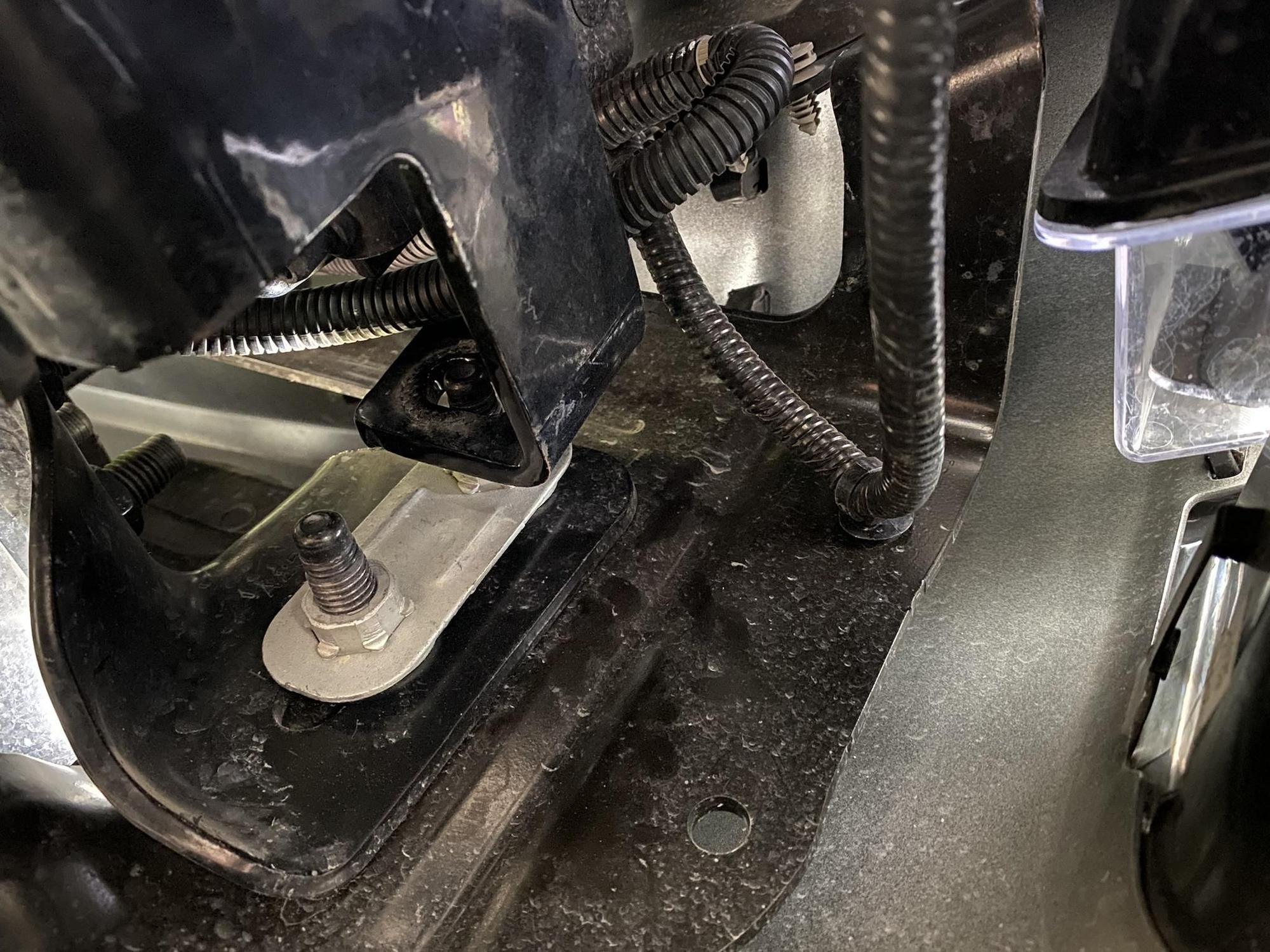

I’m installing a Ranch Hand Legend grille guard on my 2020 F250 but think I have the wrong set of bolts. If someone has one installed, would they mind posting a picture of the bottom brackets and how they connect to the front guard brackets through the tow hooks?
Mine currently don’t go through the existing spacer and if I remove it, there is a big gap. Just trying to see if that’s normal. Thanks.

Thanks for responding. The silver bracket is the spacer that my 1/2” bolts won’t thread through. In the picture is the stock bolts not feeding through the ranch hand bracket to secure it to the guard.
If I remove the silver bracket for the 1/2” bolts there’s a large gap between the two brackets.

Thank you for responding. The issue is actually on Step 6&7 The 1/2” bolts won’t feed through the silver bracket so it would have to be removed. I can install it without the bracket but the space doesn’t look right from a structural standpoint.

here's what mine looks like
First picture is the area behind the tow hooks
Second picture is the area next to the tow hooks where you use the new bolts supplied with the guard
Here is a picture of the lower brace
The bracket you're trying to fit over the tow hook bolts does not belong in the spot from what I can see.

THANK YOU! That’s exactly what I needed to see. Looks like all I need to do is loosen the lower bracket bolts, remove the silver bracket, and angle the lower brackets towards the front of the truck. I really appreciate the detailed pics!
