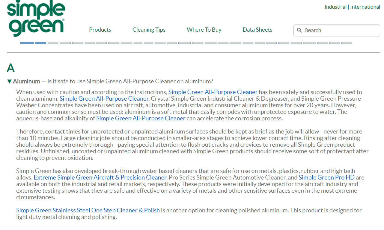

I started using Simple Green after I saw the aircraft maintenance crews were using it to clean everything from an F-16 to a KC-135. The maintenance crews had to comply with local and federal water runoff laws and Simple Green is not harmful to the environment. This was important to me as each time I wash a vehicle, there is a good chance the water runoff ends up in the pond. I have been using Simple Green for many years and never had a problem.
That said, this is what the Simple Green website says about aluminum.
Image source: https://simplegreen.com/faqs/15/

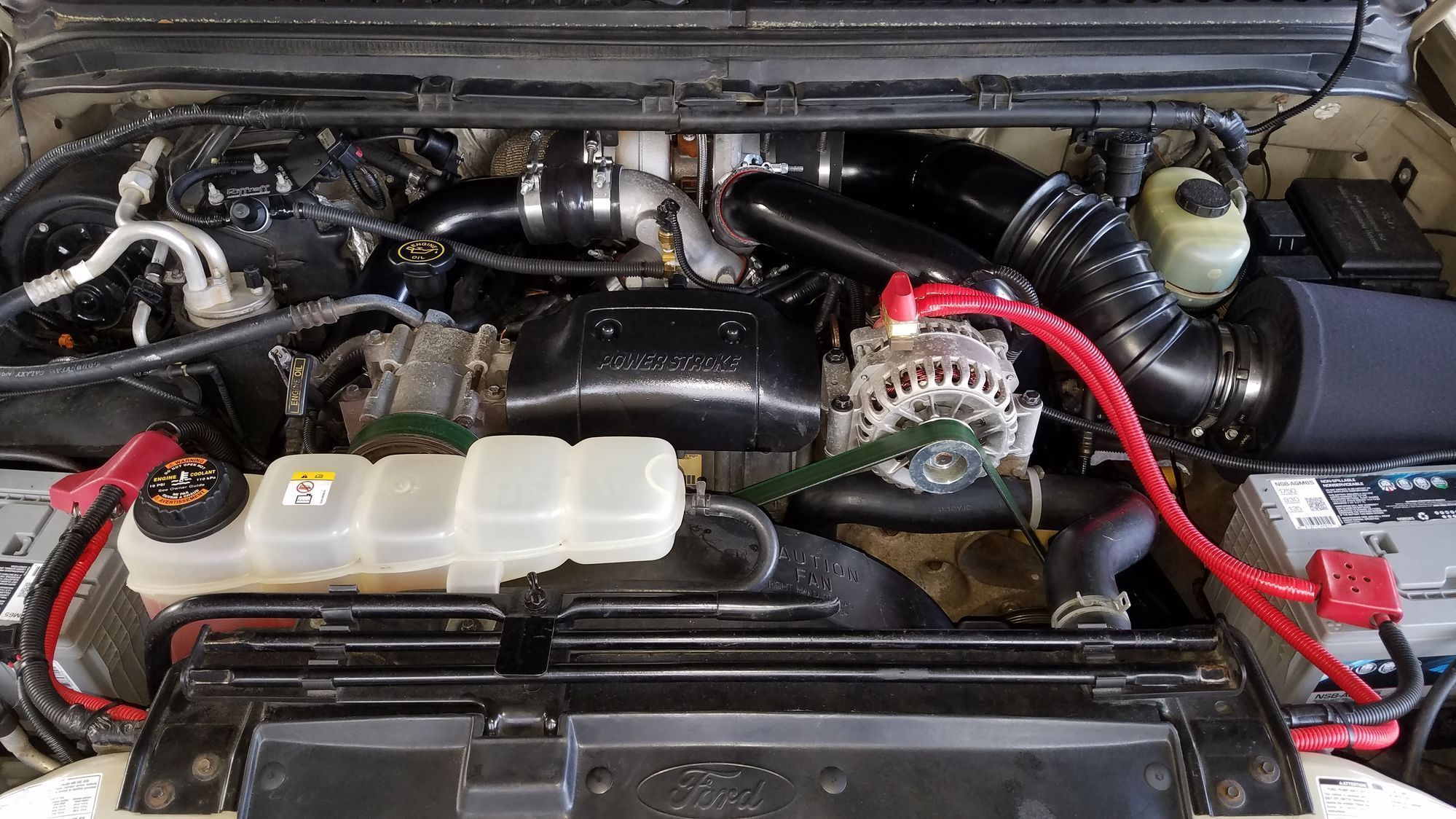

This is my engine bay after a Simple Green bath and a good rinse. I have heard good things about Purple Power as well and it is also biodegradable. I may give that a shot soon...

Thanks Sous! I will be sure to keep exposure to less than 5 minutes, just a quick spray and rinse to get antifreeze and light grime off before replacing the radiator. BTW - that was the original radiator and it is no wonder she failed. All the fins were completely filled with 20 years of dirt, and various unknown things that got sucked through the AC and charge air coolers. Surprisingly those 2 had only a bit of light dust when I blew them out.
