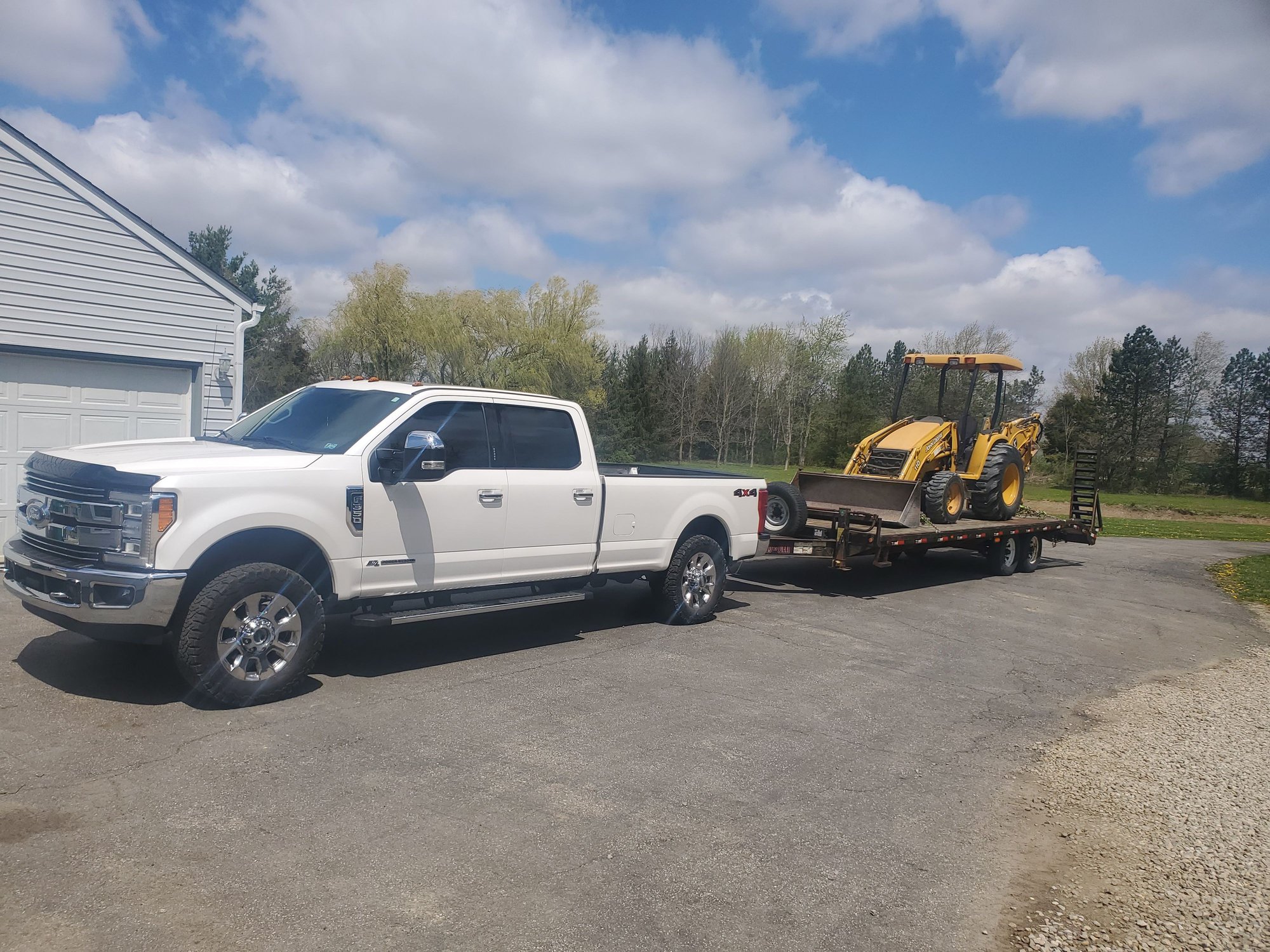

Here is a pic of my truck (not that it matters)
