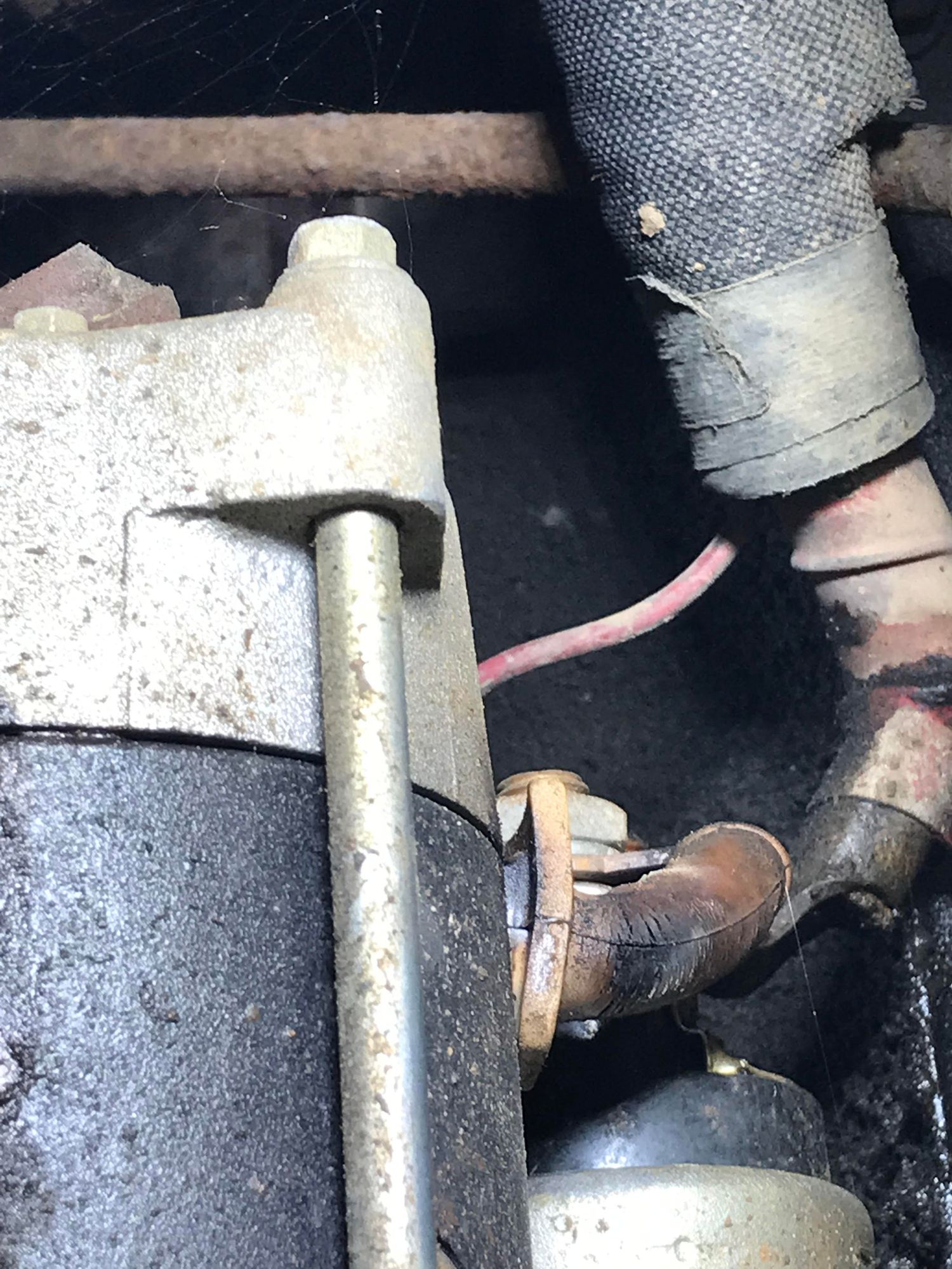

After looking for the right truck for a while, I bought a 2001 F250 with a 7.3 and 6 speed manual transmission in March. This truck will be my weekend truck, as I have a 2016 F150 as my daily driver. I've not driven it much since I bought it, as I've been fixing a few things on it. I've been soaking up information from this site and found you guys to be a great group of guys who really like helping each other out. I've learned a lot by reading many of the posts, and you've helped me fix a few things already. I still have a few things on it left to fix, but a new problem developed this morning. I started it up this morning and was going to try to troubleshoot the AC vent problem (only blows air out of the passenger vent near the door) and I opened up the glove box and was feeling around behind it when the truck suddenly cut off. I then smelled wires burning and reached over and turned the switch off. I popped the hood and felt the alternator and it was too hot to touch. The engine had been running no more than 5 minutes before it cut off. I tried to crank the engine over and nothing happened. I got under to look at the starter, and as I was getting under and before I saw anything, I smelled the burned wire smell and it was much stronger. I found that the wire from the bottom of the starter (perhaps the bendix?) that went to one of the terminals at the top of the starter, was burned. See attached photo.
The starter was too hot to touch, even about 20-30 minutes later when I disconnected the battery wire. I was going to remove the starter then but it was too hot, and I decided to let it cool down. I got busy on another project and never got back to it today. I'm assuming the starter is toast and I'll need to replace it. Could the problem be something other than the starter? What would cause the engine to stop if it were the starter? Thanks in advance.

Hot starter after a few minutes of running, burned wiring at starter, and stalling says to me that your starter pinion never disengaged from the flywheel. Starters don't like spinning that fast for long and the bushings in them will seize. They also make one hell of a generator and can induce too much REVERSE voltage into the system and overpower the alternator (probably why it was super hot too). My guess is the voltage dropped below 10 or so volts and the IDM quit activating the injectors.

I pulled the starter this evening and the top bolt was loose (starter only has two mount bolts). It was not the original starter as it had a NAPA sticker on it. When I went to wipe the grease and oil off of the label to read it better, all of the writing wiped away, so now I can't read the model number or anything. I unhooked the wire from the starter to the solenoid and placed positive jumper cable on the wire going to the starter and grounded the negative cable to the starter housing and all I got was arcing, so it looks like it got so hot it shorted the cable. What recommendations do you have for a replacement starter manufacturer. I usually like Motorcraft parts but wondering if something might work as well for a little less. I already saw how the NAPA starter worked.
