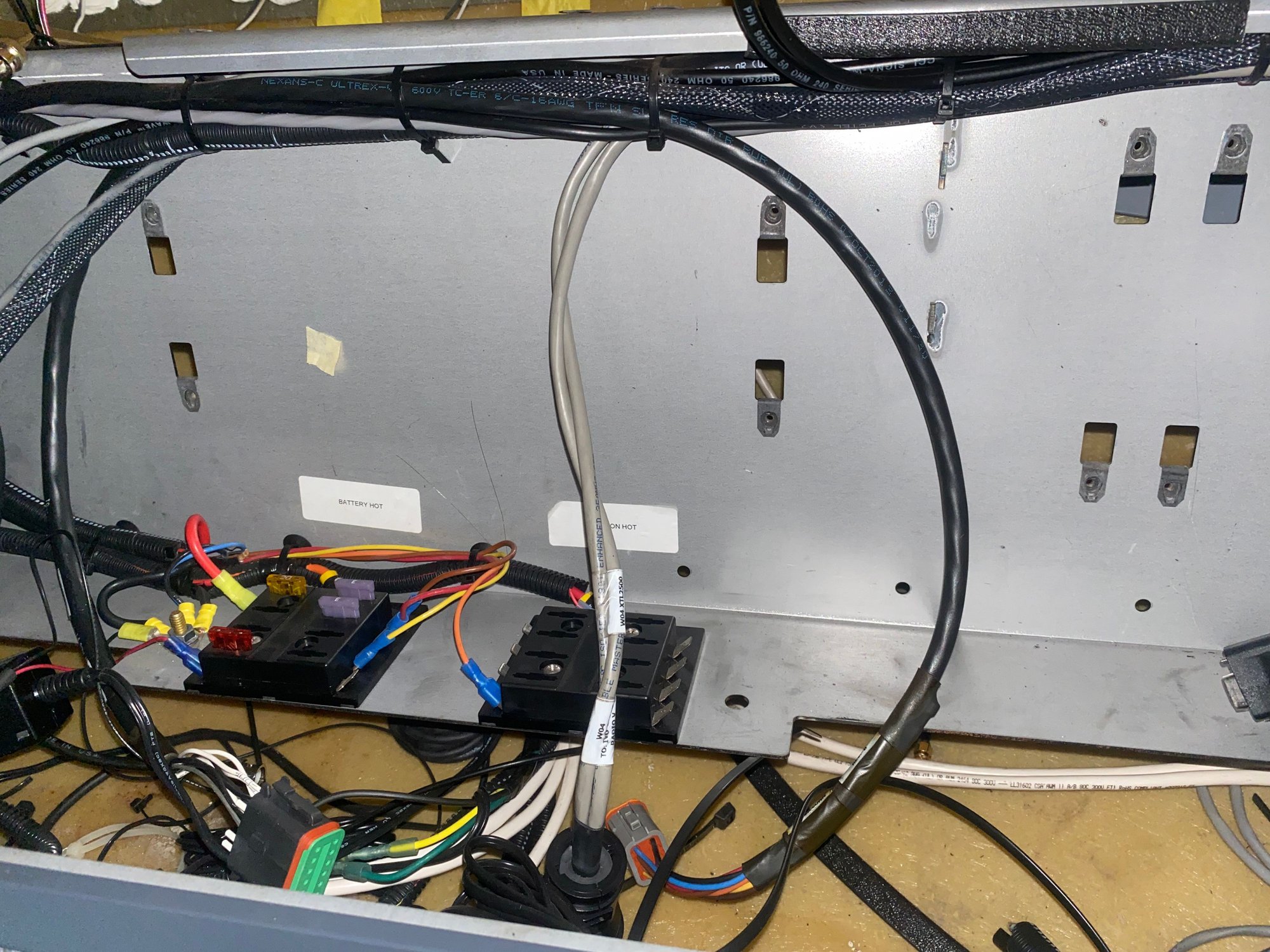

I bought this 2014 Ford E-350 Cutaway shuttle bus, my intention is to turn it into a mobile home, the vehicle was bought at auction, it was used as public transportation in Pennsylvania, it had a security camera system of which only the cables remain, it has two batteries and many other accessories that are not used.
I would like to know, can an inverter be installed? I would like the additional batteries that I am going to install to charge with the alternator, could I install it in the second battery? or do I need to install it on the main battery? Would you need to use an isolator? Or having two batteries already has it installed from the factory? By having two batteries would it be 12 or 24 volts? Does anyone know of an electrical diagram?
Can someone please help me ? It's my first Ford vehicle and I don't know anything about them
2014 Ford E350 cutaway
A/c unit
Lot of cables ! Can I eliminate them?
What is this ?
What’s the function?
CCTV cables can o take it out ?
What is this ? Can I eliminate it ?
Not use
Not doing nothing when I press it

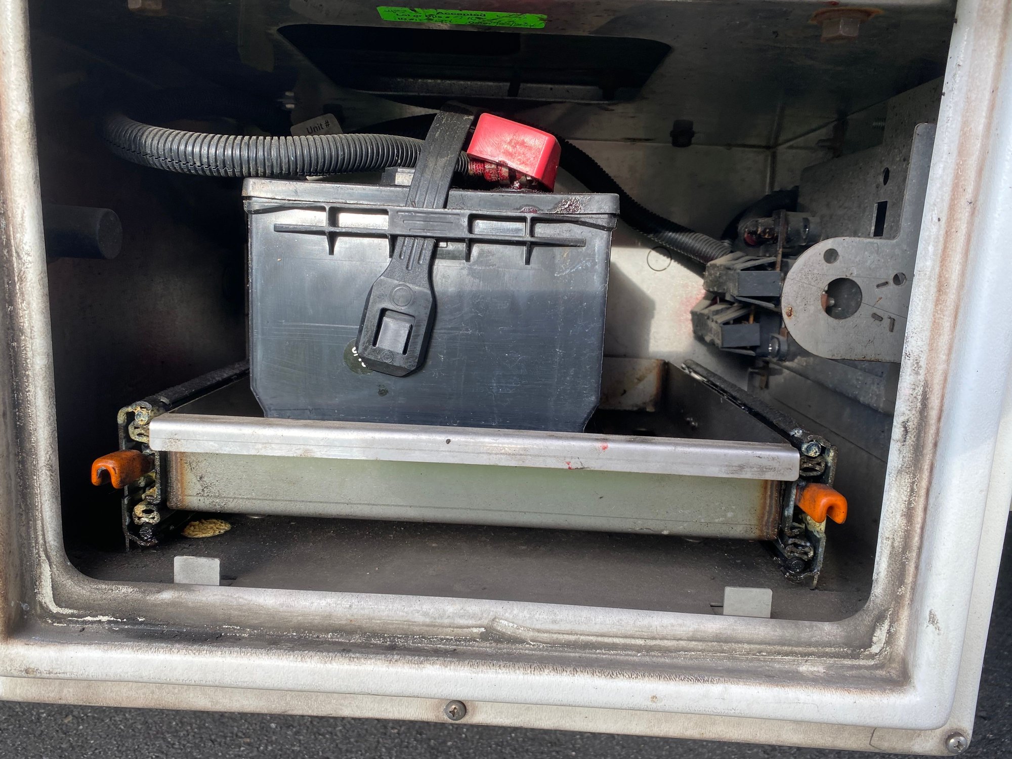

Main battery
What’s for ? Can I start my inverter installation from here ? Do I need to use an isolator ?
