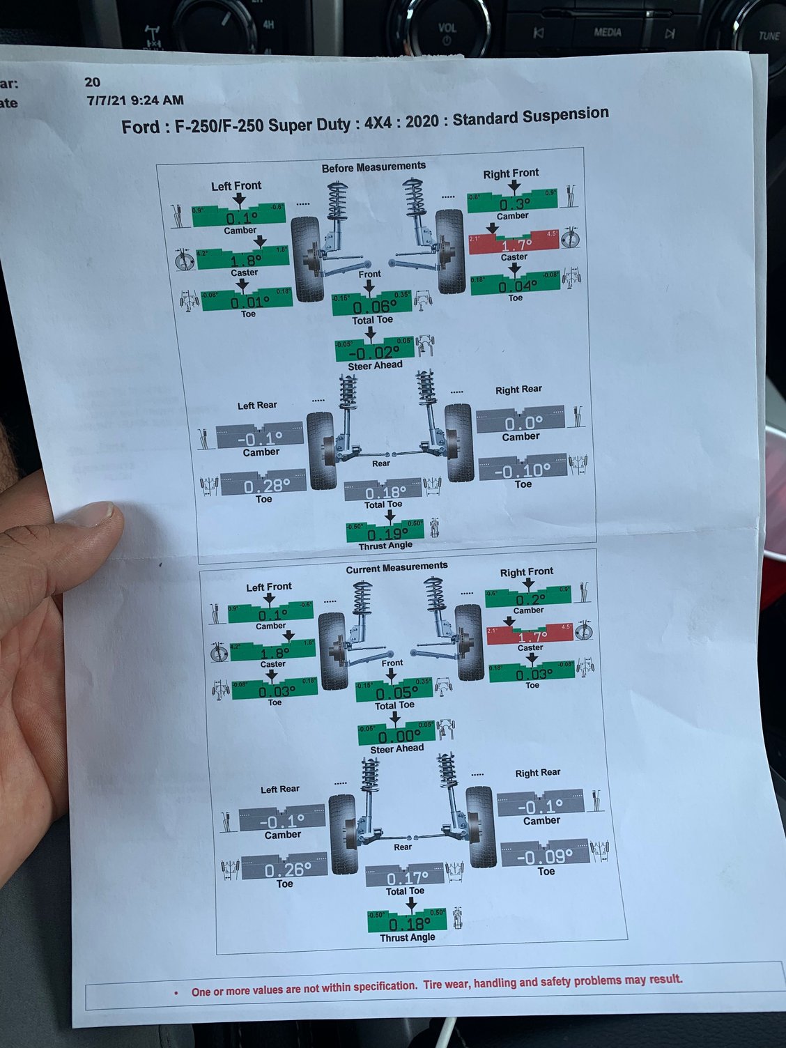

I don’t like these results
2021 truck with a 2” BDS level (lower spacer)
Used the 2.5° caster shims that came with the bds kit
was hoping for caster of 4° give or take when I got it back
they said it’s all they could do….so with a 2” level and 2.5° shims does that sound like BS?
what has to be done to get a little more caster?

In fact when you look at the numbers I wonder what they did at all. Nothing really changed?
Looks like all they did was even out your toe settings, which is nice but... The caster didn't change. They clearly made no attempt to alter the setting. You know the amount of work it is to get to the caster bushing, pretty sure you have to remove the wheels to do it. They just did a basic "set the toe" alignment which is typically the only adjustment ever made on these trucks, that and the drag link to center the steering wheel. These are easily done on the rack, wheels on. The tech may not even know how to do the caster on a Dana axle...
Good Luck
before I start adding drop brackets and other fixes I want a proper adjustment of the caster how my truck sits to see if I can get to an acceptable number.
the truck doesn’t drive horribly (unloaded) on my trip home but who knows loaded how it’ll do down the line with more front end wear and tear.
I feel like more caster is in order so hopefully a tech that knows what he’s doing can get me a little better….
antone know of any food places to take thing thing for a proper alignment around Md/Dc/Va?

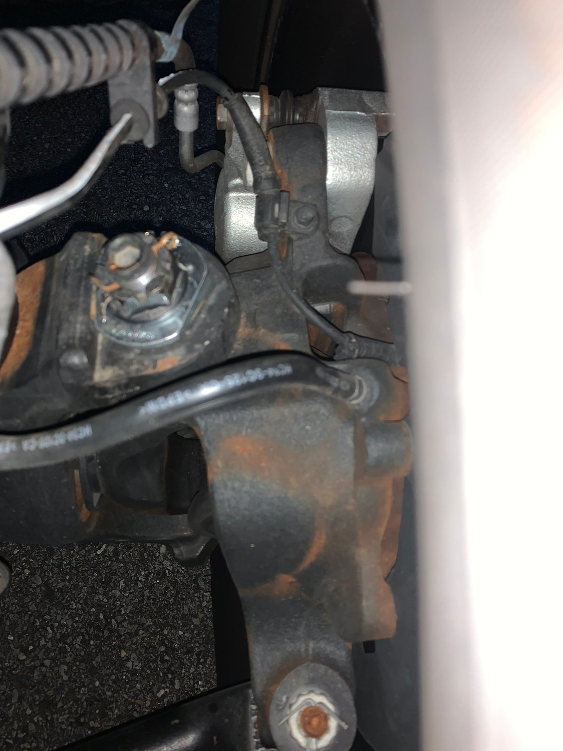

Are you sure you installed the caster shims facing the right direction?
Old Jul 7, 2021 | 07:26 PM
Rwhjr's Avatar
Rwhjr
Joined: Mar 2021
Posts: 2,044
Likes: 1,336
i can certainly check
they had an arrow on them indicating which direction to face them but mistakes do happen 😬
I’ll check and report back
Old Jul 7, 2021 | 07:40 PM
Rwhjr's Avatar
Rwhjr
Joined: Mar 2021
Posts: 2,044
Likes: 1,336
bottom of pic = front of truck FYI
