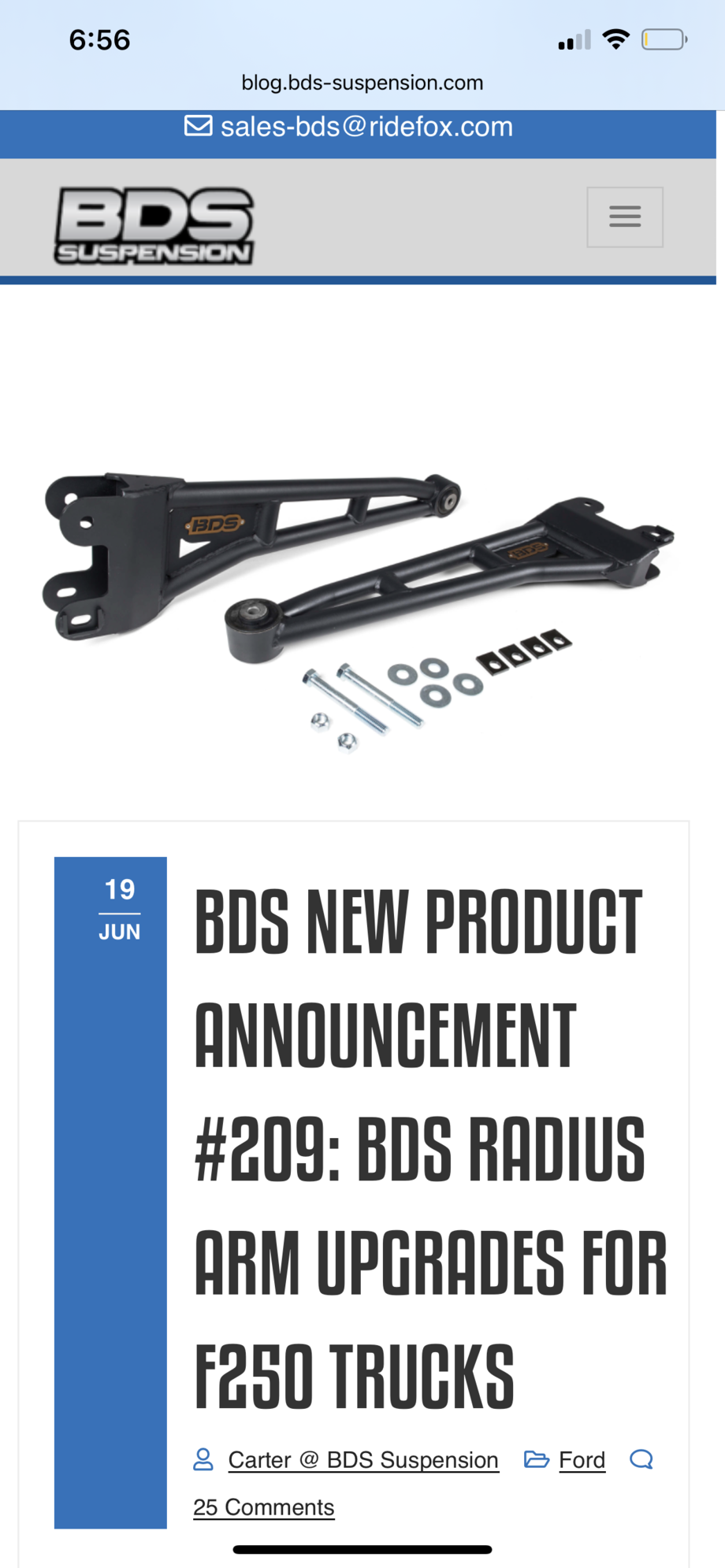

The other option is spending a few hundred more (they run ~$550 for super duties) and going with some BDS radius arms.
here’s a link:
https://blog.bds-suspension.com/?p=9157
I see a couple positives here but they also leave me with a few questions.
1) how much caster do the bds arms correct for on a 2021 truck?
2) says they’re built differently than oem arms and allow a little more tire clearance. That could be a huge plus….think I could fit 37x12.5 on stock wheels without rub using these arms?

That screen shot is from the 2015 product release. They do include those, or similar radius arms, in their radius arm lift kits, but do they also sell them separate? They claim to offer caster correction and they would keep larger tires from rubbing on the radius arms.

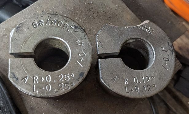

There isn't a lot of caster in these trucks from the factory. The shims you removed should have markings on them. These were mine.
You lose roughly 1° of caster for each inch of lift with the spacer. So if you installed 2.5° shims on a 2" lift you should have ended up with roughly .5° of caster on top of whatever is there with a 0° shim.
In other words, those shims put you back pretty close to stock. The drop brackets are a better solution, especially because they will reduce or eliminate the angle on the coil springs.
