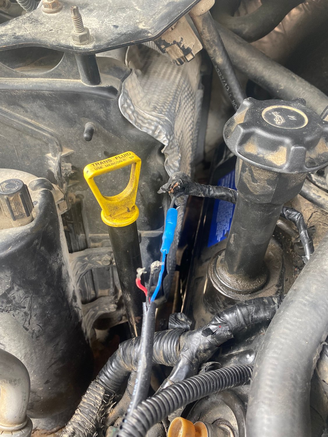

Here is what the pigtail looks like on the ICP. Are those red and black wires important? It almost looks like someone tried to splice them all together but only did the blue wire

What year/engine is this truck? I guess I assumed it was a 6.0 because they are more prone to ICP sensor issues. However, that harness is on the opposite side of the engine from where it is on a 6.0, or at least the two 6.0's I had. If this is a 7.3 I'm not as well versed, my 7.3 ran like a tank.
That said, there were (3) wires that needed to be hooked up on my 6.0's ICP sensor for it to function. With only one wire hooked up you're going to get NO voltage, which will throw a 'low voltage' code. I would suggest replacing the pigtail so all wires are the same length.

alright, just bought the pigtail and it should come by tomorrow. And yes, it’s a 6.0. The odd thing is no oil in the ICP so I’m pretty well certain it’s the wires. I’ll keep y’all updated though. I appreciate the response

ok, so I replaced the pigtail and plugged it in. I turned the key and I didn’t hear the injectors. I thought it was weird but ok, cranked it and it started in about 2 seconds. Initial grey smoke and then some white smoke and then no smoke. All in about 10 seconds. ICP pressure was still reading 870 at idle and a new code popped up. The 2285 disappeared and now it’s a 2289. Any ideas?

The good news is you fixed the low voltage issue by reconnecting the wires.
You're now getting a 'high pressure' code. Did you replace the sensor with a Ford sensor or an aftermarket one? These trucks do NOT like aftermarket sensors at all. I had the same code when I tried to run an aftermarket ICP sensor in my '03 with a tune. Strangely enough, removing the tune got rid of the code.
This could be a bad sensor, it could be a sign of bigger issues. You may want to ask around in the 6.0 forum, as those guys are much more versed in this type of stuff.
