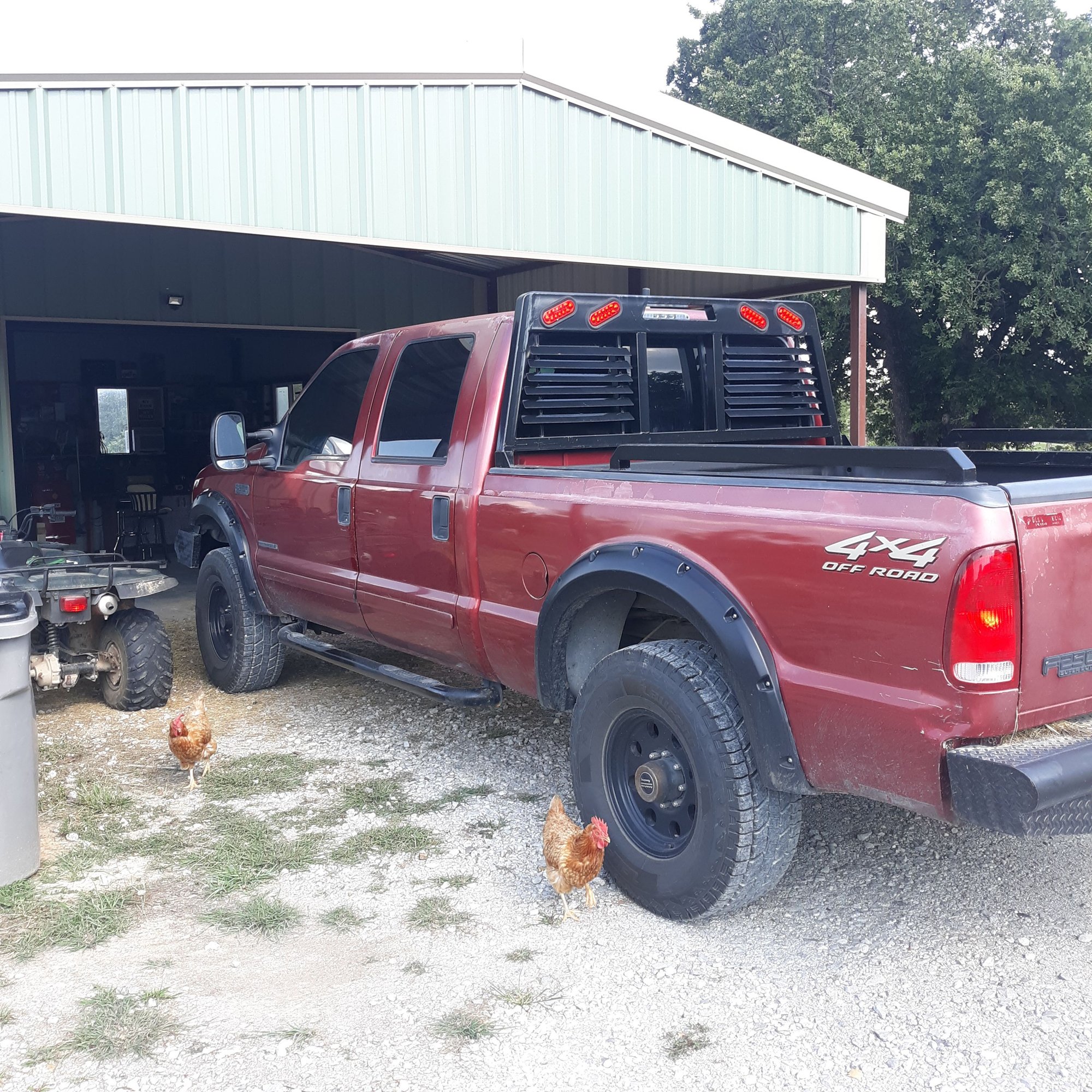

A couple of pics of Bertha. As the saying goes, She ain't much, but she's all I got!"

She looks great! Like the bumpers. And the headache rack. And the painted side steps.

I think it's a good looking rig. Like the bumpers, fender flares, and other add ons. Drive it, enjoy it.
