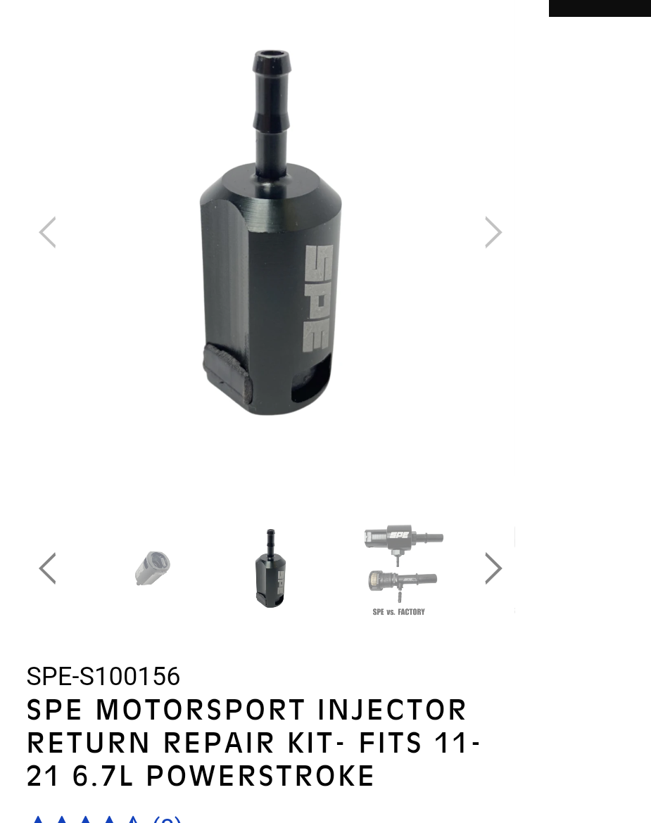

I know problems happen but I have not had a problem with my 16 in 78k miles. Just did a fuel filter set change. The potential problem is with the one fitting that has the plastic tee nozzle on it on my my truck (for 11 to 16s). Ford could have solved that problem with having that part made in metal but I get it... Adds cost to the truck.
I admit to liking those filter kits but what sucks is you still have to pay for the OEM filter set and spend extra money on another filter for the aftermarket kit.
I'm going to be ordering SPEs machined fitting to have if the fitting breaks one day. You can source the OEM fitting itself but why replace it with a part that may just break again as it gets brittle from the heat under the hood again.
https://www.spemotorsport.com/collec...7l-powerstroke
I know Fritz had issues with ordering from SPE themselves but when I order the parts, I'm going to order from @Bitterroot Diesel as I ordered my S&S DPK kit from him and had great service. I'll give a small business and a member here my support.
the spe return repair can not be used to fix the CAT 2 micron hose keeps blowing off on the 2 micron manifold problem.
use the fitting I posted on the 2 micron manifold if your hose keeps blowing off.
I'm talking it's use for my truck. I'm buying the SPE fitting to have as a spare for the OEM fuel fitting that has that potential problem tee fitting that points down which on the 17s plus it's a separate and third fitting on the OEM under hood filter. If you still have the OEM under hood filter, you could replace the plastic fuel fitting with this:
I was going to put the 2 micron cat in front of the afe pump but….with 10 micron in the tank….4 micron afe water air sep…2 micron engine bay…and 2 micron s&s return…I think I have all the bases covered. Will probally use the 2 micron cat on my generator .
Copy that... so you could, if you have the stock set up and if you wanted to, use that SPE fitting under the hood.
I just like that it's aluminum and won't break. But I won't switch out until it breaks or something happens with the stock fitting.
