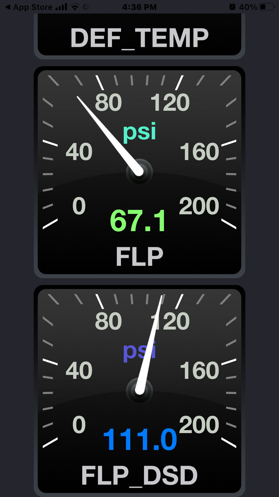

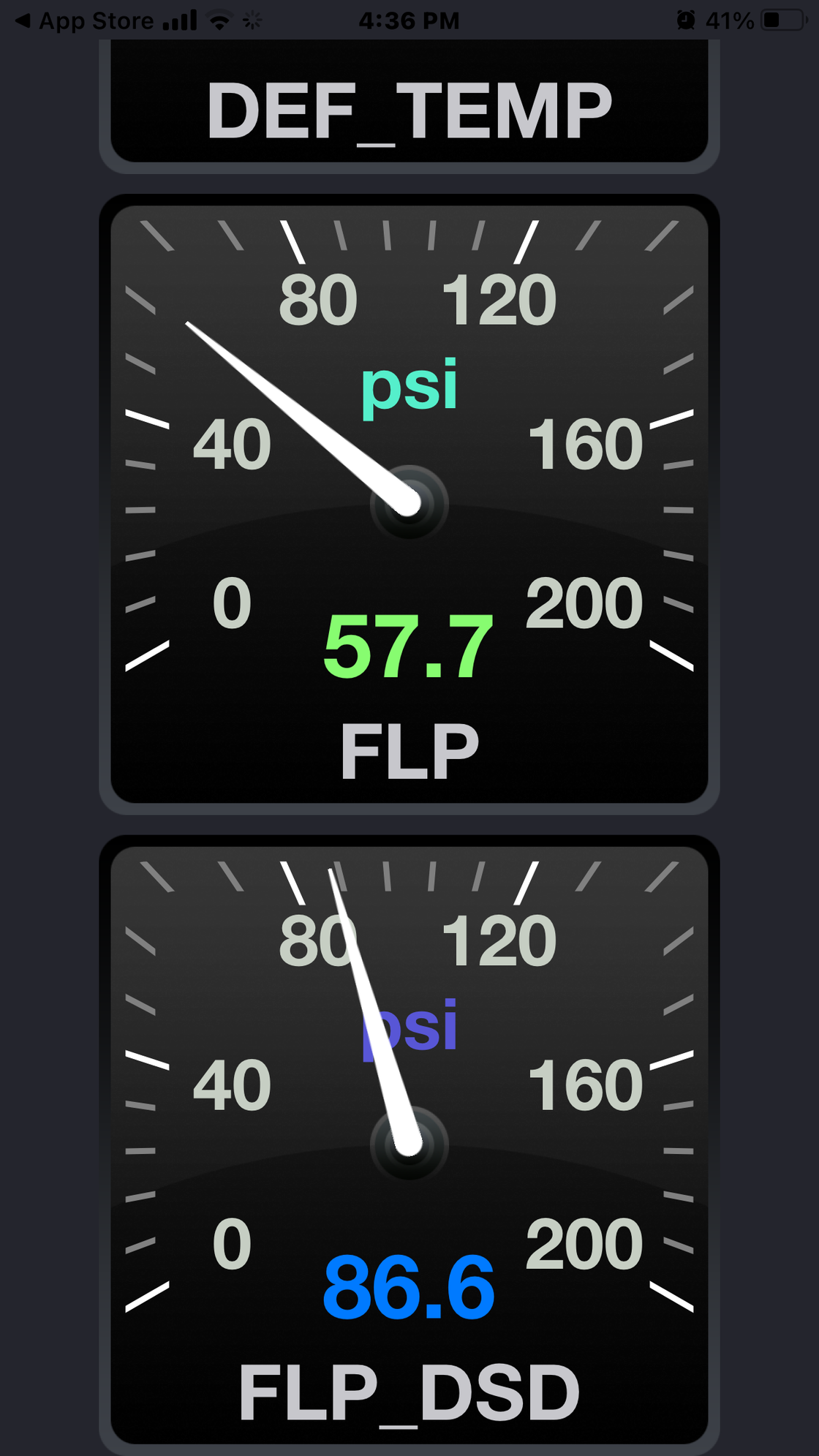

What I learned about the oem fuel filter junction is that the return is connected to the cp4 chasis, the injector return, the fuel filter, and goes back to the tank.
the problem I have is the oem return line is a 50 psi rated line.
I don’t know exactly what the pressure is in the line…but…with a stock setup the psi after the filter is mid 50’s. With this 2 micron filter, the psi is mid 60’s..
Old Jul 6, 2021 | 04:13 PM
  #30
speakerfritz's Avatar
speakerfritz
Joined: Jul 2013
Posts: 14,266
Likes: 2,187
I did find a longer barb fitting and received it today.
what I couldn’t find was a 75 psi 3/16th fuel line.
so I decided to roll this back.
ny plan now is to use this 2 micron filter under the cab next to the chasis mounted lift pump I am waiting on.
it would be an easy add on, and I can drop the return fitting and make the filter pass thru.
this would keep the pressures in the engine bay normal.
