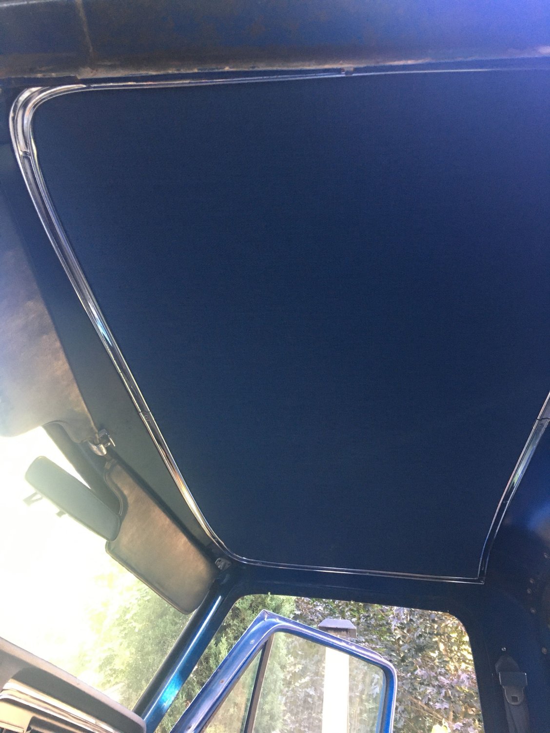

The old headliner was pretty shot. So after matching the fabric from samples that one of the seat cover companies provided I built the headline so it would match the seat upholstery when I get that done. I think it turned out pretty well for my first go around.
Now my visors are looking kinda crumby though.

Nice job, you got the headliner done, now tackle them visors. https://www.ford-trucks.com/forums/1...ors-ideas.html

Oh yeah, that's really nice!

Looks pretty good. that fabric looks real close in color and type to the Cartouche seat upholstery I just bought.

It matches the samples exactly of Stock Interiors and Raybuck. This material is called DURAMAX it's a tweed weave made from a material called polyolefin.

Looks awesome! What did you use as a base? Did you insulate the roof while at it?

Thanks, I just used a hardboard panel from orange box store. One face was white (vinyl paint I think). Other than a layer of Killmat I did not insulate. There is a 1/4" layer of "headliner foam" between the hardboard and the fabric. The Killmat isn't really thermal insulation but we had some really hot days recently and it seemed like it was blocking a decent amount of heat. I did buy a roll of that Mylar bubble wrap stuff and might still put it in.
