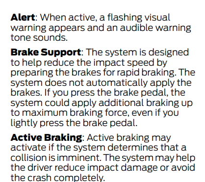

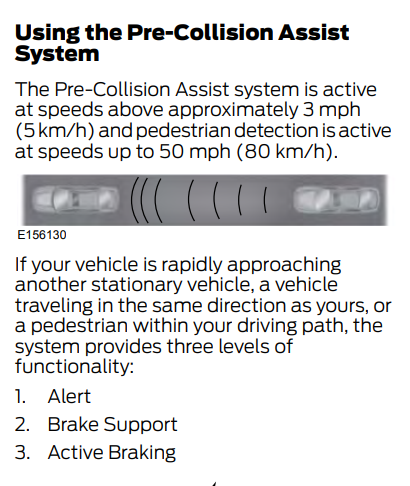

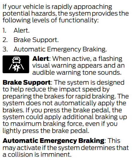

Originally Posted by SARDiverDan
It does not stop for you. All the system does is preload the brakes so they respond quicker. It does not apply the brakes for you if you are too close to something.
Originally Posted by Ltngdrvr
According to Ford, it does apply the brakes if you don't.
This is from the owners manual
The brake support system assists the driver in reducing the collision speed by charging the brakes. If the risk of collision further increases after the warning light illuminates, the brake support prepares the brake system for rapid braking. This may be apparent to the driver. Brake support does not automatically apply the brakes. If you press the brake pedal, the system could apply additional braking up to maximum braking force, even if you lightly press the brake pedal.
My 2020 and my 2022 will stop the vehicle if you don't.
From the 2022 manual:
The 2020 manual calls it Active Braking:
