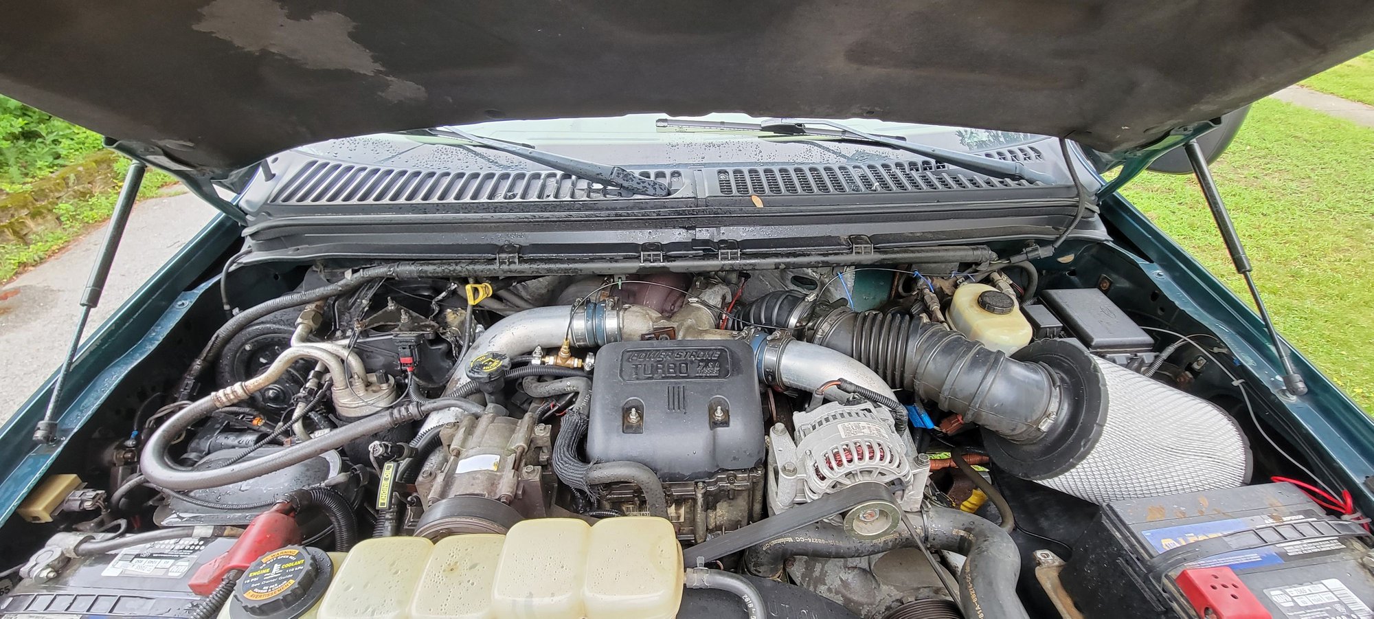

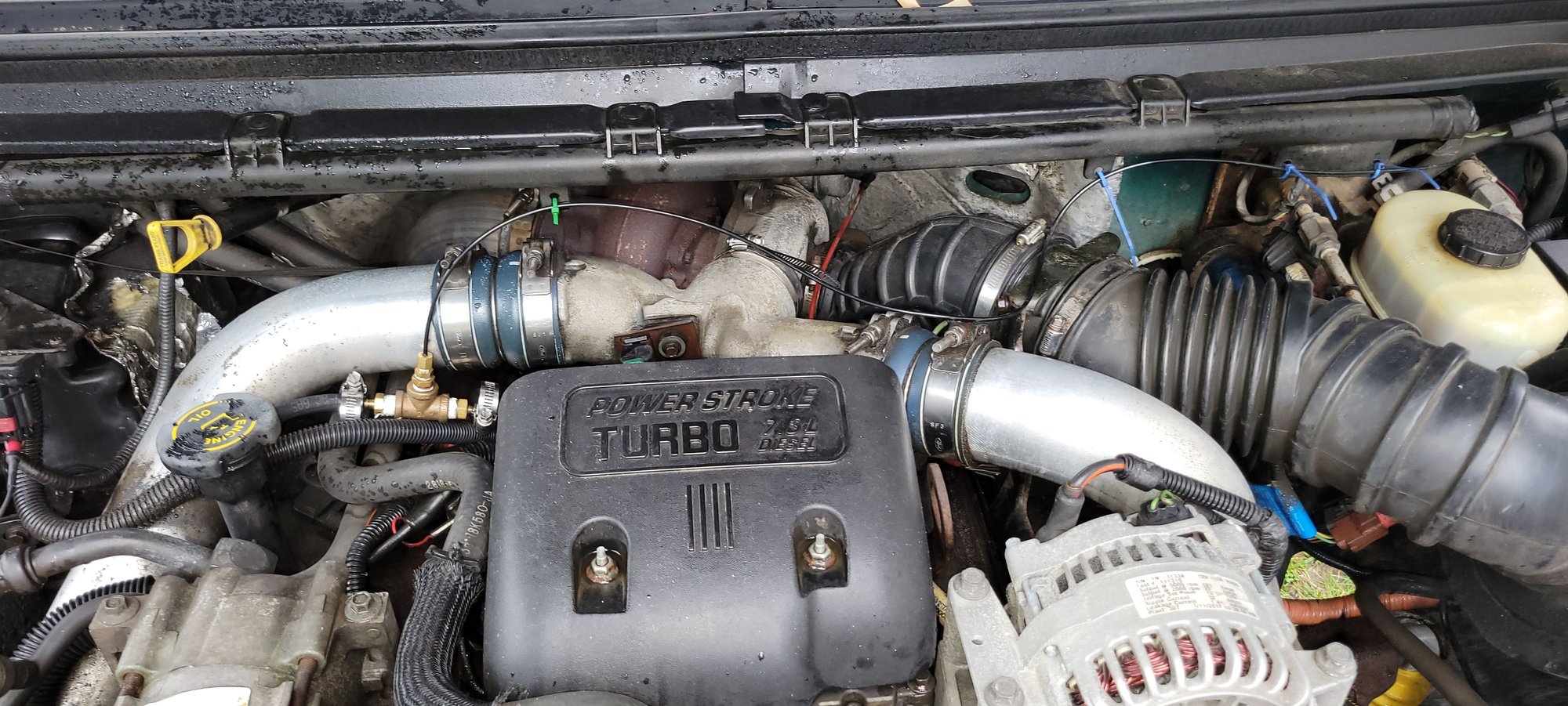

Get your cell back in there and get pics of the up pipes where they enter the collector. And the firewall in the area. If they are OEM it's almost a given they are leaking, but confirmation makes it easier to spend the coin.
Also get a general pic of the engine bay so we can look it over, maybe spot something.

I could only get a picture of one up pipe but they look really good, it was lightly raining out and I was driving around so its a little wet
