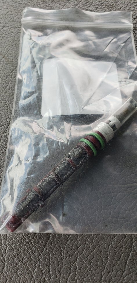

Originally Posted by Rex3
Pulled the orifice tube out it was pretty dirty. I will be changing condensor tomorrow. The guy helping me wiped most of the crud off but here is what it looked like. And yes I may have not used the correct thermometer to take my readings, that is why I turned to this group for help and education.
this
It's a good idea to replace it but that wasn't your issue. You had good pressures on the gauges you pictured. If this would have been a issue those pressures would have been out of wack. Save your money as the condenser isn't the issue either.
You say you have a guy that can charge the system, have him recapture the freon and reinstall using a set of scales to make sure the charge is correct. If he doesn't have scales or a way to measure the freon charge then find another buddy that does.
