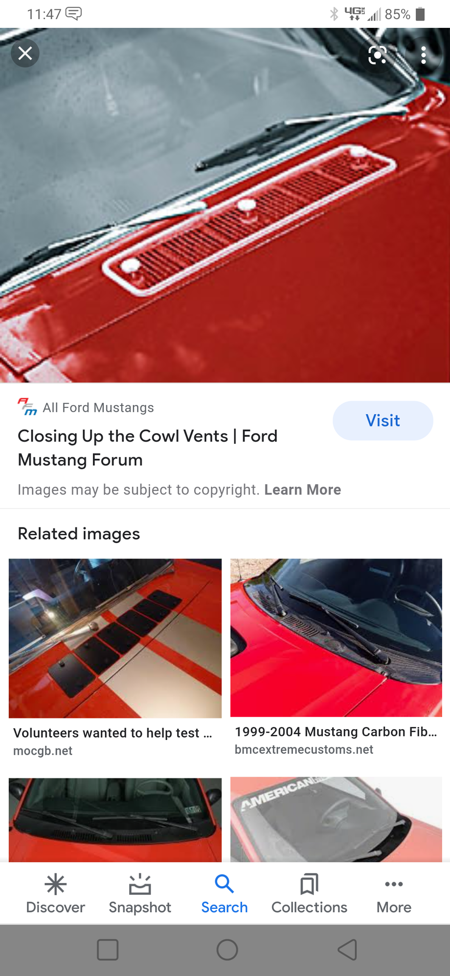

That reminds me of something. 25 year ago I had a 65 mustang and someone makes a lexan cover for the cowl. To block it off. I'll see if I can find a picture of one

Heres one. They have thumb screw ***** with spring and t on bottom. Put over push down and turn 90* to hold in place gasket seals it off
Would need to get creative to make one for truck but it can be done or maybe someone already makes some

Thanks for all the info 77. I had not thought of and external lid. I had thought of running some ducts under the hood to the grill but that would look bad when looking under the hood. Once again thanks for the pics and ideas. I will look into it further
