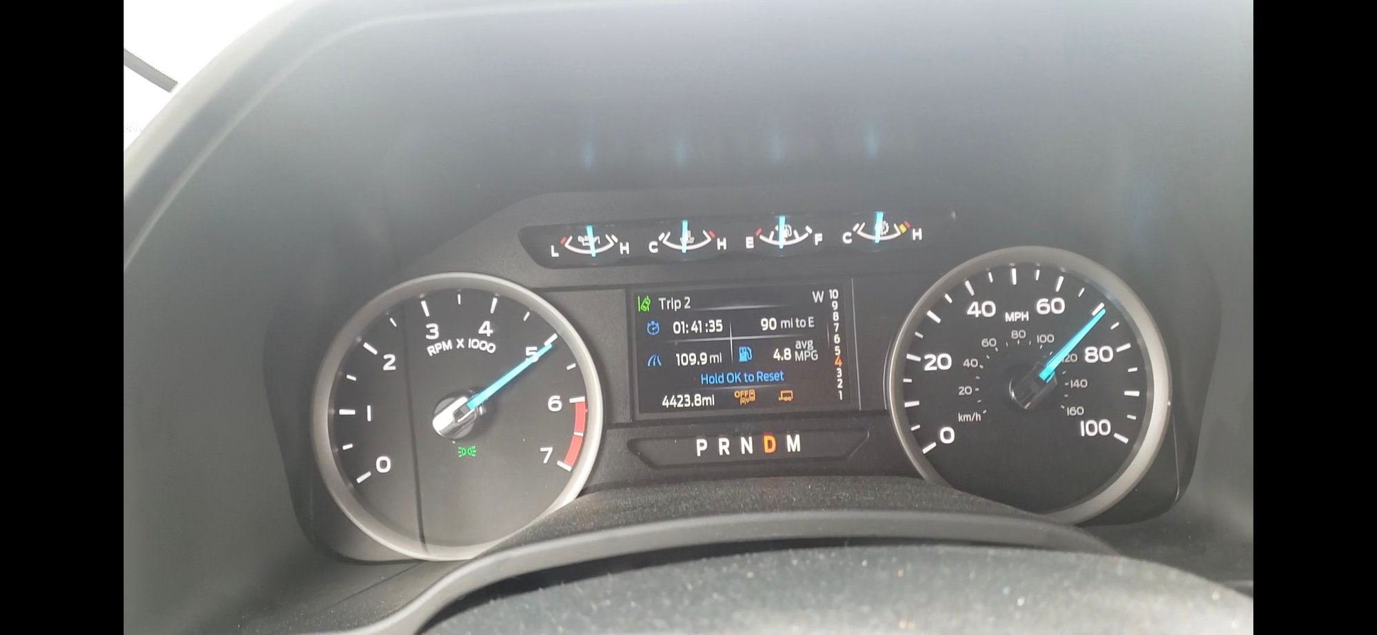

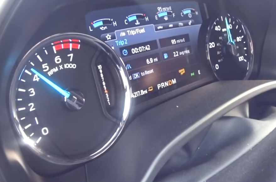

Like I've said many times, you can graph things all you want, but they do not apply to the real world. No one, but maybe the top 1%, is going to hit 5,000rpm while towing. Heck, the truck won't let you. I tow 12k in the Appalachian mountains and I don't think I've ever gone over 3500. TFL towed 16k up the Ike gauntlet at 4200rpm. (pic below)
Moving the goal posts. You conveniently picked a <1% scenario that would benefit your argument by using redline to limit results. And because you are artificially limiting RPM's to redline, means you just lost the argument. Why do we have to downshift all the way to redline? (hint: because it's the only way your graph works to suggest 3.73's are 'better').

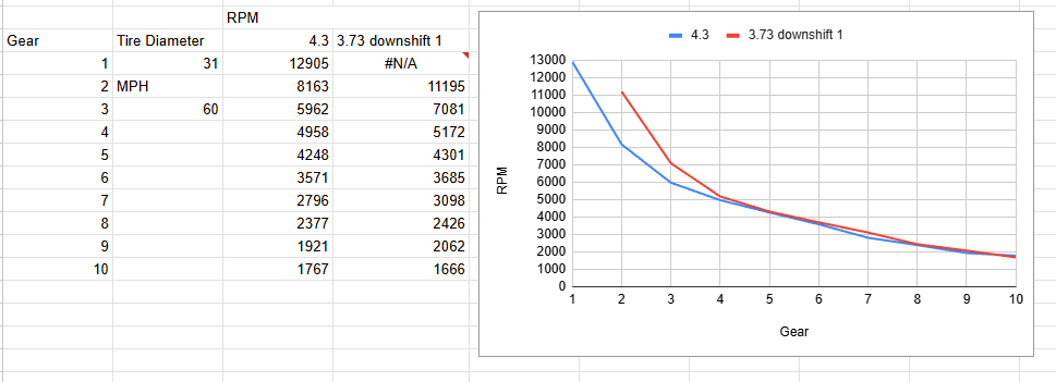

No, dude. You said "The truck with the 4.30 can downshift too". Yeah, and the 3.73 can downshift *again*. Since you were taking the "I can just downshift too" argument I was following that through to its logical conclusion. You can downshift again and again and the 3.73 can follow you down the gears again and again, but there's a limit to how far you can take that. The limit is where you run out of RPM, and the 3.73 truck sticks with the 4.30 all the way from 10th/9th at 1,700 RPM through to the RPM limit in 5th/4th at 5,000 RPM.
The 5k RPM has nothing to do with it. Redline has nothing to do with it. It's not a <1% scenario and that scenario isn't any different than any other scenario. You like 3500 RPM, great look at 3500 RPM. Don't even need a different chart. The 4.30 truck is in 6th at 3,571 and the 3.73 truck is in 5th at 3,685, both going 60mph. RPM is within 100, negligible. You prefer to tow at 2,000 RPM, great you can still use the same chart. The 4.30 truck is in 9th at 1,920 and the 3.73 truck is in 8th at 2,062. Again RPM is within 100, negligible. It's the same thing in every scenario at 60mph. Neither has an advantage over the other. Also I've never once said 3.73 is better, not at all. In fact in this very thread I said my general recommendation is for the 4.30. Now at low speeds like 10mph or 20mph where your 4.30 truck might be using gears 1,2, or 3 it's a completely different story where the 4.30 has clear advantage but we're not talking about 20mph, we're talking about cruising at 60 or 70.
Finally, the graphs absolutely apply to the real world. This is physics. If you think there is something else to it, then state what it is. It is something that can be quantified and included then we can include it. That's how physics works. If your position is that there's some un-graphable un-quantifiable dynamic involved then you're arguing that there's magic involved, and that's fine if you want to believe in magic, but obviously I'm not going to bother arguing against that.
