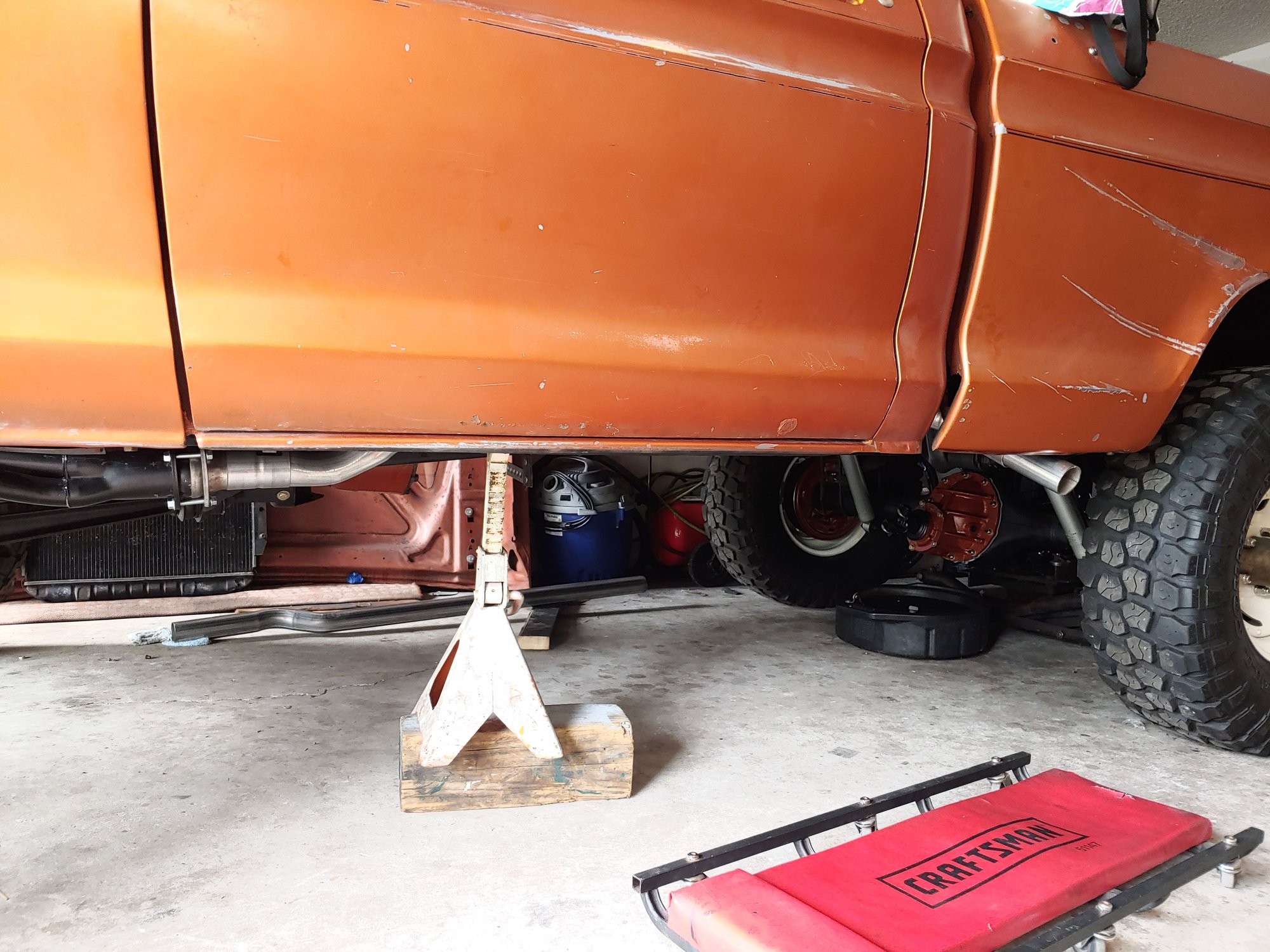

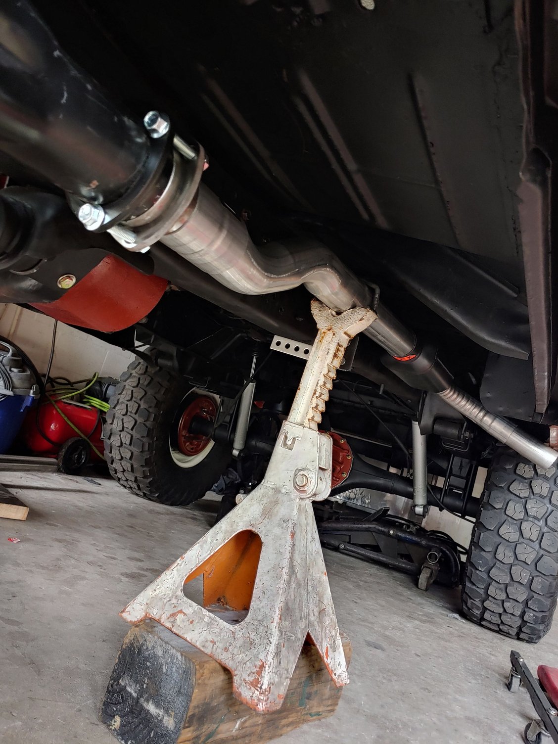

I had a video of it running but i cant find it. I realy likevthis sound. Throaty but not to noise and sounds different than most everything else on the rd. This is 2.5" in 3" out. Dumps over the rear axle. I couldn't find a way thatvi liked to run the exhaust all thecway.

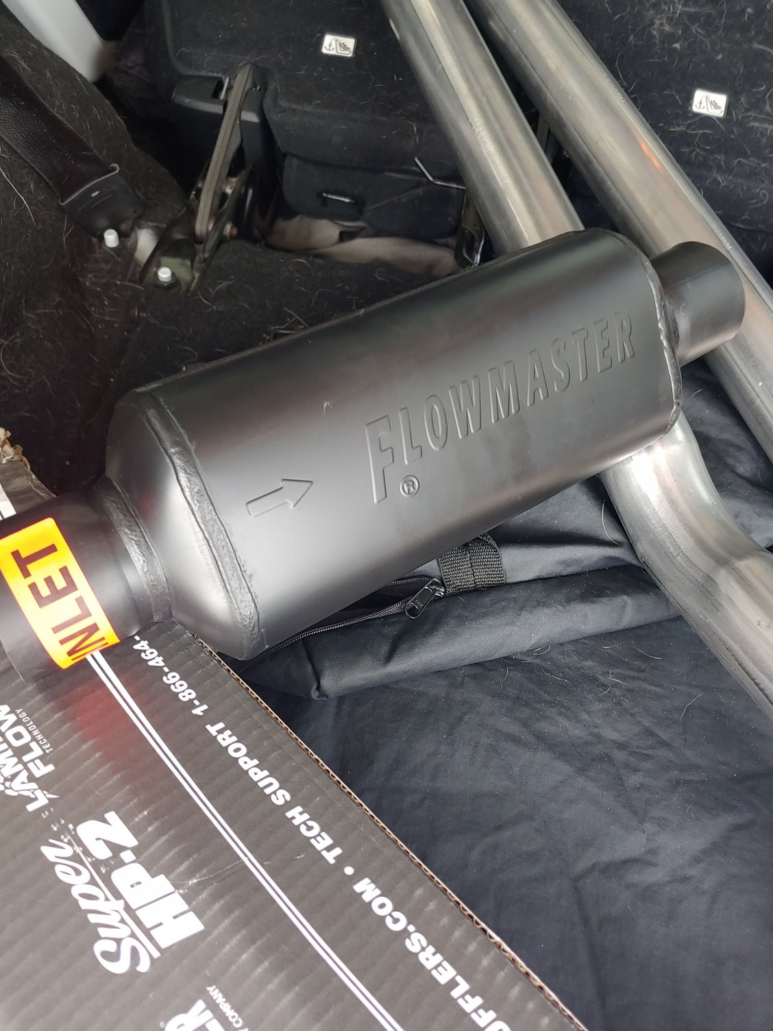

I just picked up 2 of these not sure how loud they will be installing today
flowmaster hushpower pro series 2. They are not cheap vs other mufflers but are suppose to have a nice non raspy not crazy loud type tone. 2 cones inside for baffles.
if their too much I'll add a resonator in front of them.
