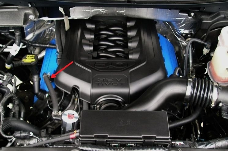

Arrow
Bronc1... where is the PCV valve?
Front, RH (passenger) side of the valve cover.
