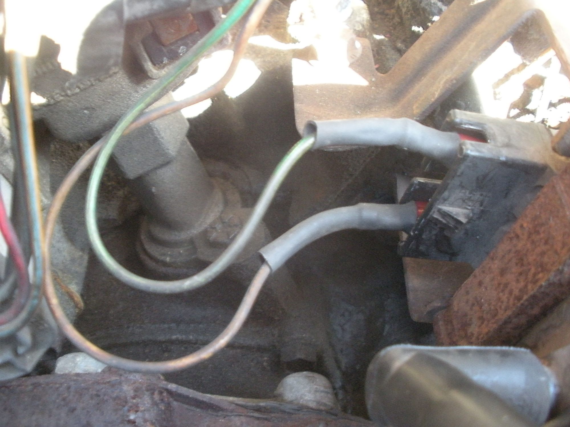

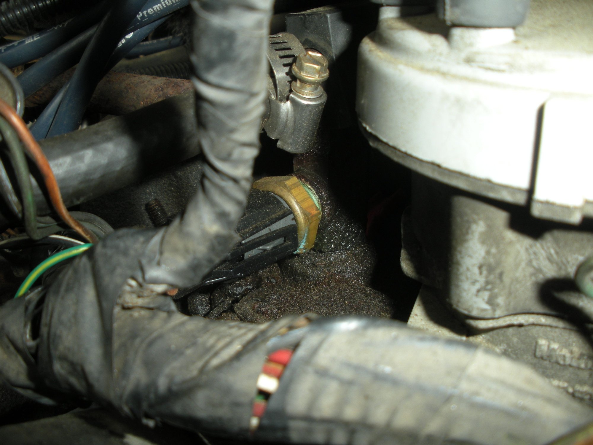

FWIW, A few years back my water temp gauge would peg from time to time and then return to normal.
I replaced the sending unit and the connector with parts from NAPA. The old ones had corroded terminals.
The problem was still there from time to time.
Then, one day I figured I'd check the coil wire connector, I found some corrosion there. After cleaning that, the water temp gauge has worked great.

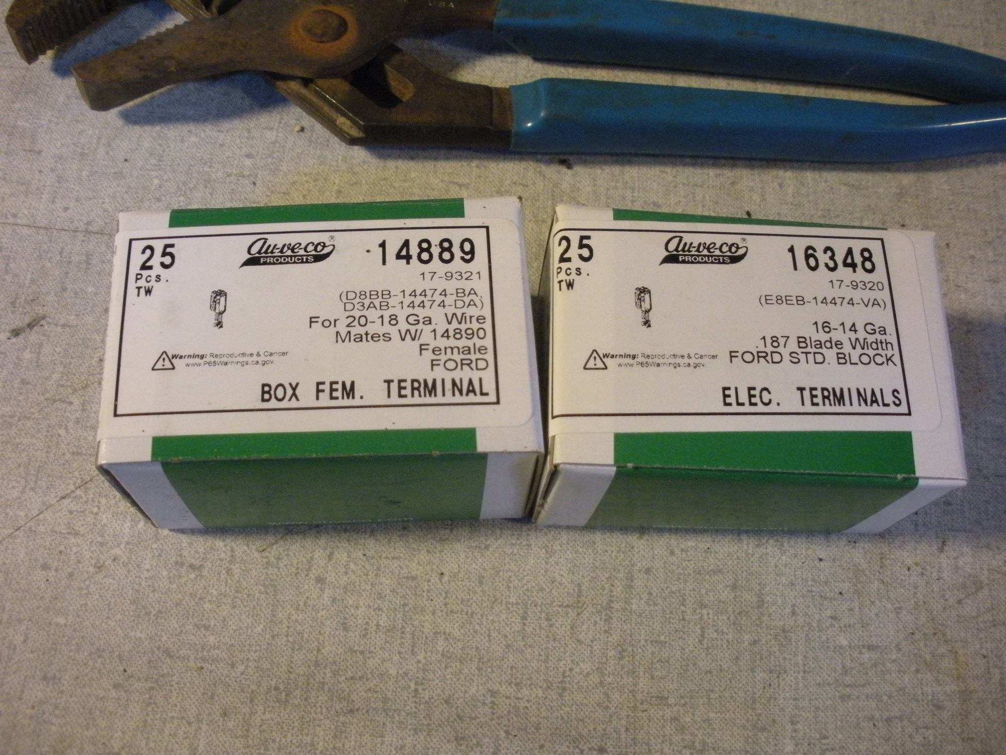

I have since replaced the terminals at the coil connector.
Matthew told me I should get these to replace with OEM terminals.
I'm not electrical, so I have no idea why the coil wire would affect the water temp gauge.
