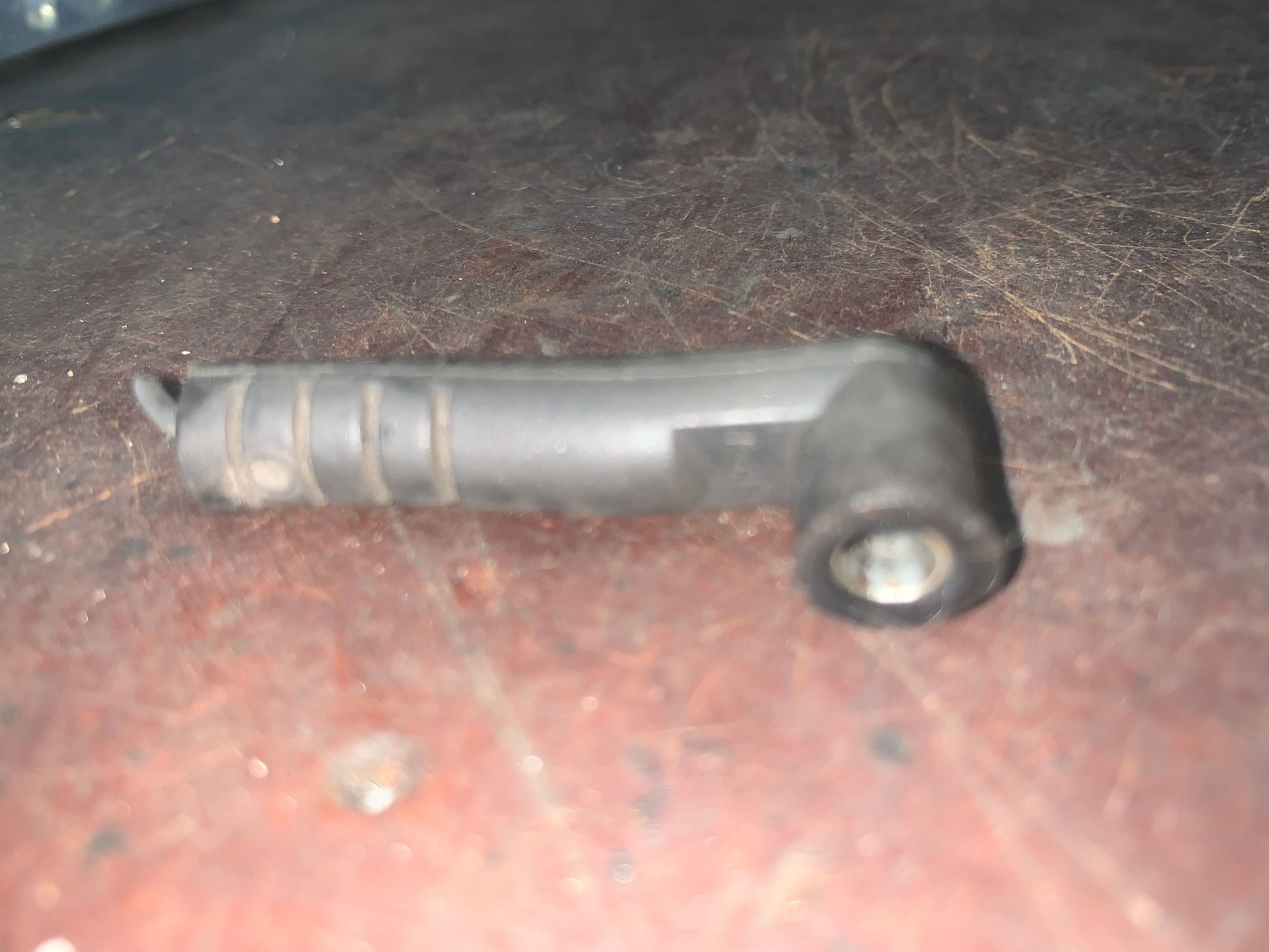

Another simple thing to look at is the signal wire going from the ignition key to the starter relay on the fender. It uses a crappy push-on connector.
I had symptoms similar to yours where turning the key resulted in absolutely nothing. Electrical stuff all worked fine but not a click from the relay or anything. I eventually replaced the push-on connector with a proper ring terminal and fastened it to the starter relay with a nut.
