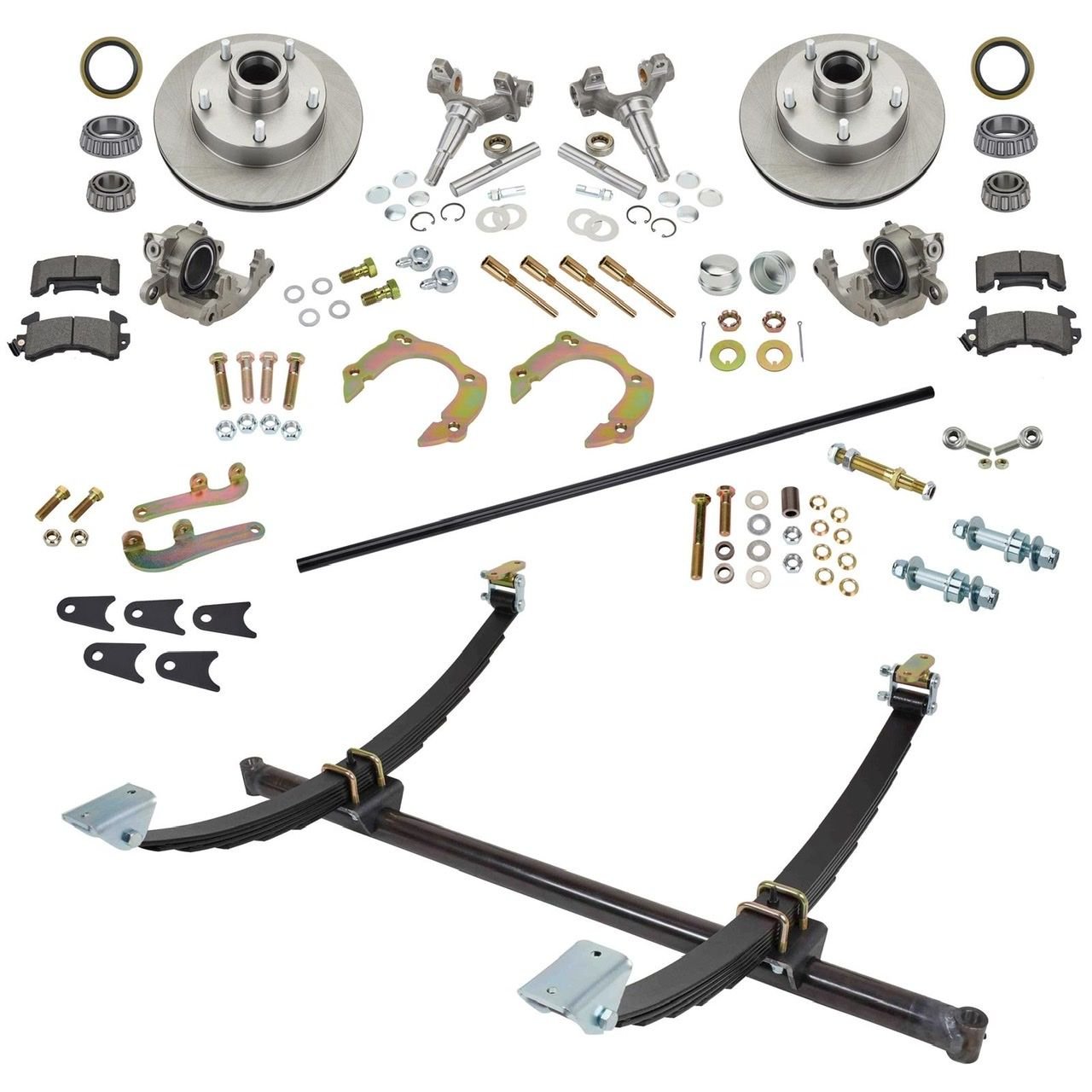

Lifting the a 2wd truck seems a bit odd but to each there own. The easiest way I could think of is new solid front axle that doesn’t drop the front end. Kinda like a gasser. A 64 should already have a solid axle up front so it should be a easy swap. You say you don’t need to modernize the front end so that should be an easy almost bolt of deal.
You can get one from Speedway for $1,200 and it will give you disc brakes.
Just a thought.
