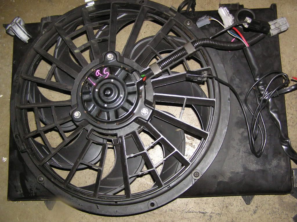

I'm happy you had a great experience with your rad/fan set-up. However, I'm curious. I could be wrong, but the fan in the photo doesn't look like a Taurus fan. Taurus fans don't bolt to the shroud as yours does.
Attachment 279713
Is it a Volvo fan, like the one below that can be unbolted from its shroud?
Attachment 277825
You are correct, I originally used a Spal fan that was so loud it was embarrassing. I purchased the Taurus fan, cut it out of its shroud and put it the shroud in the photo that I fabricated. Much much quieter and moves a ton of air. It will be 115 degrees today and I have no concerns of overheating.
I mention it in my build thread but couldn't find a photo. Snapped this pic this morning. Best $110 that I spent on my truck hands down.
