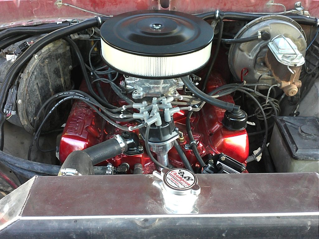

I used the Champion cc545 radiator for my 78 Bronco when I swapped in a 460. Fits perfectly and a factory 460 shroud bolted right up with no modification.
It's a 3-row radiator and I use a 192* thermostat and a factory clutch fan. Temp usually sits around 190ish and will only hit 196 after a looooot of idling like when crawling around off-road. I'll most likely use the same radiator whenever I do the engine swap on my 77 f100.
I do agree that the cap isn't that great. I had to bend the little tabs on it to get it to seal tightly, otherwise it would leak once the system was pressurized.
Attachment 279776
Attachment 279777

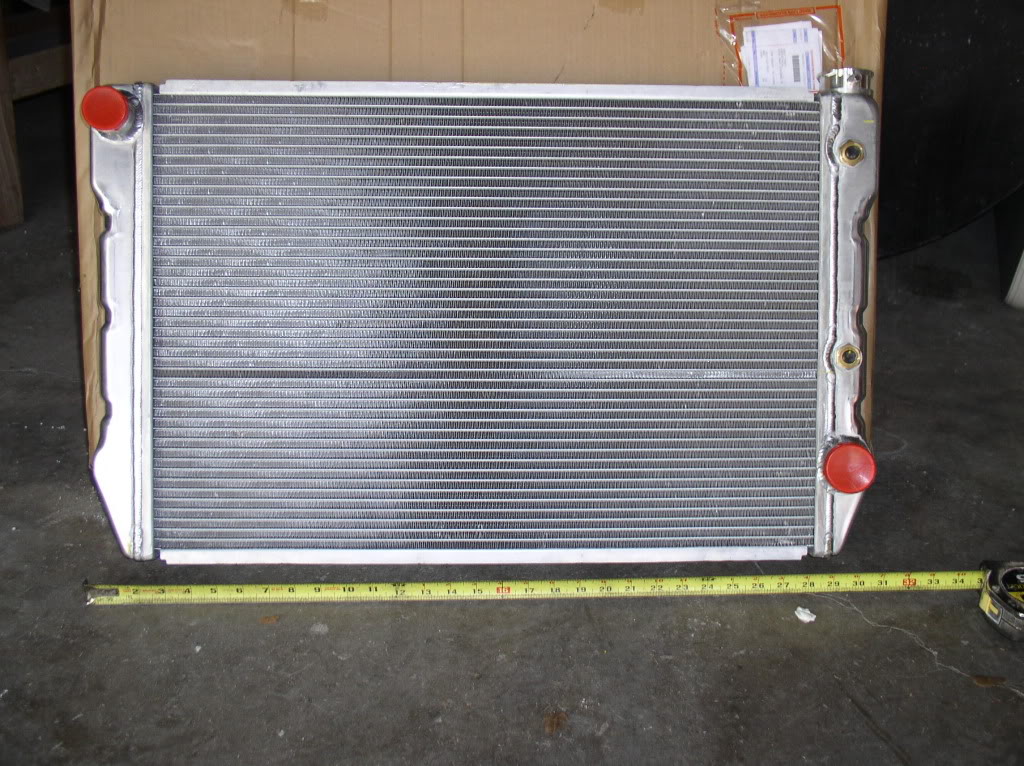

Thanks for the link to the other thread. That makes me curious if vibration is the problem with the aluminum radiators. I had the same issue mentioned in that thread, the leaking where the tubes meet the tank. I can see using a pad on the perch for cross flow radiators, but the downflow models are bolted to the body cross member.
At first, with the first cross flow, I thought the weight of the efan might have caused the leaks. But with the second cross-flow, I mounted the fan to the body, and it lasted the same length of time as the first cross-flow.
This is a two row, 1" tubes, and the size of the radiator provides nearly 1,000 sq. inches of tube exposed to cooling air. It works well.
Below is the old rad. from Summit.
Attachment 279632
Below is the new made in China Chop stix Champion rad:

Well, I'm a bit perplexed. I like the radiator, but it takes the fans a long time to turn off. It takes the fans quite a while to cool the engine. With the cross flow, which was 2" taller, the temp would drop right away, and the fans turned off within 2 minutes. Same thermostat, same switch and fans. I can't help but wonder if the cross-flow is a better, more efficient design? Or, did the extra capacity of a 2" taller core make that much of difference? I also notice that driving down the road the fans come on. That never happened before. The cross-flow cooled exceptionally well with just the air flow caused by driving.

Thanks for the link. I bought mine through Jegs, and, according to your article, it is an authentic Champion radiator. I only posted the tread to mention that a slightly larger cross-flow with 988 sq. inches of tube core (Champion has 884 sq. inches and is a down-flow) cooled far better than the new champion, even though there is only a 100 sq. inch of tube difference.
