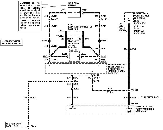

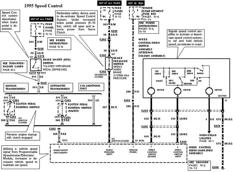

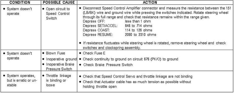

On a 1995 150 with a m5od 4x4, is there a speed sensor on the transmission? I replaced the rear sensor and the speedo and cruise still arent working, but the abs light is out. My trans and tcase were swapped by the PO, and I have an extra plug. Plus on parts website they list a second speed sensor with a gear one it.

No, just the one on the rear end.
