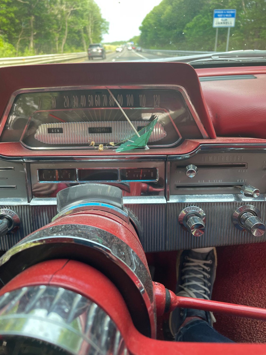

Hello, I recently had a new thermostat installed on my 1960 Mercury Monterey with a 460 from a 70s~ F250. I’ve noticed that the temp gauge on the dash is reading at a higher temperature than before I had the thermostat installed.
For the sake of my curiosity I purchased one of those infrared temp guns to try and figure out the exact temp of the engine.
When warm the engine itself reads anywhere between 190-220 degrees while the radiator shows 170-185 at the top hose and 150-165 on the bottom hose.
I’m thinking the old thermostat wasn’t working right and led to the gauge not functioning correctly.
It’s running well enough it’s just the gauge is throwing me off. I’m having a new electric fan installed for the radiator on Monday to combat any overheating issues. Thanks

170-185°F at the upper rad hose into the rad is perfectly normal. You have to remember that vehicles of that era (and yours) were pretty much universally running 160° stats so the temp gauge in your car is going to read high with the 460 running its correct temp stat.
You are just fine and it looks like the engine is now running at the correct temp. You are just going to have to get used to temp gauge reading over the mid-point.
You do not need an additional elec rad fan...
